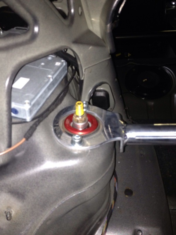

            Not mine but a picture I found when I was looking at the part number which confirmed it was the right number.
            Would you reckon these reinforcements are needed when a rear strutbrace is needed (as pictured on my car).
            Current setup is Intrax uni-ball topmounts + Wiechers strutbrace + Intrax 1K2. I would think the strutbrace mounting supports the top-mount as well?
              #66
              The picture I posted is for the front strut reinforcement, your rear set up looks like it does the same job as the oem reinforcement kit.
              I would fit the fronts if you haven't done so.
