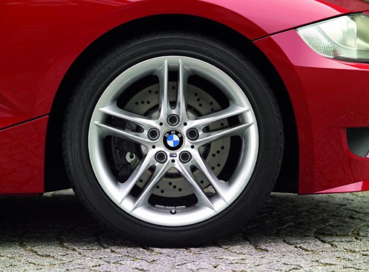

              This is the OEM style 224 wheel that is stock on the Z4M (not my car, just a useful link)
              They are 8x18" ET 42 front and 9x18" ET 30 rear. I run these on the track and CSL wheels on the road.

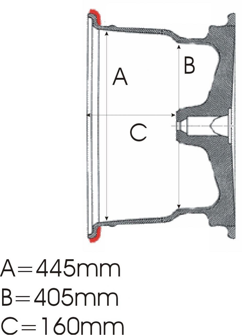

                I've measured the internal diameter of the wheels - they measure 405mm at the mating face and 445mm at the inner rim. The distance between these two points is 160mm.
                Lawsy, with the Alcon kit, what is the distance from the centre of the disc to the largest part of the calliper please (I appreciate you may not have that information :-D )?
