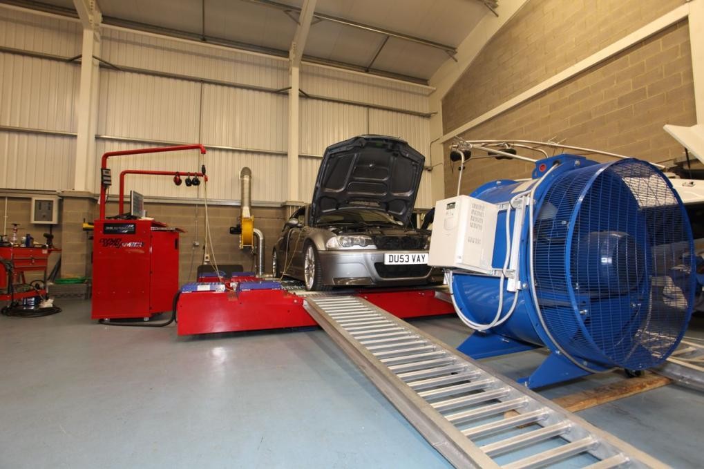

                            I'm sure you can filter through the sales mode here but genuinely this is the best power modification I've done for the CSL. The story is this, I tested a couple of RHD cars that came over here for remaps (usual full exhaust, stock headers) and all same as LHD ones we've done. Then about a year later the same customer came back (he 's from France) with the SS header and wanted the car looked over again. I ran it on the dyno (same map) and it had gained 12bhp over last time so was curious. I kept the car for a week and wrote a few maps for it with the net result that we gained 18bhp over and above the stage 2 car (full exhaust) it had on it.
                            I rang Milltek, asked that I wanted to develop a RHD manifold but as the cost of developing manifolds is so high and everyone else who looked at it said that it wasn't possible due to the RHD car steering column being smack in the way. So I called SS (who make the RHD version) and said if they were prepared to work with us in the design and give us WW exclusivity then we would drive a car down to Italy and work with them.
                            The following month I drove my CSL to SS in Italy (via Spa, hehe) and we sat down to design the RHD version.
                            The initial investigation was right, the steering column is smack in the way so simply using a LHD version was out (unsurprisingly) so we took the decision to extend the primaries to give the engien more torque lower down the rev range. With the stage 3 cars (cams) all the power is at the top end and I wanted to get torque lower in the range to 'fill in' this power band rather than extend it further. My car already had cams fitted.
                            Fast forwarded about 2 months and multiple plane trips to SS and we agreed the final design and made the first 5 up. These went stright on our CSL Cup cars (we couldnt use them on some as they were standard class) and the ffect was dramatic. An immediate 10-12bhp gain with the stage 2 map and 8-10bhp on a standard car with standard map. We then spent a few weeks devloping new mapping with the same peak result as the French car - 18-20bhp but importantly an extra 18-20lb or torque between 4000-5600rpm, not surprising seeing as we'd extended the primaries by over 48mm. The tapered design maxmises airflow from the block to the extent that unmapped the car takes a few second for the o2 sensors to adjust fueling (only a few seconds, the BMW ECU is pretty good) so even unmapped the gains are immedaite and clear. Once to map the fuling to take into account the extra airflow it is pretty dramatic.
                            Have a look at the Snetterton video between me and Nick Foster. Both these cars have identical cams, engines and aero. The only difference between them is that Nicks car had KW suspension and standard manifold and mine had Motons and the SS/TMS manifold. Its clear from the video that my car with the Motons get the power down better from all the corners compared to the KW shod car but have a look down the back straight, I pull another 2/3 car lenghts towards the end.
                            As regards Shimmys comment on cams, well fitting cams is a shed load more than the mainfold. For a start the only cams really worth fitting are the 285/280 ones (we've tried all the others and these are the best by a country mile) but to fit those you need to fit uprated rockers and retainers so the cost is nearly 3 times the manifold. This is why we've swapped our stages round, stage 3 used to be the cams now its the manifold which lets face it is a benign upgrade (ie its releasing power not making it work harder as with cams) and when you come to sell the car sell the manifold sepaerately.
