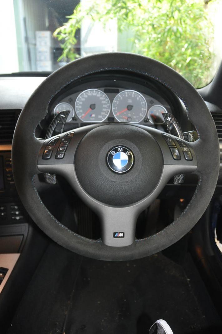

                        Here is my wheel snack from Jack at Royal Steering Wheels. very good job IMHO.
                        I'll swap the paddles back for better condition OeM ones I think. I've coped this long so I'm sure I can continue to make do with them.

                              Geez, nice work on the re-wrap of the wheel, it looks perfect!
