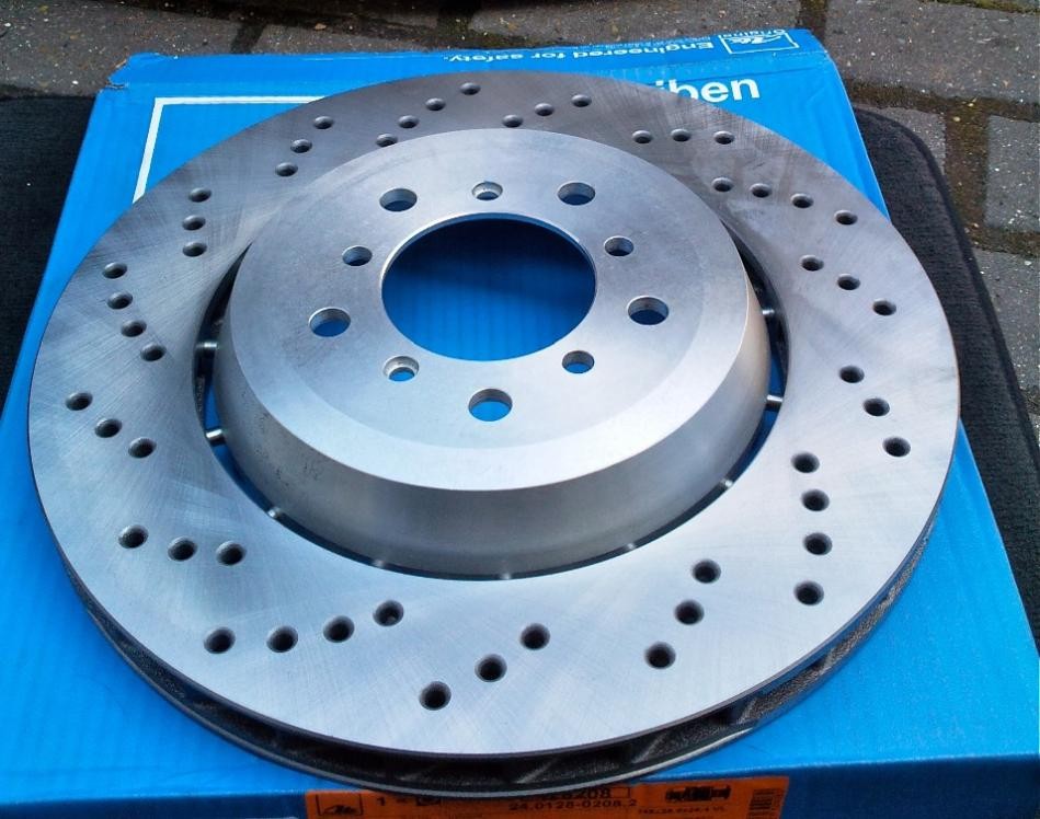

it is how you deal with the heat that is created that ensures a fade free confidence inspiring performance from your brakes.
The AP kit is the sum of its parts - IMO ( I am no expert in anything apart from girls boobs tbh:notworthy
bigger discs - bigger thermal mass - (maintaining an operating temp is also vital for safe and prolonged life) centrifugal effect vanes to expel air through the disc
thicker pads to insulate pistons from the working surface ( there is a reason why race pads are 32mm thick { and teams discard them when they are less than half worn})
aluminium caliper for better dispersion of heat
higher rated fluid to withstand prolonged temps.
Everytime I ring questmead asking what the latest and best pad is they keep asking - "got any cooling yet jim...":smt102
