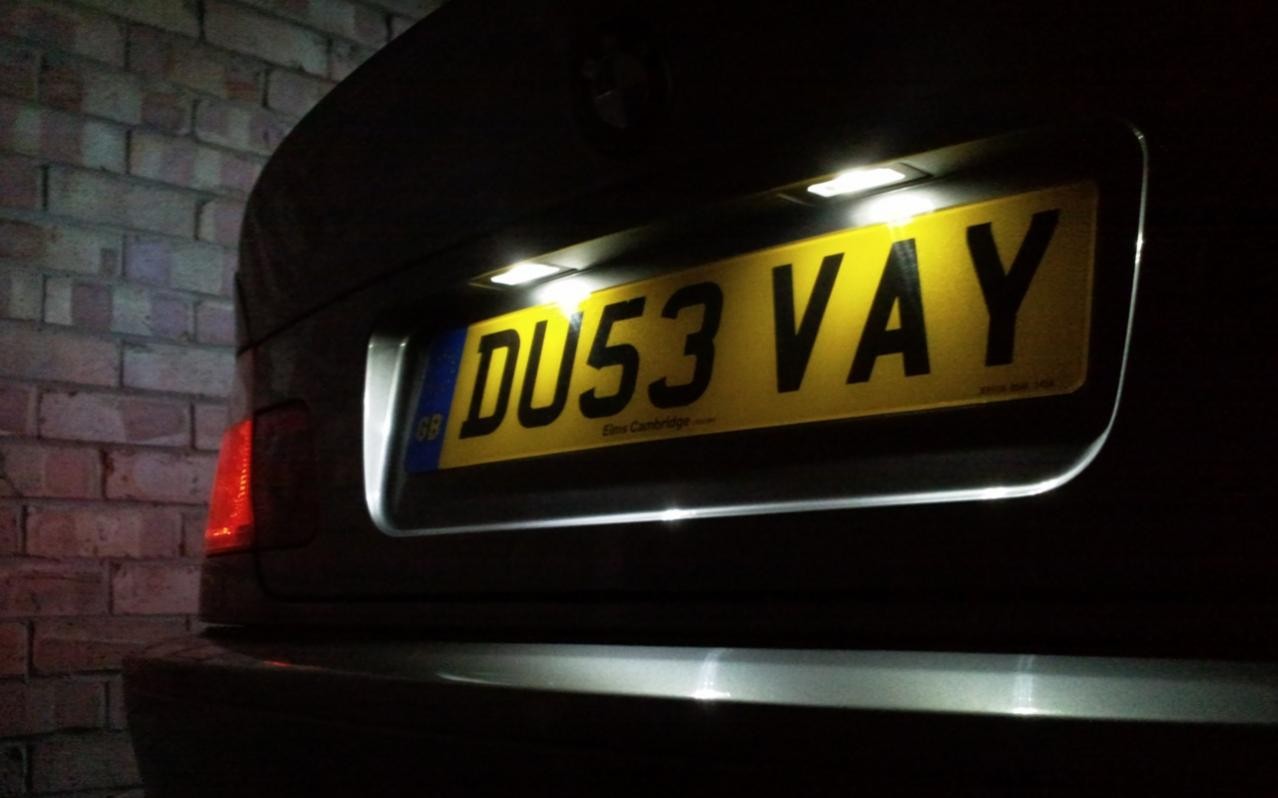

        Did mine today using OEM parts... all for a reasonable price of £20 :thumbs:THANX to Mark CSL for making this an easy conversion :beer:
        One word or caution though, the E90 LED light units have a thicker then the E46 weather seal which makes it near impossible :banghead: to clip the NEW light units into the plastic CSL boot lid cut outs. In the end I had to use a surgical blade to reduce the thickness of the weather seal by half, before it would fit... just.
