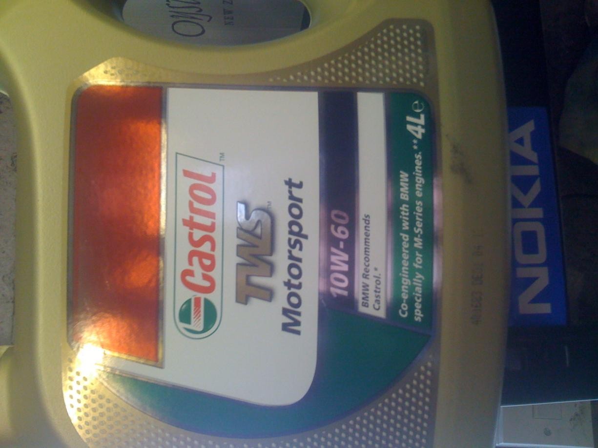

      Here's what BMW supplied me with last week - even came with a gay pouch:

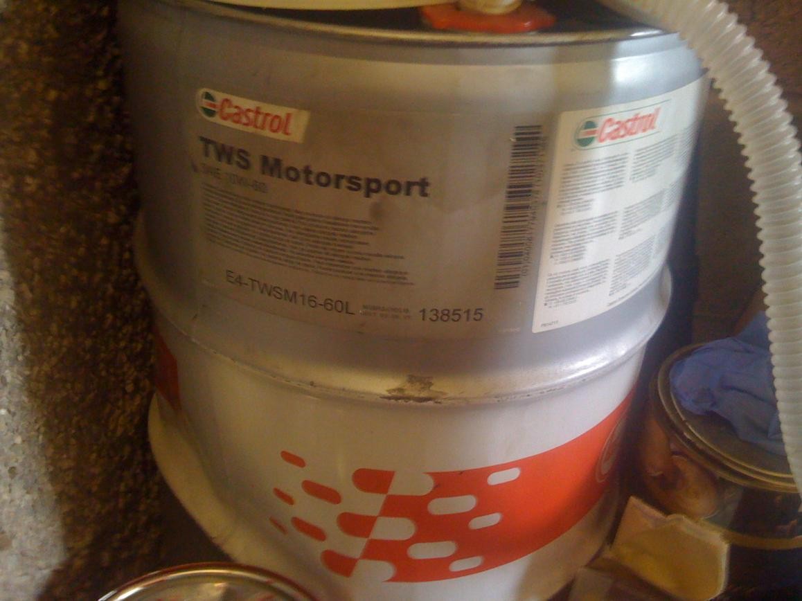

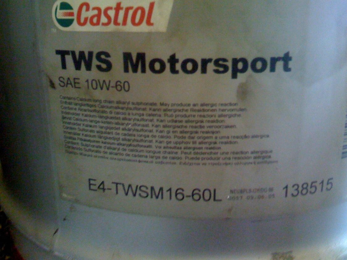

        Here is the OIL I USE the same as i buy from BMW
        TWS i have it in cans and 60L Drum:thumbs:
          [QUOTE=glendog74;n507831]Here's what BMW supplied me with last week - even came with a gay pouch:
          :thumbs:
            I think they may well be the same... :hahaha: :hahaha:
              i have two part litre bottles from BMW services and they happen to be the gold and the silver 10W-60 as above so they are the same (of course the colour of the bottle is different)
