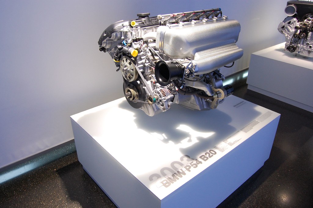

                              Hi,
                              Talking of CSL engines here is the
                              BMW 6 Pot that actually will
                              make over 400 BHP NA.
                              Edit- my mistake, this is P54 B20 which is
                              about 320 BHP from MS.
                              And if that seems a bit tame then you could
                              fit one of these.
                              Personally I would go for this in either a CSL or E30 M3. Sublime.
                              Regards,
                              The Gorilla.
