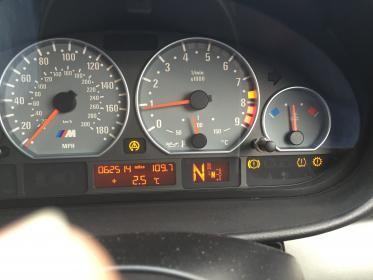

    Had 4 warning lights come on while driving yesterday, I can't do anything with the traction control button. Any ideas please before it goes to BMW?
    Thats a wheel sensor, you have no abs. I wouldn't bother taking that to BMW.
      Where are you based?
        As Billy says
          Is the TPMS and Gearbox warning on too? Why would that be?
            When I had the same issue, there wasn't even a problem. For some reason the ECU just decided to stop communicating with one of the front sensors. Typically it happened on the way to the 'ring :banghead: . Fortunately one of Toughy's friends had his laptop with BMW software and lead with him and plugged it into the OBD port and just told the ECU to start communicating with the sensor again. This was over 2 years ago and the error has not come back since. Fingers crossed it is just as easy for you .

                        I would get the errors read and deleted with INPA. Then drive a bit, if they return, read again and check whats wrong. Most likely the wheel speed sensor is the culprit.
                          What is the score with these sensors? Are they just off the shelf items from BMW ie pick a new one up and replace it? I take it once replaced it the errors will need deleting to get rid of the lights.

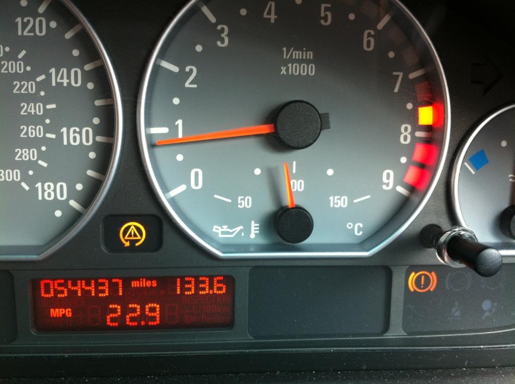

                          I got the DSC and yellow brakes (- ?) icon come up on mine today.
                          Presumably they are just caused by dirty contacts rather than failure. Are they are DiY fix for tinkerers or just for 'experts'?

                            As it turned out the issue with mine was not the speed sensor but a wheel alignment sensor. Elms reset it and all is good again.
                              Could be a number of reasons, something you can do yourself is disconnect and reconnect the pressure sensors on the brake master cylinder. There are 2 of them, a little bit fiddly. Other than that you'll need to get the faults read I'm afraid.
