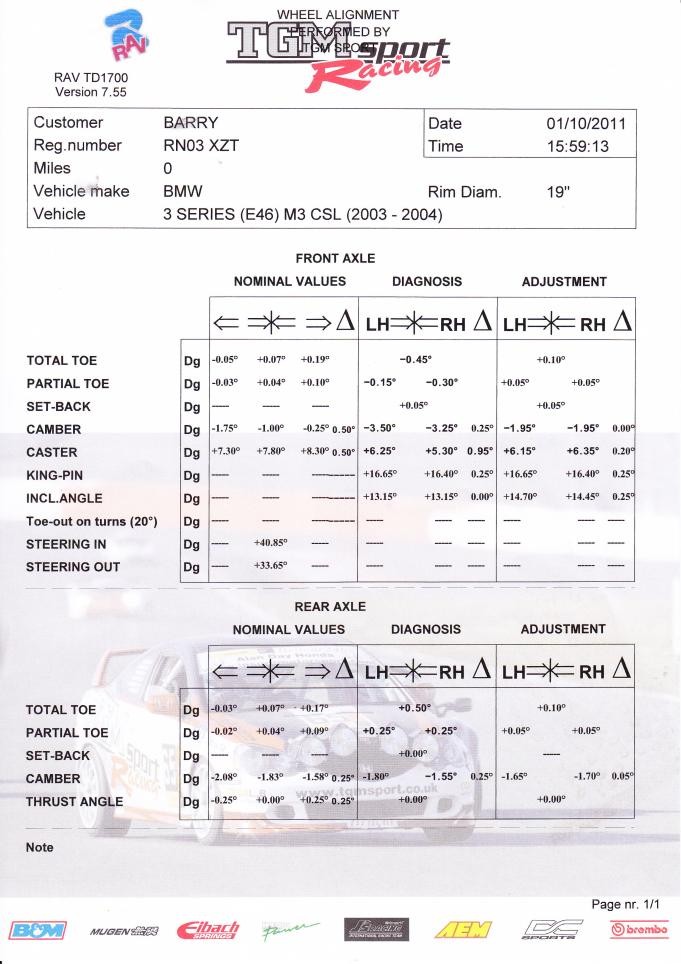

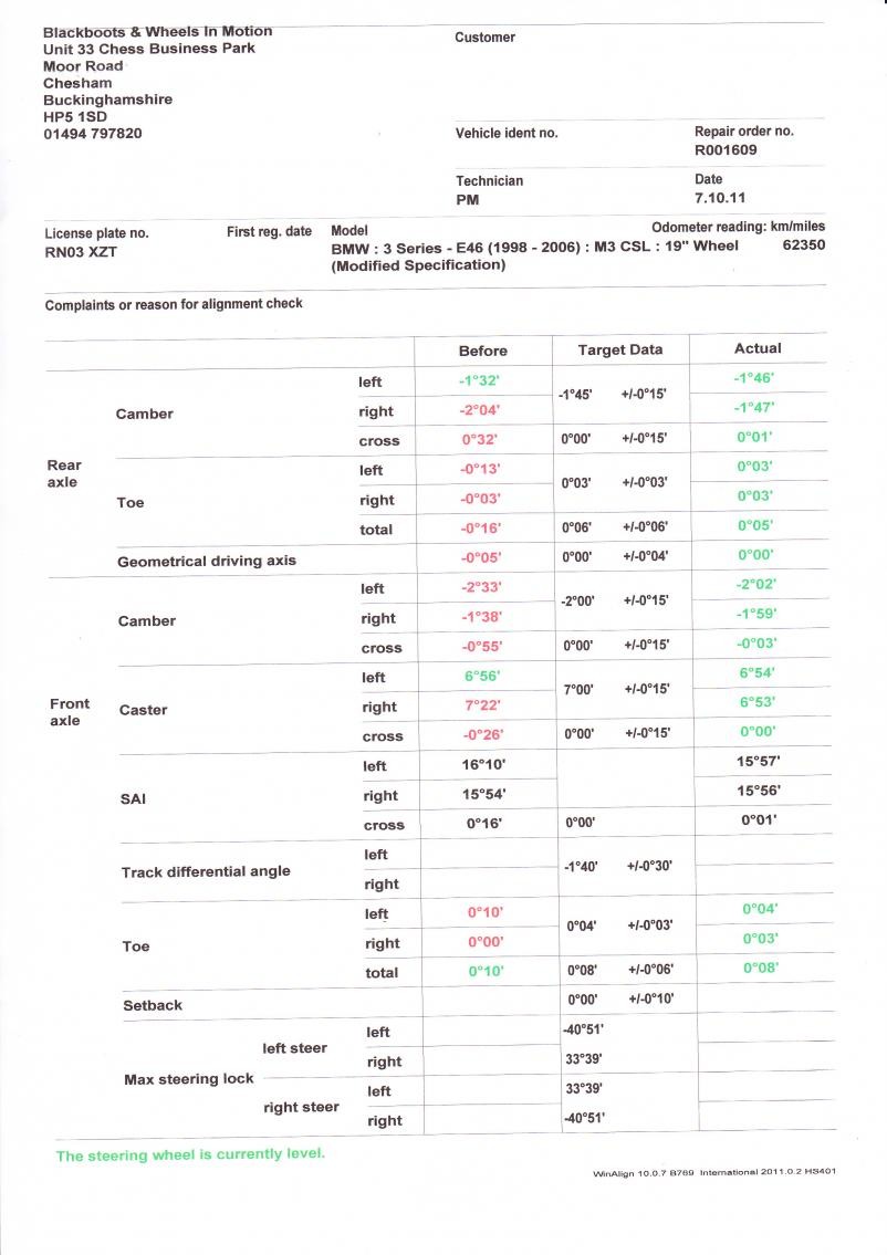

                                What I've learnt - When putting new suspension on, let it settle before doing a track day, otherwise the geo will look like this.
                                First image when fitted, looks good. Second image done today.
                                Pax with Shimmy, his car felt so stable through Eau Rouge mainly due to the driver and set up, mine didn't seem to dig in like Shimmy's, but didn't feel too bad. Looking at today's before settings I can see why, 2mm toe out on the left rear and camber's all over the place. That's my excuse for being so slow :hahaha: not too bad, still under 3 mins with passenger and a bit of traffic, should go better next year :thumbs:
