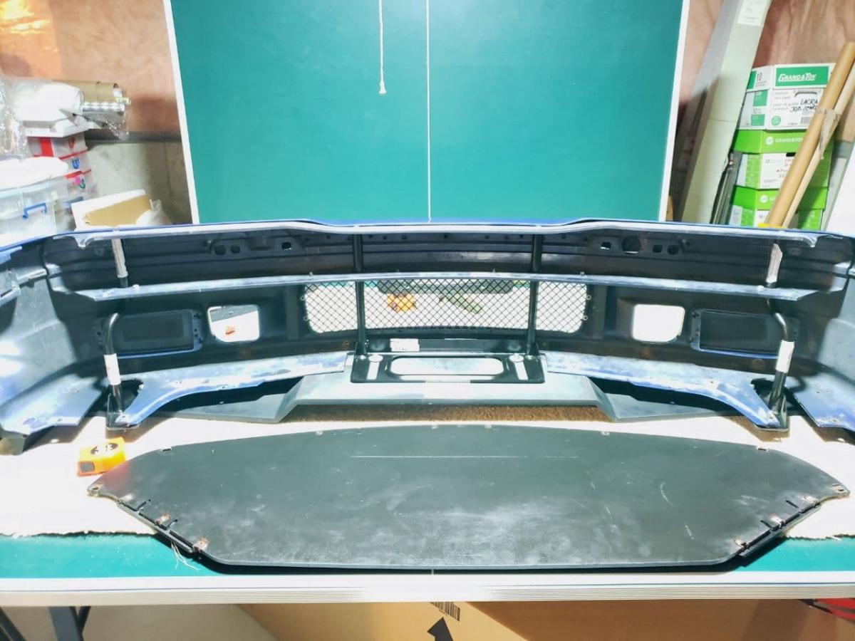

          Also need to cut reliefs for the supports in the bumper, ill look for pics and post up
          All the shields and ducting fitted as per pic
                      Sent from my SM-G930F using Tapatalk

                        Originally posted by Lavatoad View Post
                        What undertray is covering the x-brace and surrounding area? Is it oem?
                        I've been trying to find a part number, but can't find it in any diagrams on realoem.
                        Found the part numbers.
                        51712491567
                        51712489775
                        Look to only be available in Europe, expecially the larger cover. Would love to get a setin the US for track purposes.
                        Yeah my original oem one, theres 3 pieces; large centre part, rhs is an aluminium shield that goes over the rear lollipop and lhs is a plastic version
                        Was considering making a crp version as its very specific and quite different from pre mid 95 and post mid 96 versions. In process of building shed etc so its a while off

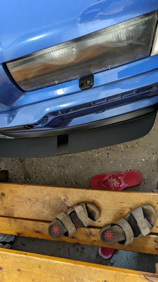

                          Kthree
                          I did it.
ID:	150876 Click image for larger version

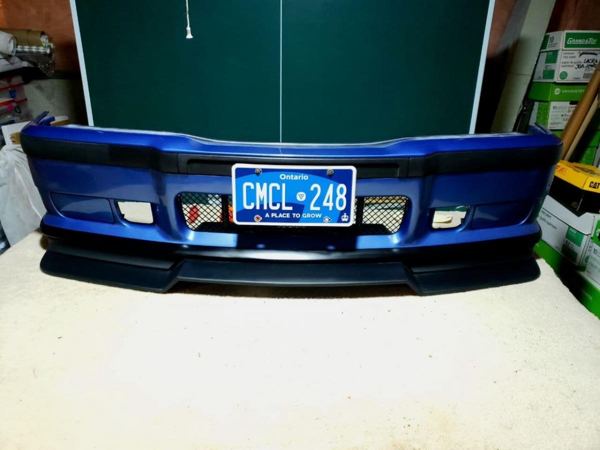

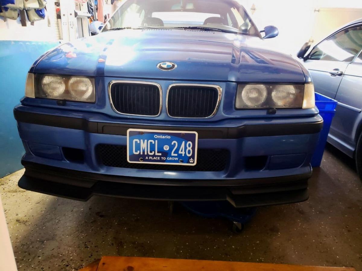

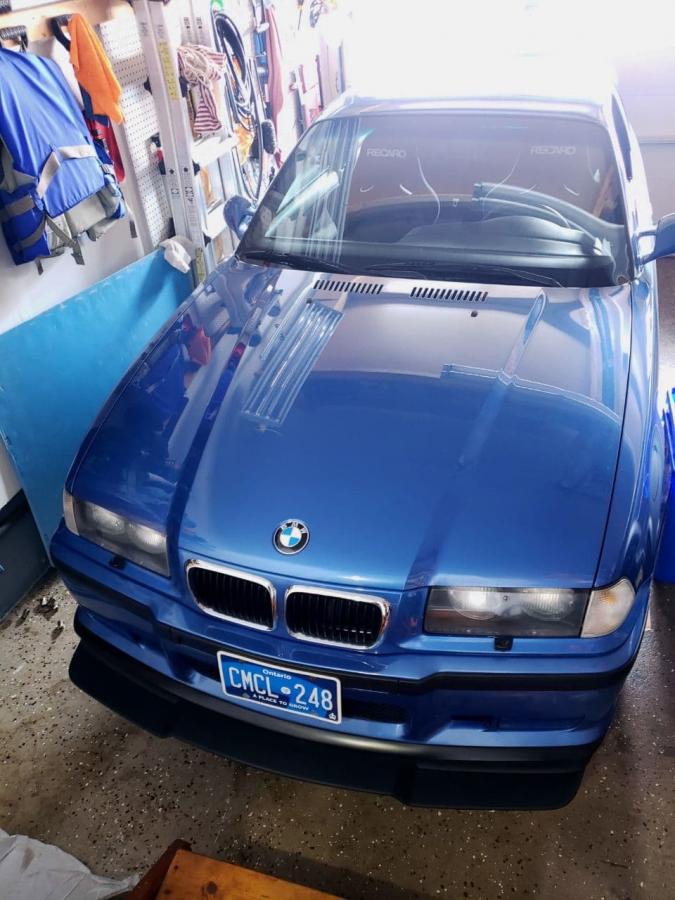

                              More pictures on the car
ID:	151173 Click image for larger version
