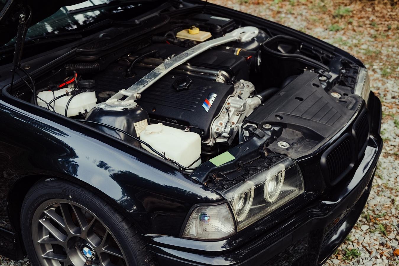

    Hi All,
    I just bought this 97 m3 with an S54
    Details:
    S54 Swap using second gen can interface from gpeterson
    PO did rod bearings with WPC treated OEM and new rod bolts, vanos rebuilt, and valve lash checked
    Getrag 420g out of a euro s50b32 car
    3.64 LSD
    PO did all bushings, ball joints, bearings, tie rods, etc.
    Yellow tag ZHP rack
    Stock brakes with brass guide pin bushings
    Reinforced Rtab pockets, engine mounts, and rear swaybar mounts
    Koni Yellows with GC kit and top adjust rears
    rear trailing arms and subframes powder coated
    17x8.5 arc-8 wheels
    Ebay headers
    dual 2.5" exhaust with 200 cell metal core cats
    x pipe into vibrant resonators and a stromung muffler
    CSF radiator, spal fan

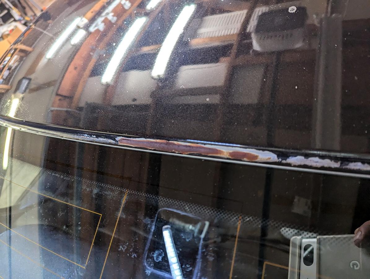

    *paint in the inside of the rear hatch trim has failed and surface rust is forming. Need to decide how I'm going to handle that. Maybe por-15 after sanding it clean.
Name:

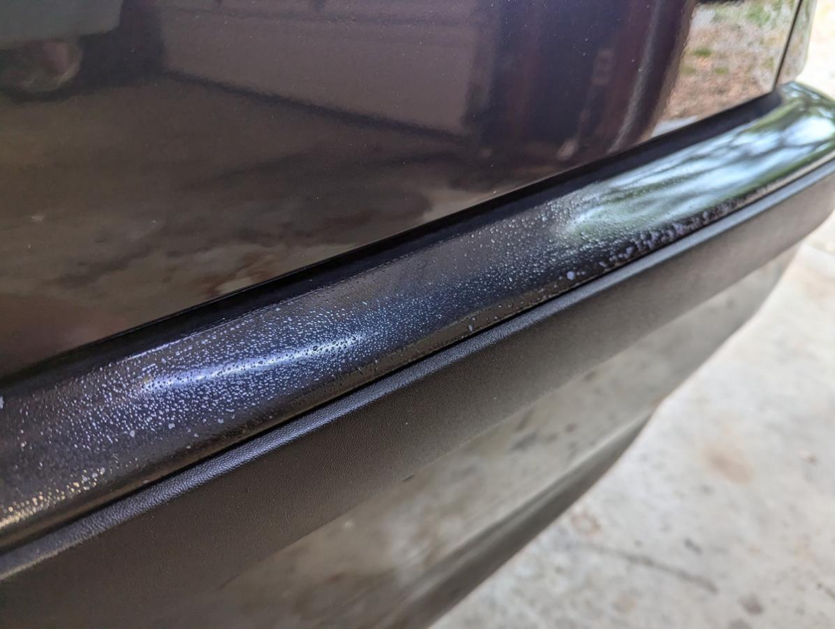

    *Rear bumper paint is especially bad. A few other parts need repaint (mirrors and front bumper especially) but i am debating just having most or all of the car painted.

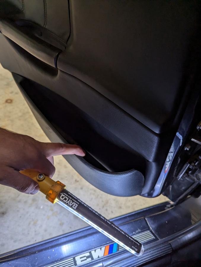

    *Rear door pockets are separating from the door cards.

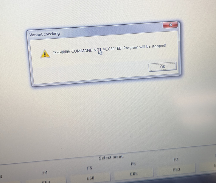

          I got INPA set up yesterday and started pulling codes. So far I can't connect to the cluster and I get this error:
          After that inpa quits back to the main menu. Previous owner said he couldn't get inpa to connect to the cluster either (or the original cluster in the car). Again, this a gpeterson can interface swap so it's wired differently than most of the can cluster swaps people are running. I'm guessing its a wiring thing? The cluster is a euro S50b32 cluster. I want to fix the mileage on it and remove the tamper dot. Is that an eprom flash fix or something that could be done through software and a dcan cable?
          Also I got a handful of codes from the engine and the one I can't understand what to do with is:
          141 Fuellstandsplausibilisierung
          Only one dead german page as a google result. Google translate says "Level plausibility check"
          Since the e36 has no oil level warning light and I know the oil was low, I'm wondering if its a code related to low oil.
            More research and it looks like I need to get a chip burner to write to eprom to do the cluster changes.

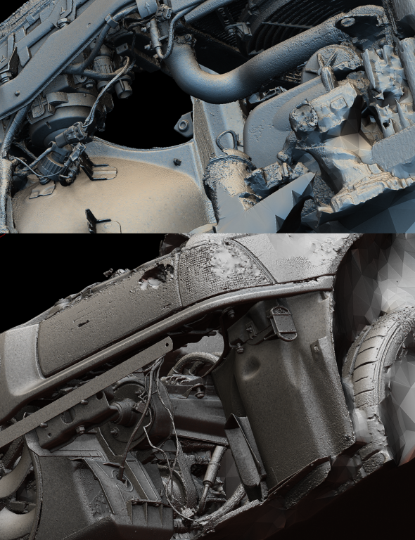

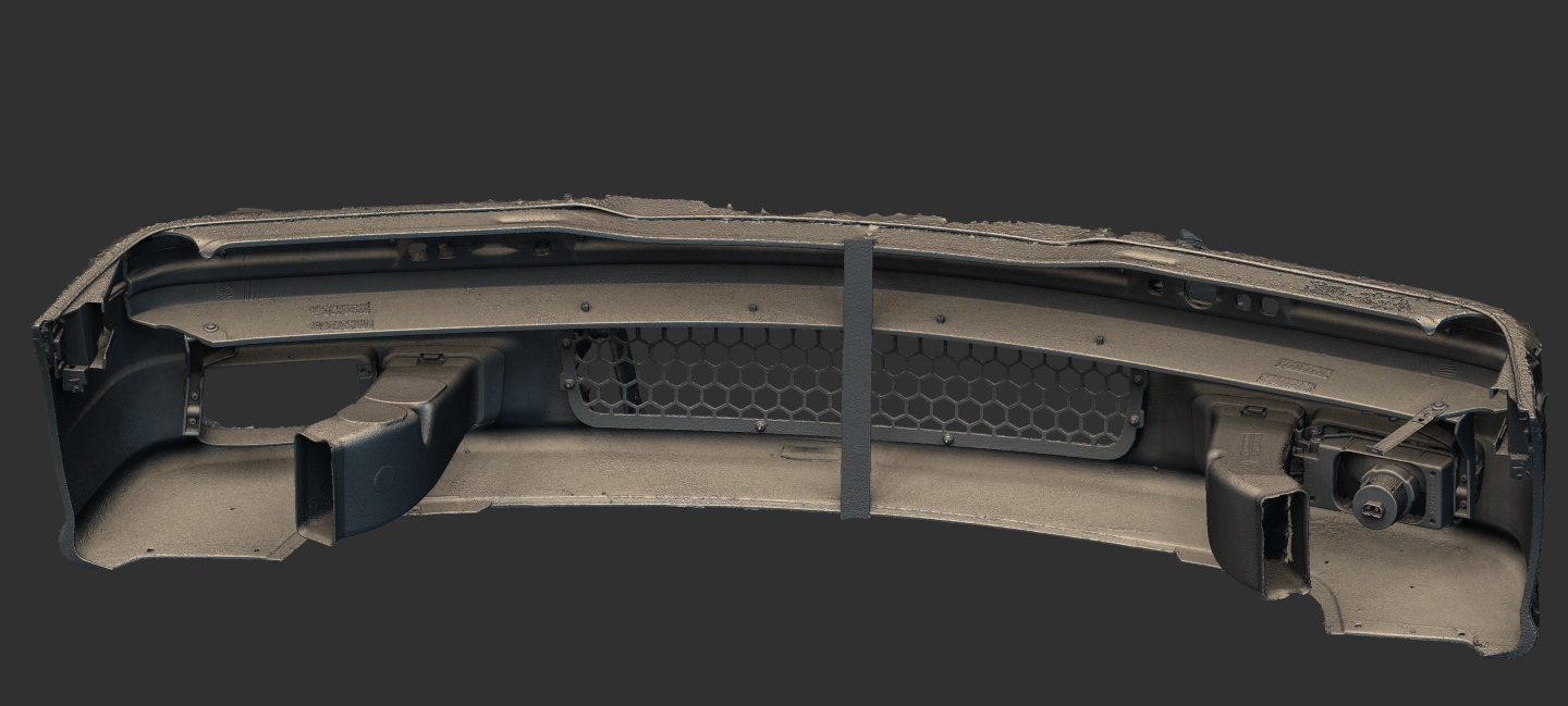

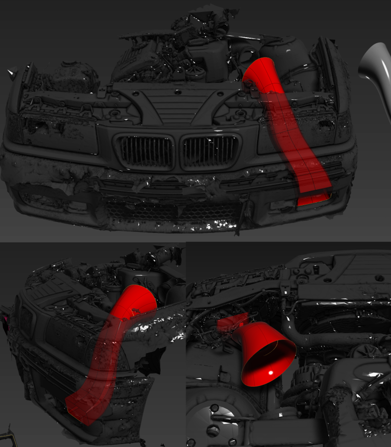

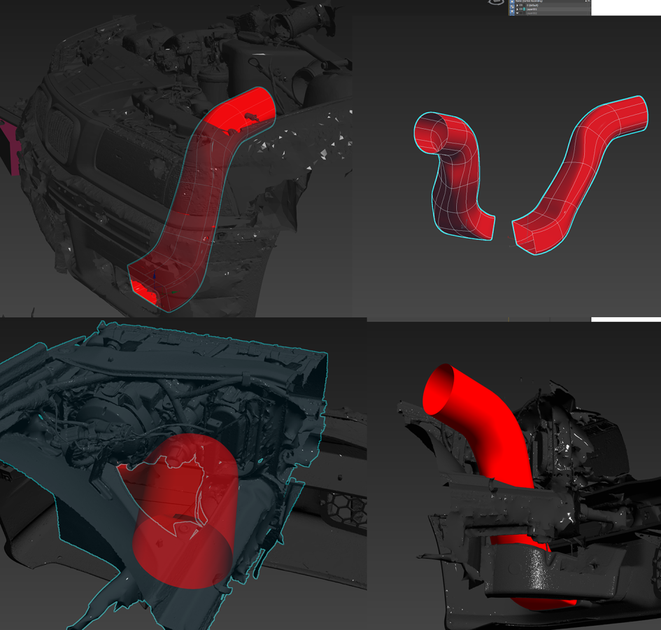

                    I'm wanting to do a carbon airbox in the future but I don't want to pull in any engine bay air so I started scanning the car to design duct from the fog light opening. Quick measure on the fog light opening says I have about 14500mm/2 of cross section to pull from and so far exploring the area near the headlights I have a similar amount to pass a duct through into the engine bay. I'm still waiting on my crash structure/engine bay scan to finish processing to measure it. I have done intake design work before and I think I can come up with something that flows really well and will verify with CFD. First iteration would be something like SLS nylon and then I can either sleeve it in carbon or make a multi part mold and pull some carbon parts from that.
                    Past intake project on my miata for those that are curious:
                    This is the updated design from my older cold air intake published elsewhere. Significantly better flow, CFD says it will outflow a typical 90 degree elbow.Included are two files, one with a shell thickness of 1.2mm and another with just a skin that can be shelled to whatever wall thickness is needed. For clearance, do not expand the skin more than .5mm. This design was intended for a thin wall thickness.Engine bay heat soak can causes the part to see very high temps. Enough that PLA is a non starter, and ABS is marginal. My plan was to print these with a 1.2mm nozzle in straight polycarbonate (not one of the more easily printed PC blends)- For printing I was planning to hack together a gcode file from two sperate slice results, with the elbow side at the bottom transitioning into a vase mode print after the bend.To set this part up you will need:Assuming a MAP based aftermarket ECU you will need:A first generation miataGreen Filter 24512.5" silicone elbows (90 and 45 degree)A 2.5" crossover tube, try to find something thin wall. 2mm aluminum tubes have less ID than this duct*IAT sensor best placed into the filter end to keep sensor from heat soaking. Easier to tune hot restartsFor best fit, you may need to adjust the rubber bumpers that control latched hood height. Also, some cars will need clearancing with a few hammer strikes to the interior of the hood structure just above the duct bend. Do not slam your hood with this intake.More info in the very long miataturbo thread:https://www.miataturbo.net/engine-performance-56/3d-printed-intake-n-na-miatas-76193/page28/And in this blog post:http://www.wrenchgame.com/2018/07/12/updated-miata-air-intake-design-now-available/
                    Bimmerworld (and other retailers) sell a German made CSL box that necks down to 120mm
                    120mm is still a huge inlet and from a peak flow restriction perspective I think its a non issue. Having the panel filter inside the airbox is something I'm not sure what to make of. There is a reason you don't normally see plenums with openings this big. 200mm is going to attenuate the pressure waves forming in the plenum but then having that panel filter inside the box, I'm not sure pressure waves are significantly making it past the air filter anyway. I would be very curious to see a/b testing with and without the filter an a smaller opening to see how the torque curve responds.
                    I'm also deciding if instead of that bimmerworld intake I want to make the neck down from 200mm to ~130ish for the duct on my own. I could probably do it smoother and over a longer distance than the bimmerworld part. Either way the first step is to make a general purpose duct I can use for whatever end product. I could even make one that sits flush and feeds a hole I cut into the AFE intake on the car now.
                    Inner bumper surface scan:

                      Finally finished processing the bigger of the two scans:
                        First rough in pass on the duct. It's going to need a lot of iteration and clean up for flow and fit. There is a lot of unnecessary waviness to clean out too. The triangular space under the headlight is pretty constrained but right now it makes a linear taper down from the inlet area at the foglight to the area of a 120mm diameter circle:
                        Click image for larger version  Name:	image.png Views:	0 Size:	524.7 KB ID:	272842

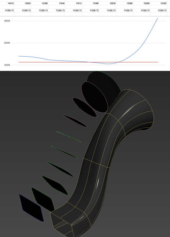

                          Working on getting the cross sectional area dialed in before moving on to CFD. Red line in the graph represents the area of a 120mm circle. It currently transitions to a 200mm circle roughly where a CSL airbox inlet sits. I'll need to get a CSL box and install it, then scan it in the car to get the position where the two parts will need to meet. Also planning to do a test print of the bottom 2/3 that are fit critical before moving forward.

                              I have done a few more design iterations on the ducting. I'm going to make it in 3 pieces that slip fit and tab together. Section 1 is a bell mouth and about an inch of flange for the first main section to fit into. This will be mounted directly to the bumper itself. Section two will run up to sit level with the top of the frame rails. And then section 3 will run to whatever intake use case. This makes the design more flexible and it becomes a general purpose high flow duct for a e36 m3s by changing out the section 3 piece. I plan to run the first two sections just feeding my afe intake until I decide what I'm doing for an air box. It's looking more like I'll do a karbonius CSL box. Also if anyone is local to me (NC) with a CSL box I can scan their installed intake to come up with a section 3 that will fit their car.
                              I also think I'm going to print the intake parts in nylon12 either sls or hp mjf. Getting quotes for both. I eventually want to pull some carbon parts but I'm not attempting to design around easy parting lines/draft angles so a split mold might need to be made from something flexible like silicone.

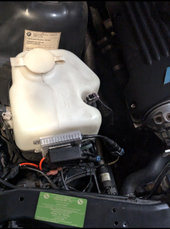

                              I have a lot of little things in the car I have been taking care of. Cluster mileage fixed by JBanzhaf. I replaced a hid ballast with the cheapest next day delivery option on Amazon. For now this is just 3m dual lock mounted where I can move it easily. I don't love having my passenger side ballast in the bumper since it makes bumper removal a pain in the ass. Looking for recommendations for who makes good hid stuff. It would be good to stop tripping the low beam failure error.

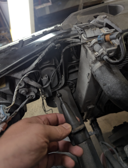

                              My power steering pulley has what looks to me like excessive wobble. I have had some belt squeal on startup too. Interested in what people think and also best route to replacement. New OEM pumps are like $700.
