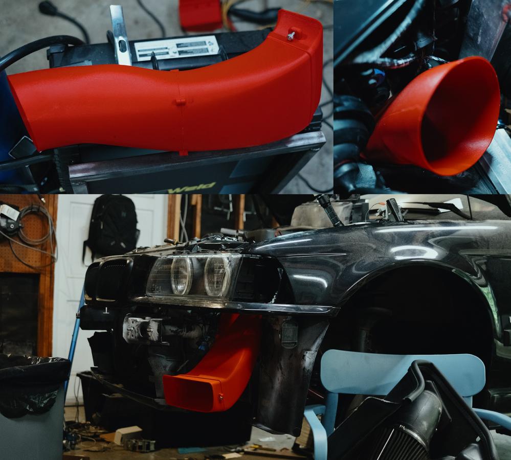

      Intake prototype parts for section 1 and section 2. This feeds my AFE intake nicely. The plan is to have section 3 be CSL box specific. The print failed near the top but still usable to test fitting. It was never going to be an end use part since its just printed in petg-gf
      One challenge I need to solve: The engine will move and there isn't a ton of ability for all of this to flex. I'm trying to figure out the best way to get some flexibility into the design without having to resort to anything that flows really badly like a corrugated hose. Open to a few ideas including wrapping and forming a custom shaped silicone hose/coupler, making longer slip fit joints between each piece, and keeping the middle section printed or made out of something with more ability to deform (polypropylene is a bitch to print but would work).

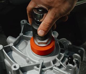

                      I made this output shaft seal installer and put it up for download in case anyone else finds it useful:

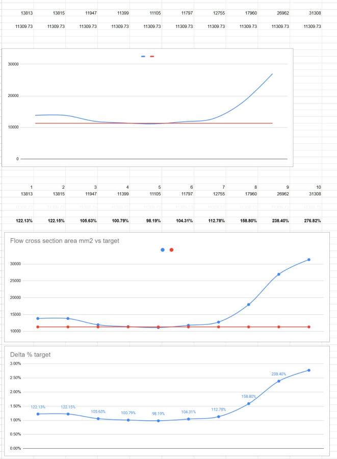

                        #41
                        More scanning, more reworking but I am close to a final design. I don't have the exact location of the CSL flange yet so that is just approximate. I printed a test part for fit check and its perfect, no extra space.. Intake area cross sections are also well dialed in.This version needs a slight adjustment to the brake ducting so I will be scanning one of those and reworking. It will need a small notch to make some clearance and the sensor will get relocated to the top.

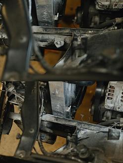

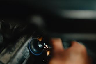

                        I also got to use a grinder on this car for the fist time removing the horn bracket:
ID:	304615 Click image for larger version

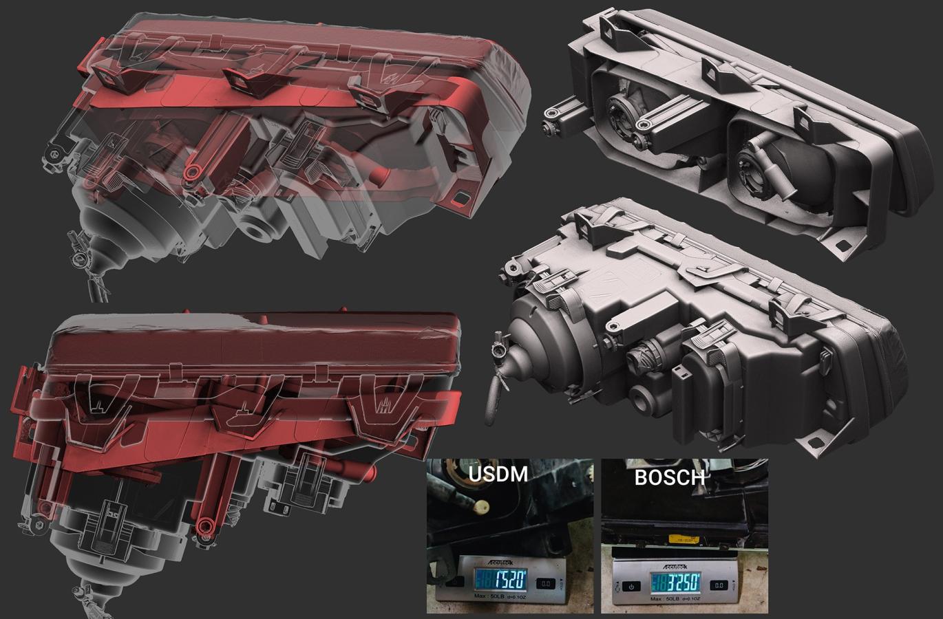

                        Headlight comparisons:

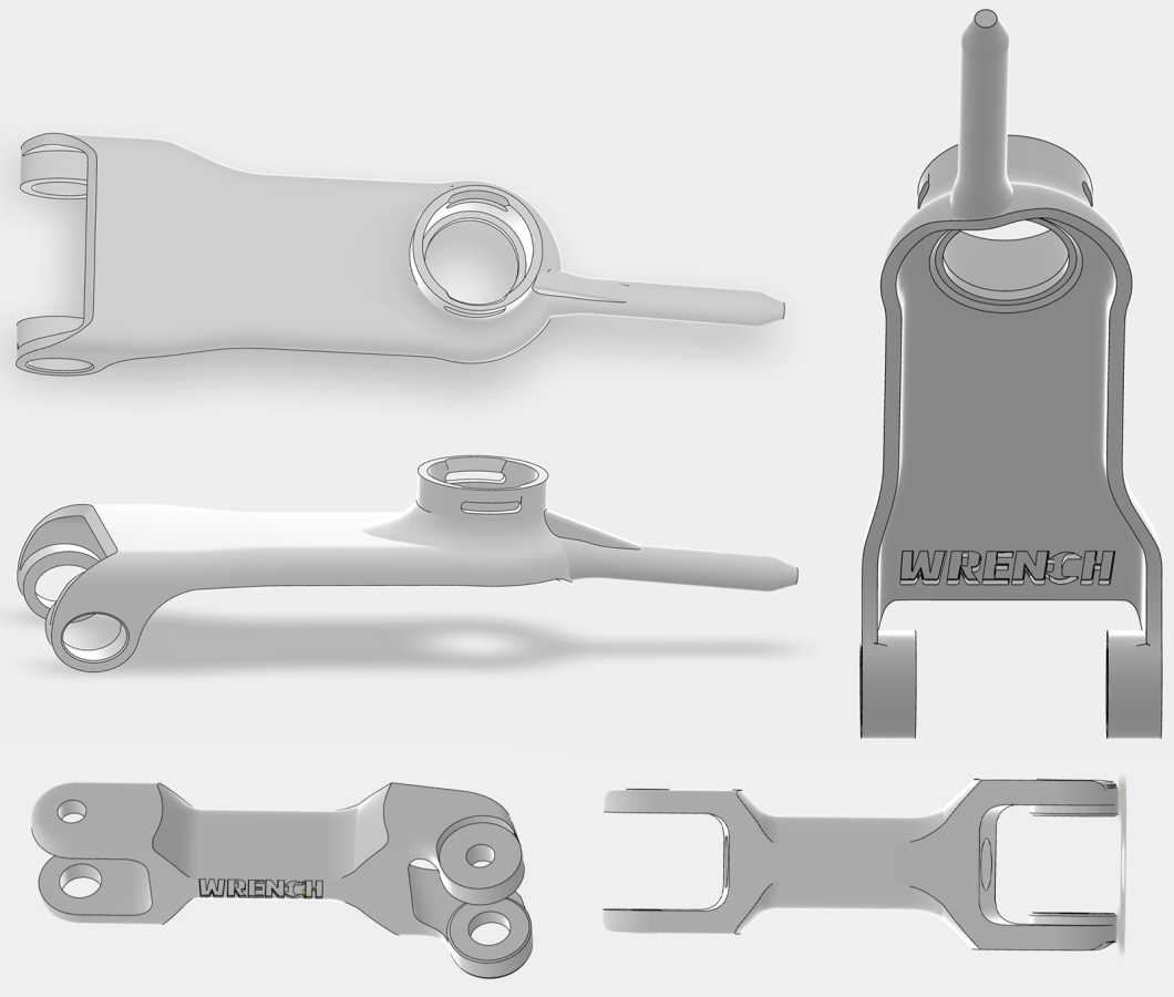

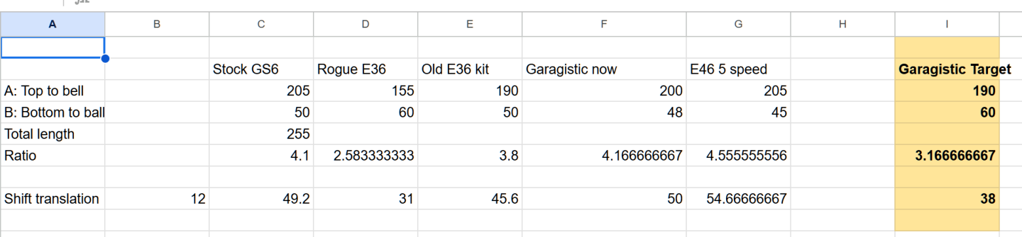

                          #42

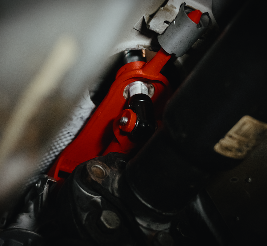

                          Been doing lots of things with my car instead of getting it back on the road. Short shift clearance for how this transmission sits in my car has been a problem so I am making up DSSR and shift carriers to solve that. These will be DMLS aluminum parts. I ended up settling on a garagistic adjustable shift lever. A quick chart I put together comparing dimensions of the shift levers I have laying around:
                          Click image for larger version  Name:	image.png Views:	0 Size:	92.2 KB ID:	312174
                          These are close to final iterations for carrier and DSSR:
                          Click image for larger version  Name:	unnamed.png Views:	0 Size:	217.2 KB ID:	312173
                          Click image for larger version  Name:	ShiftCarrier.gif Views:	0 Size:	562.5 KB ID:	312175
                          Plastic prototype parts fit tested in the car:

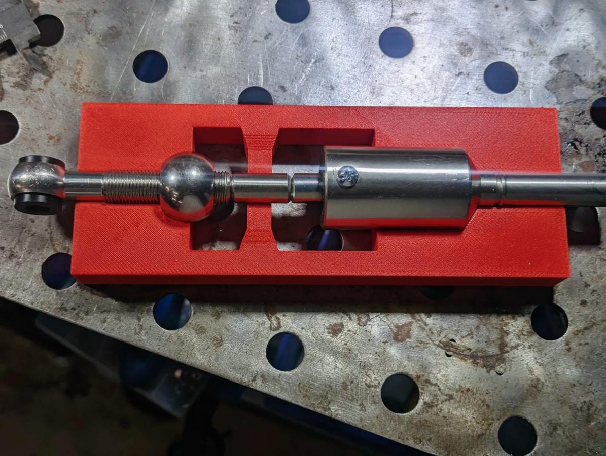

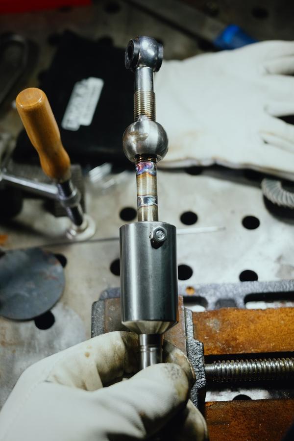

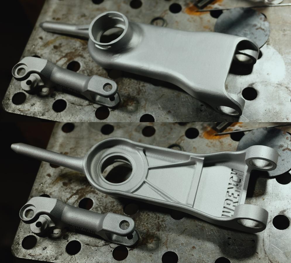

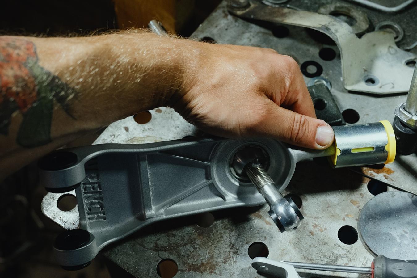

                              DMLS carrier and second revision of the DSSR came in. I also cut and rewelded my rogue shifter to make it fit:
ID:	314376 Click image for larger version
ID:	314378 Click image for larger version
