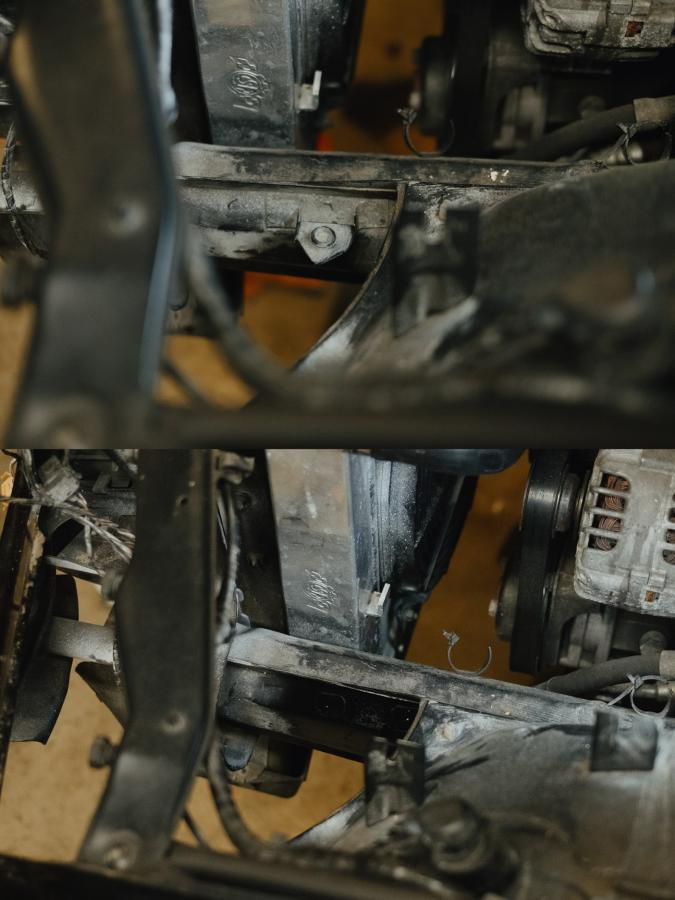

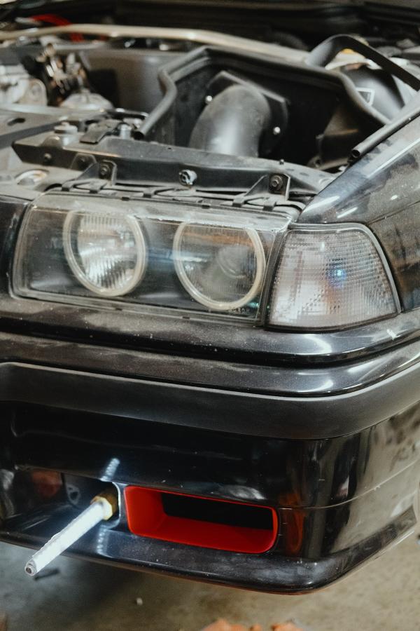

                        #41
                        More scanning, more reworking but I am close to a final design. I don't have the exact location of the CSL flange yet so that is just approximate. I printed a test part for fit check and its perfect, no extra space.. Intake area cross sections are also well dialed in.This version needs a slight adjustment to the brake ducting so I will be scanning one of those and reworking. It will need a small notch to make some clearance and the sensor will get relocated to the top.

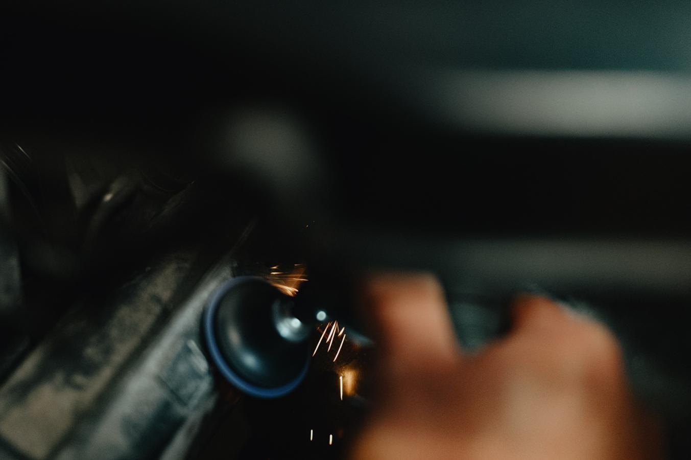

                        I also got to use a grinder on this car for the fist time removing the horn bracket:
ID:	304615 Click image for larger version

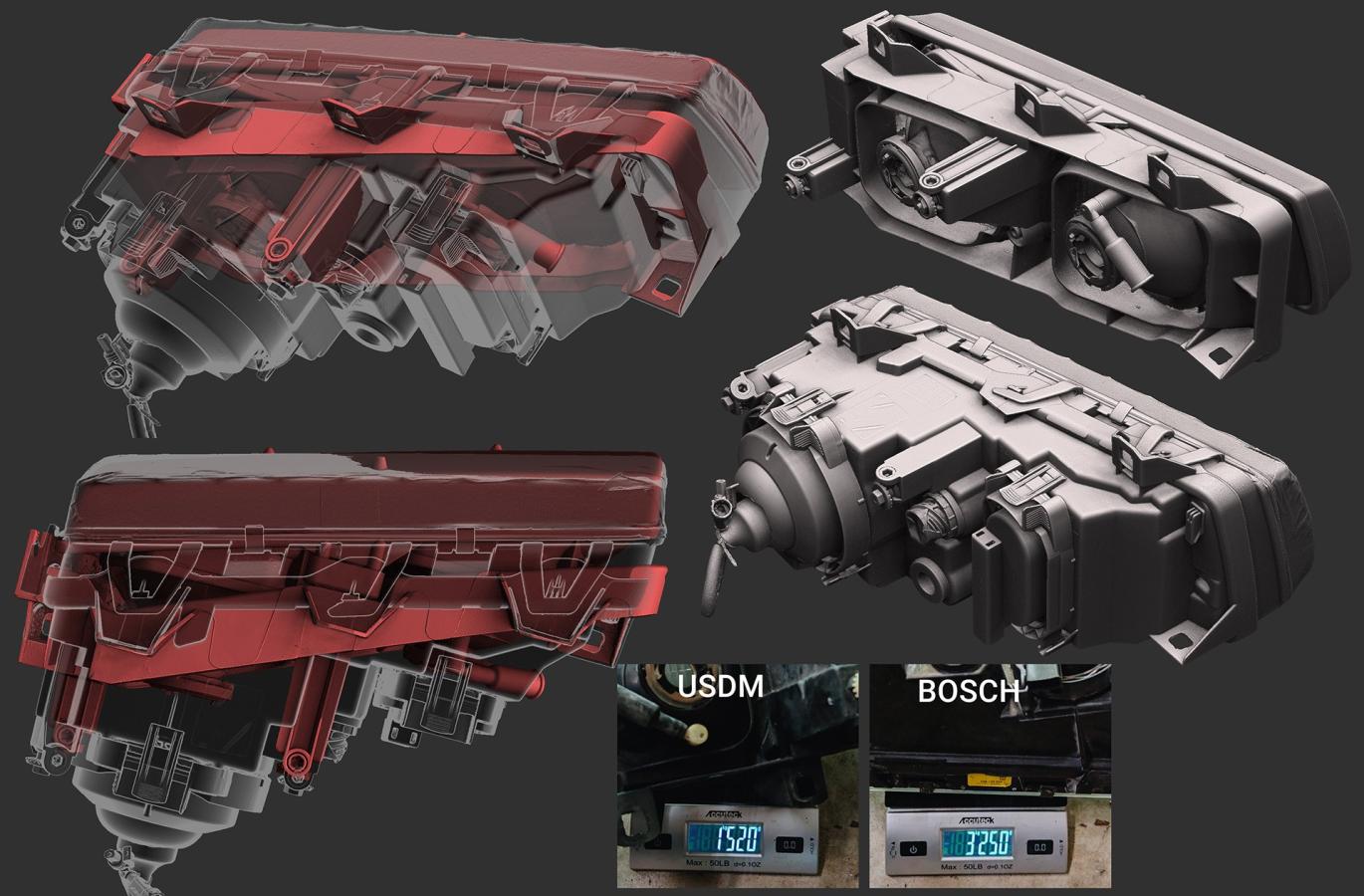

                        Headlight comparisons:

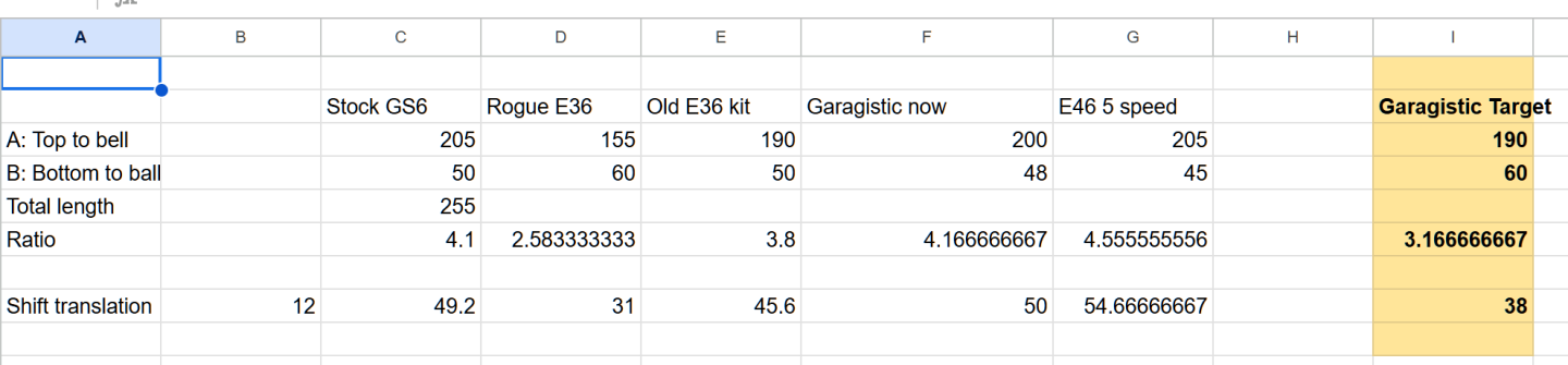

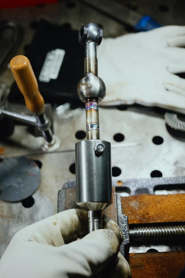

                          Been doing lots of things with my car instead of getting it back on the road. Short shift clearance for how this transmission sits in my car has been a problem so I am making up DSSR and shift carriers to solve that. These will be DMLS aluminum parts. I ended up settling on a garagistic adjustable shift lever. A quick chart I put together comparing dimensions of the shift levers I have laying around:
                          Click image for larger version  Name:	image.png Views:	0 Size:	92.2 KB ID:	312174 ​

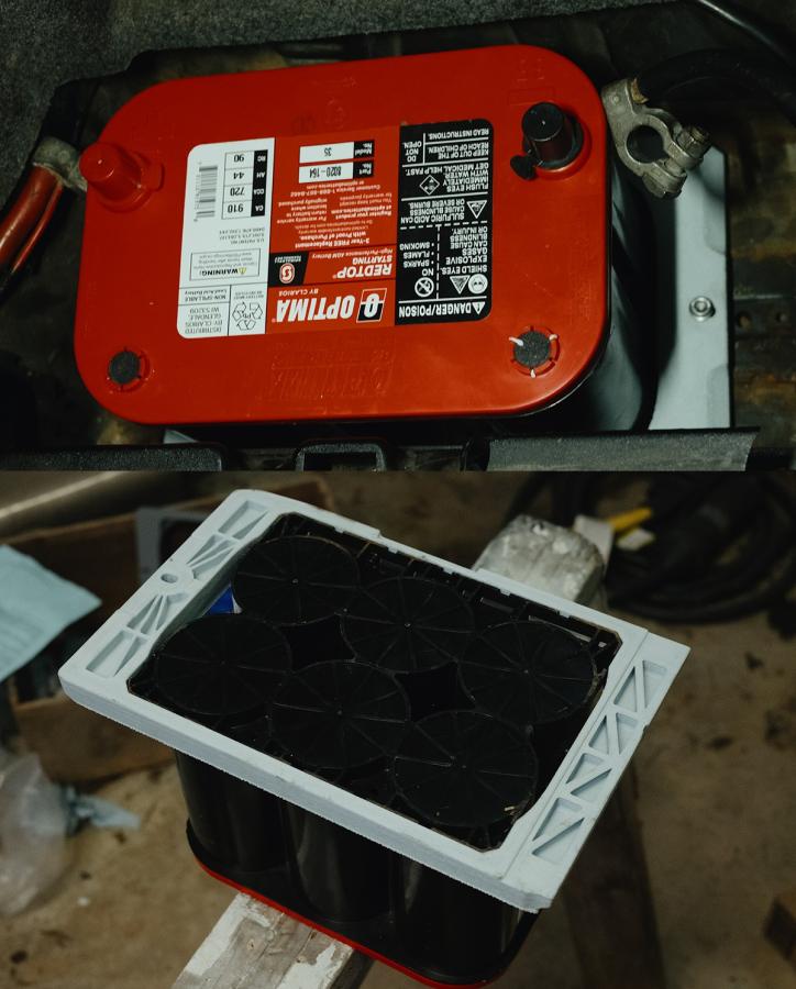

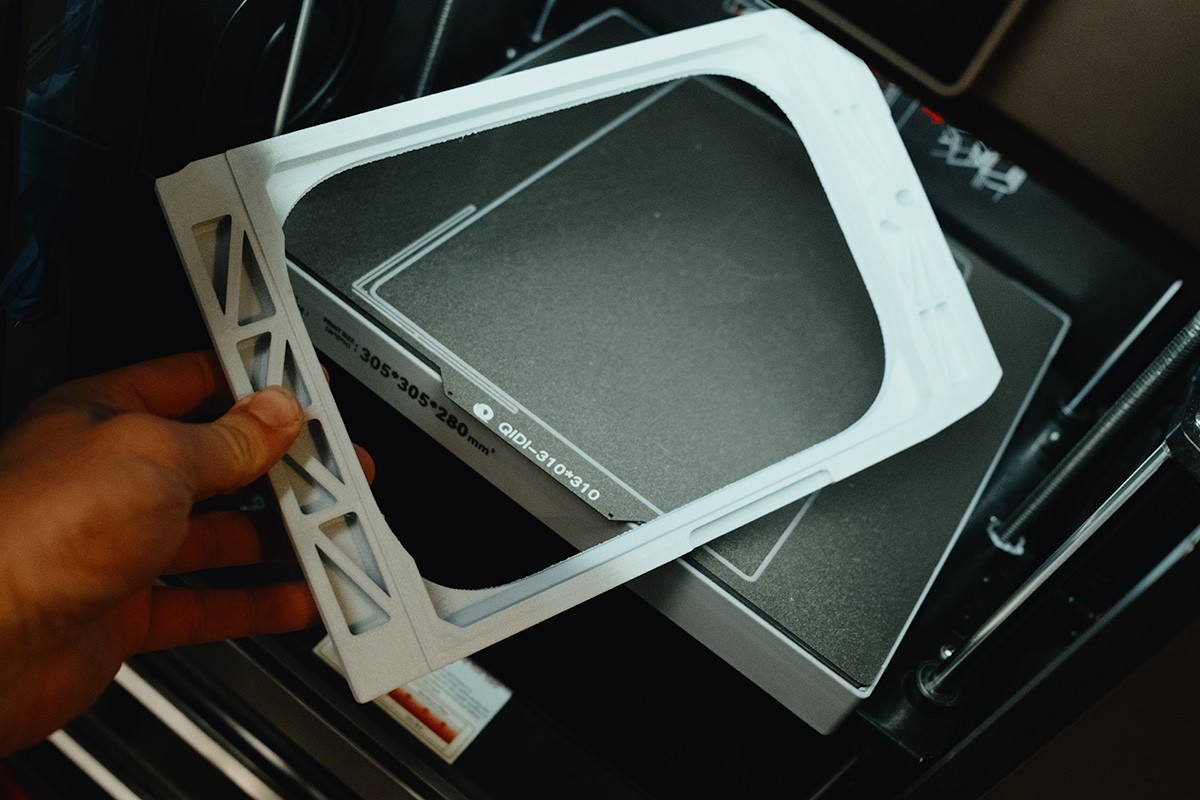

                            I also made up a battery bracket for an optima D35 style battery. It's printed in Nexpa-GF25 and I overbuilt it. The battery floor area has lots of panel joints and small surface changes to make clearance for so there was a surprising amount of complexity that had to get built into it.
                            I put it on makerworld:

                              DMLS carrier and second revision of the DSSR came in. I also cut and rewelded my rogue shifter to make it fit:
ID:	314376 Click image for larger version
ID:	314378 Click image for larger version

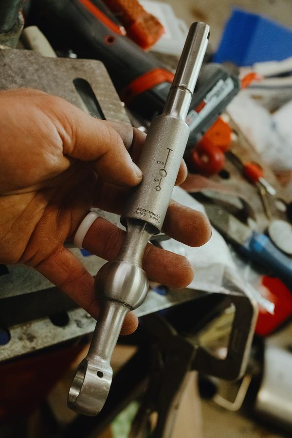

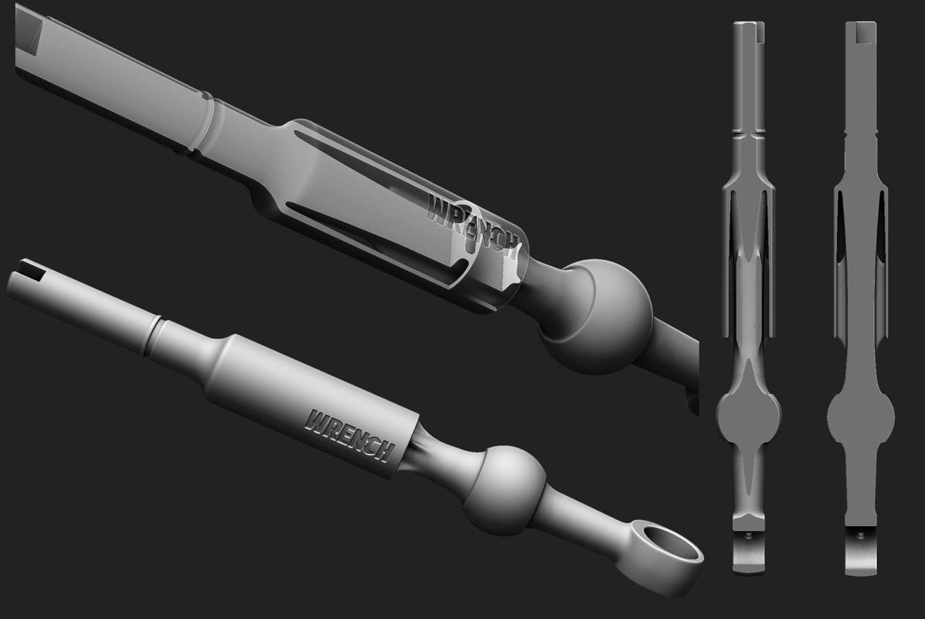

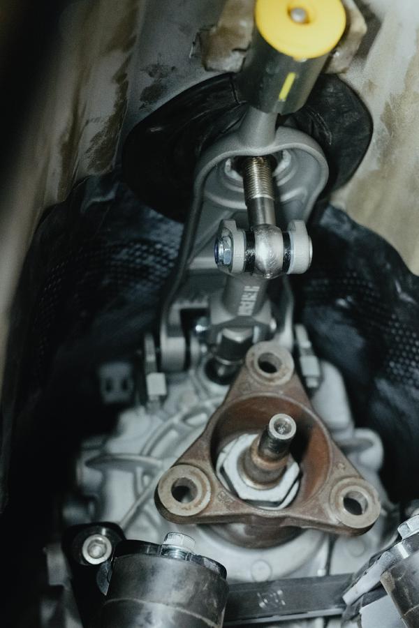

                                I never posted the final install of my shifter kit.
                                Attempting to show shift feel on youtube:
                                And then the final design for the shift lever + view of the parts installed:
ID:	323972 Click image for larger version
