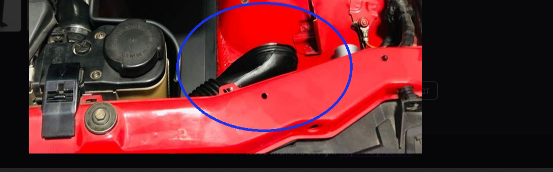

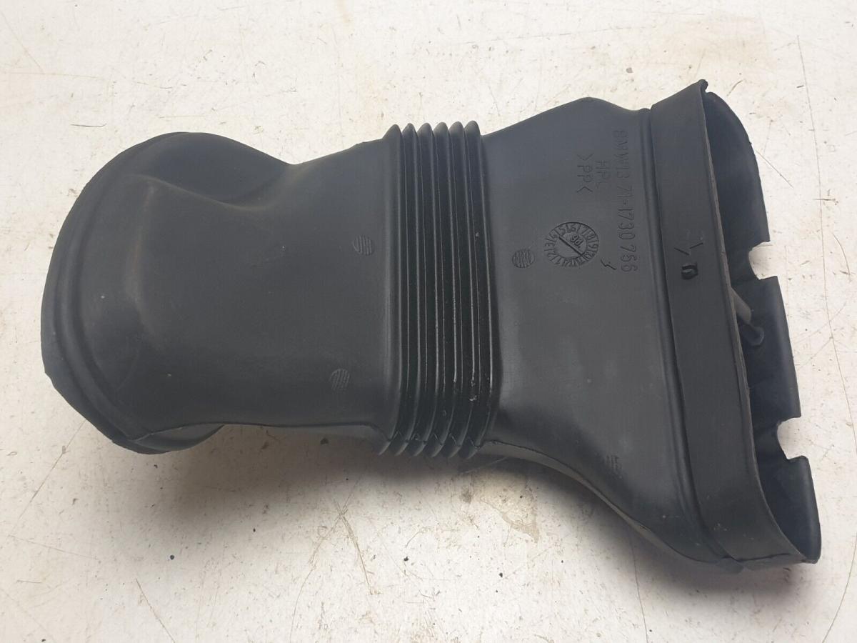

                You should also consider integrating the snorkel located behind the headlights into your CSL snorkel design. You don’t need Euro headlights for this, as the opening and factory snorkel are present on all E36 models both US and Euro versions. There’s plenty of fresh air available in that area since BMW uses it to feed the airbox. The stock snorkel is identical across all E36 models, except for the Euro M3, which has an additional small pipe that routes air to the brake duct. In my opinion, combining this setup with your design would give you the best results.

                    I'll take a look at that. It looks reasonably big like that might be a simpler alternative air path.
