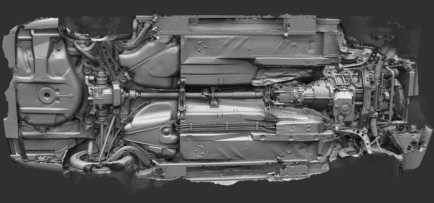

            I'm also in the process of pulling headers to do a packaging scan for header development.
              #96
              I spent an afternoon fighting an upstream O2 sensor in my headers and couldn't get it out, ended up rounding the sensor pretty well too. All my tools just slip. Torch, specially O2 sensor tools, and a big impact on deep well O2 socket wouldn't take it. I currently have Megan Racing headers with vbands in place of stock flanges- The vband welds leak badly and they are placed too close together so it makes fitting clamps a huge pain in the ass. I also want to be on stock flange locations to make header development easier.
              I'm going to cut these headers off of the car with a reciprocating saw so I can do my scan plus I'm going to trash them for the new flange locations anyway. Planning another set of cheap headers for now to keep the car on the road (megan racing seems like a good option for a euro header clone). Does anyone know where I can find the correct 2 bolt flanges and details on how the tubing should be flared to correctly seal to OEM style flanges and gaskets? Does anyone sell formed stubs I can tig onto rather than finding/buying a die to do it myself?

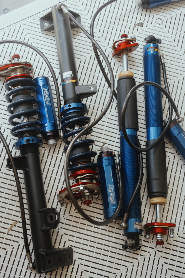

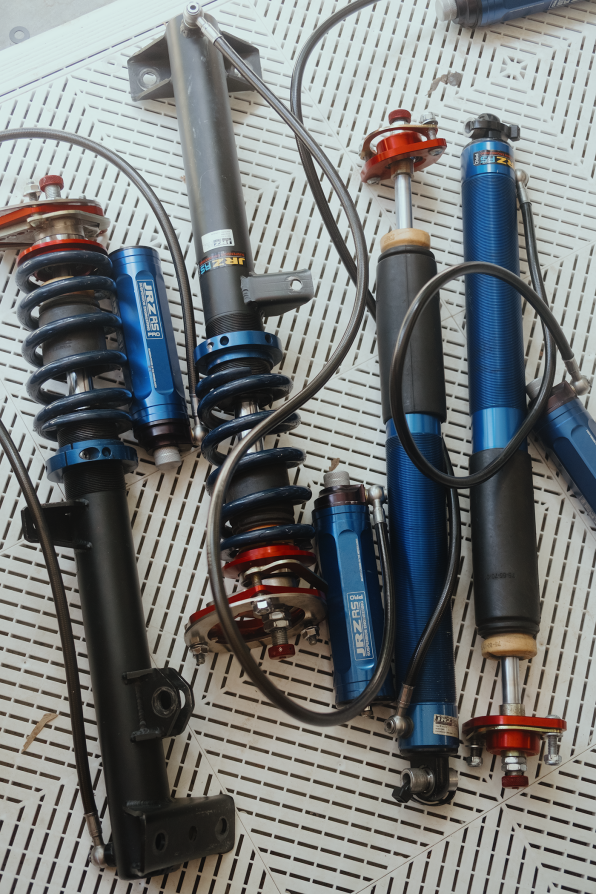

                *Just picked up these JRZ RSPro 2 ways off of a friend. Revalved by shaftworks Planning to run 600lb rear 400lb front (staying with divorced spring rear).

                I also redid my chassis and header packaging scan and included some of the engine bay. I now have it all in one contiguous mesh which is helpful. This is the largest scan I have put together and its useful for header stuff, exhaust, and intake ducting. For my exhaust I priced out what it would cost to 3d print all of the exhaust bends and its not that much more than buying and cutting Jbends. Maybe $200 more total cost but with the advantage of being able to including locating steps and marks at each joint so the thing assembles more or less idiot proof off of the car. I'll just be measuring and cutting straight tube and adding an index line along each part so I can get everything clocked correctly. I'm also printing the X pipe and also my version of a Z pipe with flanges to interchange between them. I want to A/B them and assuming performance is close pick whichever sounds better. The scan and all my exhaust parts will end up on my github.
