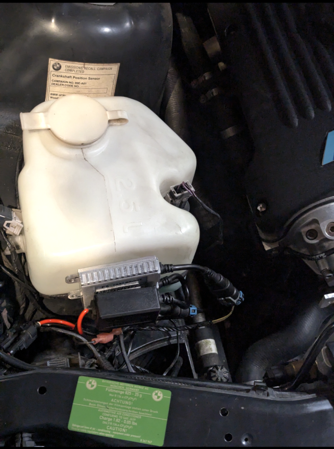

                              I have a lot of little things in the car I have been taking care of. Cluster mileage fixed by JBanzhaf. I replaced a hid ballast with the cheapest next day delivery option on Amazon. For now this is just 3m dual lock mounted where I can move it easily. I don't love having my passenger side ballast in the bumper since it makes bumper removal a pain in the ass. Looking for recommendations for who makes good hid stuff. It would be good to stop tripping the low beam failure error.
                              Click image for larger version  Name:	Screenshot_20240725-232740~2.png Views:	0 Size:	870.0 KB ID:	273298
                              Euro lights take up so much space and my googling suggests they are adding 11lb to the front end. They work really well and look nice though so I'm split on what I want to do. It would also open up more space at the most restrictive area of the duct path but I think so many people have euro lights that I should design this with them in mind. I did remove and trim the headlight pin piece because it was in the way. Probably not too much to ask for people to cut a little plastic. Putting it back in place without much to hold onto was a challenge but doable.
                              Click image for larger version  Name:	Screenshot_20240725-232809~2.png Views:	0 Size:	880.1 KB ID:	273299 Click image for larger version  Name:	Screenshot_20240725-232813~2.png Views:	0 Size:	675.3 KB ID:	273300
