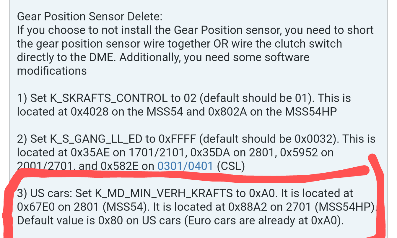

    Two cars that I flashed for SMG to 6 MT conversion. I've used ECUworx and both cars have the issue where the car would stall out and die when coming to a stop and pushing the clutch pedal in and they both had these 700 brown or black clutch switch
    I then had to take a look back at the SMG to 6MT DIY and look in the coding section and noticed there were three items you had to code manually
    The third option is the one that ECUworx is not setting, at least in the DME I was working with which were from 2005 ZCP cars. They were HP DME 2701
    But when I looked at the file and hex editor. The third option was not set and I had to set the third option and that solved the issue
    In a future version update of ECUworx perhaps that can be updated and fixed?
    I'm attaching a picture that shows the three options and the third option is one that is not set.

        From the SMG to 6MT DIY thread
        Brought over from M3F thanks to MP675 (I didn’t write this originally): Before I begin, I would like to thank everyone on the forum who has performed this swap before me. In particular, thank you to wrxnoob (the original!), RAZ M3, Performance Technic, M3SMITHNWESSEN, and especially beomoua, see.m3.go, and Abad46 for

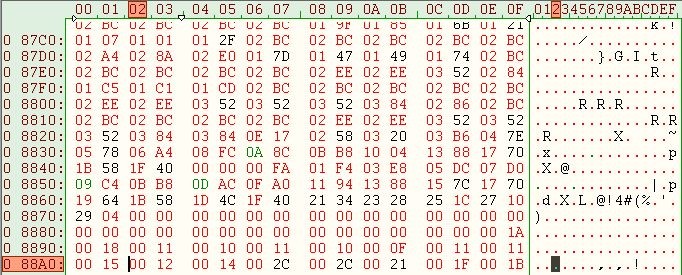

              Am i even looking at the right place? See pic?
              My car is a US car and currently in Europe, the HP conversion is done in Germany and the SMG swap is done in the US.
              In the latest version of ECU worx You have the option to choose clutch switch with GPS option or clutch switch direct wire and then you have a check box for GPS delete
              Those options work in general but they are not setting one additional option.
              Click image for larger version Name:	Screenshot_20231216-182144.png Views:	0 Size:	297.5 KB ID:	246028
                You have to use a hex editor to open your bin file so that you can modify the setting manually.
                If your car is running a US non-csl spec tune and you converted from SMG to manual, then most likely you need to manually change the third setting with a hex editor.
                If you use ECU works and open your bin file, it will tell you if your file is a US file or Euro file
                  Can someone explain how to check the Bin file? "It is located at 0x88A2 on 2701" i can find the "Row" 88A2 which is "00" now but what and where is the 2701??
                    first did you open your BIN file in ECUWORX to verify if your tune is USA or Euro tune? if its Euro then you are wasting your time. if its USA and its 2701 (ECUWORX tells you what the version is and the last few digits will say 2701) then you:
                    open your BIN file in a hex editor like https://mh-nexus.de/en/hxd/
                    once its open look for a GOTO command, not search
                    input the address which is 0x88A2 but drop the 0x and just type in 88A2. your cursor will go to the address and you look for 0x80... i you see it then change it to 0xA0. if its euro then it will already be set to A0. if its not 2701 then it will be something else completely different.

                            Version string is at 0xBFC0, should start with "0401" in ASCII if you are running CSL, or "30 34 30 31" in hex.
                            K_MD_MIN_VERH_KRAFTS is at 0x8B72 in the CSL, should be "A0" already.
