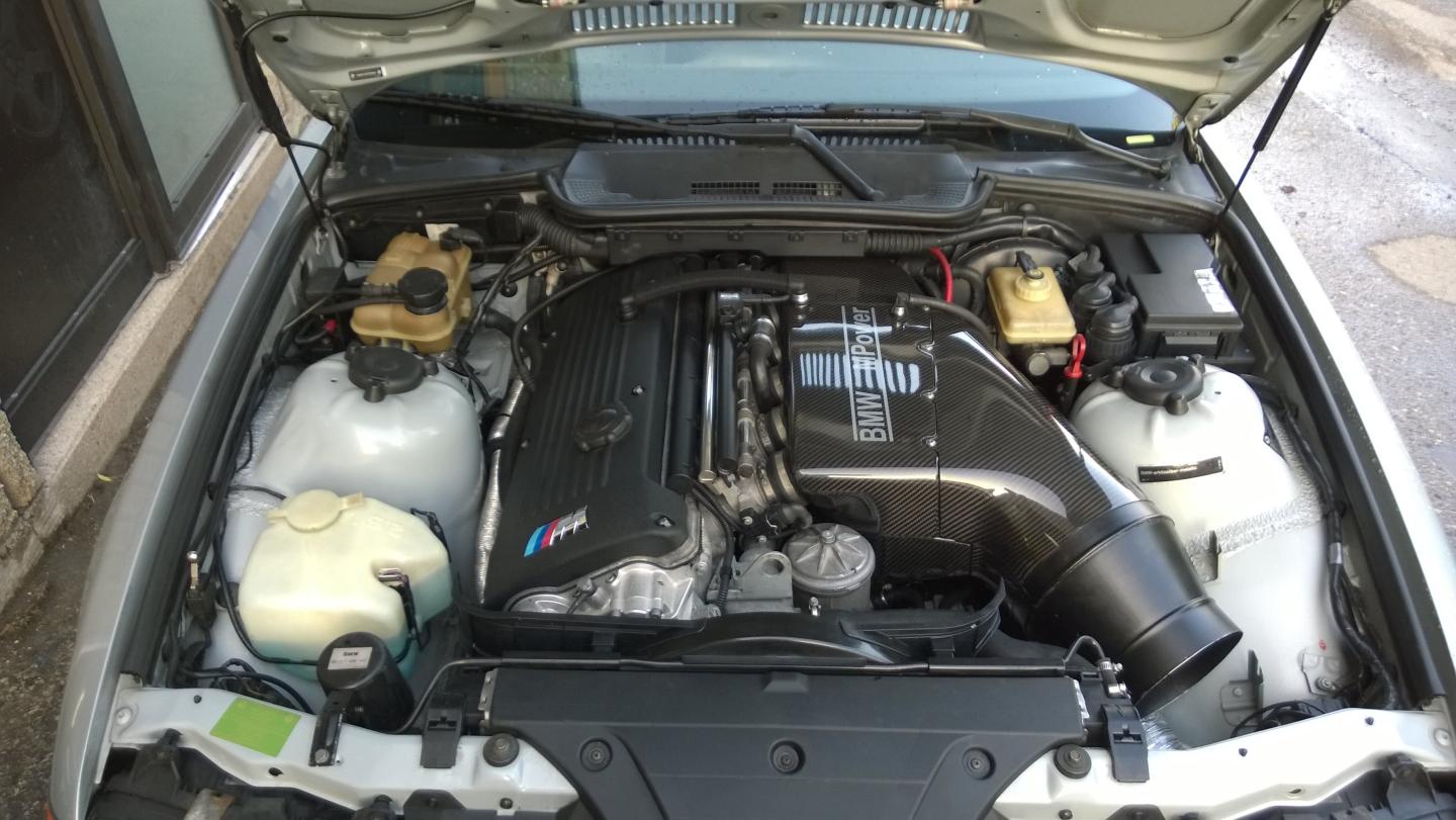

        11 years ago, I fabricated my own bracket and air rail. If you want to keep the MAP sensor in its original (OE) location, it’s not difficult.
        You can scan the MAP sensor to get the exact mounting points (I just measured it when I did mine), then have the mounting plate CNC-machined or make it by hand.
        Open up the air rail to the diameter of the MAP sensor and weld the bracket directly onto the rail. It took me less than an hour. Just be careful not to place it too close to the PCV valve position it a bit farther toward the firewall. Otherwise, you’ll have to route the PCV hose over the MAP sensor.

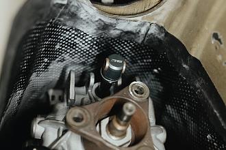

        For the dipstick bracket, I used a simple two-piece steel bracket bent at 90 degrees and bolted together, then secured it using the strut tower bolt. Very straightforward. Unfortunately, this is the only photo I have.
        As for injectors, just get new ones. I have a post somewhere that lists all the flow rates for the ones that fit.

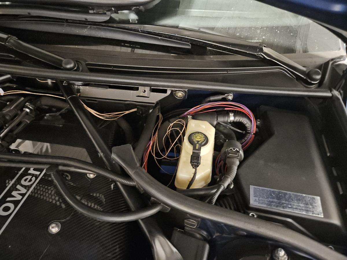

            Originally posted by 3staxontheradio View Post
            Anyone have a pic of what it looks like before/after?
            Nothing fancy, just some flexible vacuum tubing.

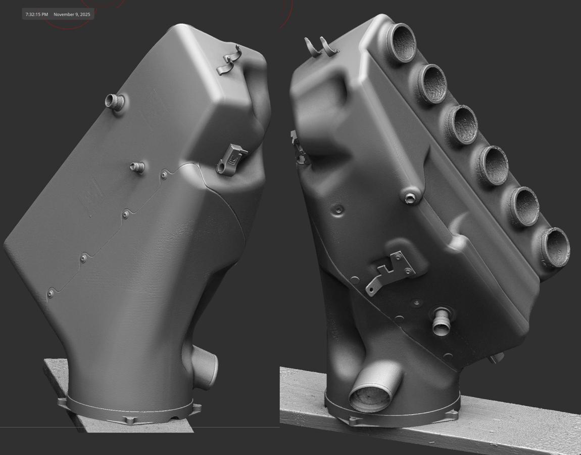

              Karbonius intake came on friday and I got a good scan of it before doing any install

                  I I use a photogrammetry setup with an older Nikon dslr (d800e) that has changed a little over the years but the main important points are:
                  Flash lightning so you can handhold at like f/11 and have every image be 100 percent tack sharp
                  A really good scale reference
                  Using reality capture to process and having plenty of workstation power and time for processing.
                  I use a cross polarized ring flash right now (so the light from the flash is polarized and then the lens has a polarizer on it, they are indexed so specular reflections from the ring flash are cut out). Scale is April tags on a scale bar that my processing software picks up automatically.
                  Photogrammetry is a much much more cumbersome and labor intensive route but you can get extremely high levels of detail that aren't really doable with a dedicated scanner. Really your only limitation for scan quality becomes how close your lens can focus. You could switch to a macro lens and resolve incredible small sub millimeter details if that ever mattered.

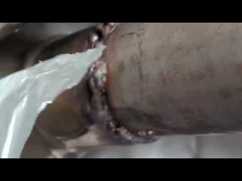

                      I did some bandaid exhaust modifications to fix the leaks and I cut out the damaged cat and for now am running catless. This is not my long term exhaust for the car. There are a few minor pinholes leaking a little bit and I'll probably try to patch them with the exhaust in place soon but its close to leak free now.. I ended up grinding out the birdshit welds as best as I could and then feeding mild steel mig, running a little hotter than normal, into the joints. I'm sure the inside of all these welds is atrocious but I don't think I made that any worse than what it was. I did tig in the new stainless tubes for the cat delete and being pretty new to tig it was an adventure. I guess I didn't clean the inside of the old tubing well enough and at a few points I was trying to manage a lot of contaminates bubbling there were into the puddle, exploding pinholes, and generally making it a pain in the ass. I also opted for solar flux instead of back purging because back purging 4 joints in this whole exhaust felt like and absolute waste of argon.

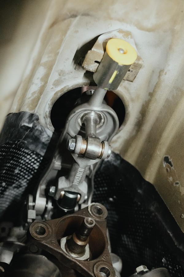

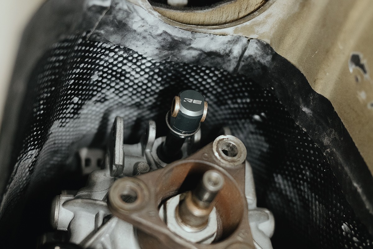

                      I also reworked the pivots in my shifter kit. I had previously copied Rogue's approach and used delrin flange bushings inside the clevis joint and those bushings ran on a high precision shoulder bolt that was loctite and then nutted into place. This ended up causing a lot of issues. Mainly delrin is a little soft and in order to eliminate slop/play in the system the clevis needs to fit tightly around the flange of the bushing so it is contained on the outside face. In this design the motion is constrained in two places, the inner diameter of the delrin bushing where it rides on the shoulder bolt, and the outer face of the flange bushing where it slides against the clevis fork. The problem with this is that in order to eliminate slop the clevis has to be tightened to the point where it starts to bind. That binding force wears the delrin and also imparts a small torque onto the shoulder bolt and between vibration and that force I found the clevis was loosening over time.
                      Rogue works around this by using pins and not fasteners for the bushings to ride on​. They also split the DSSR lengthwise so you can add tension to the design as the shoulder bushing wears.
                      I chose to swap everything over to bronze bushings and intentionally only constrain the joint along the ID/OD of the bushing and shoulder bolt so the clevis fork isn't interacting with the bushing directly. I also drilled out my rogue selector bushing and pressed in a bronze bushing in it's place. There is just barely enough meat to accommodate the larger OD of the bushing I used. I also modified my shifter and made an aluminum reducer to adapt it to the new bushing ID. Overall the feel is now really really good. No more rubber in the system and no more delrin. It all moves freely, very precisely, and without any slop, give, or softness.
                      Click image for larger version  Name:	Pivot.png Views:	0 Size:	819.8 KB ID:	340727 Click image for larger version  Name:	RogueJointINstalled.jpg Views:	0 Size:	215.3 KB ID:	340726 Click image for larger version  Name:	InstalledUpdatedShifter.jpg Views:	0 Size:	65.1 KB ID:	340728
                      The shifter feels fantastic but I'm getting pretty irritated with the behavior of this FX250 clutch material. Its gets really grabby when its heated up but in stop and go or city driving it's difficult to predict when it will decide to grab early. I have lurched the car a few times and every start from a stop feels like it takes a bunch of concentration and like I am playing a clutch behavior lottery. It's a non issue when shifting while driving, just starting from a stop is not pleasant.

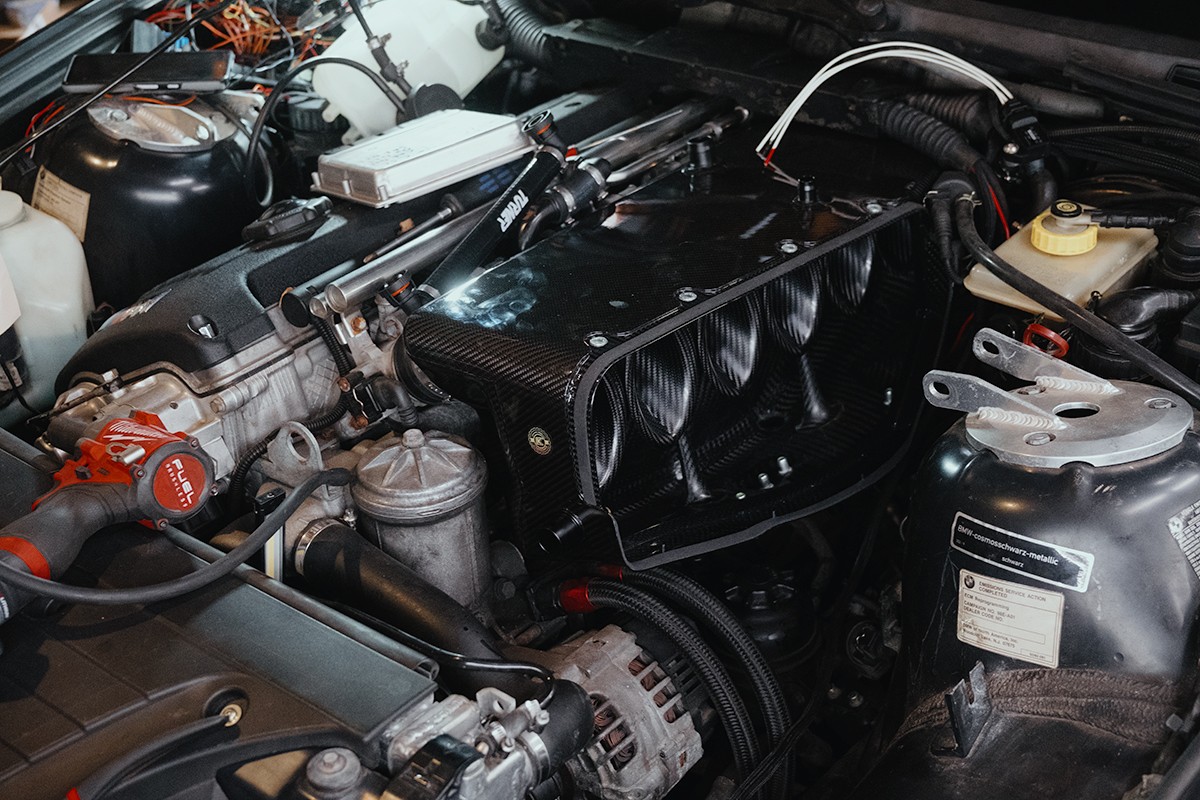

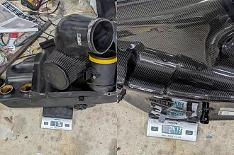

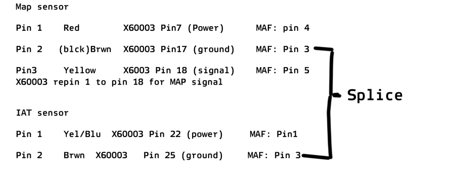

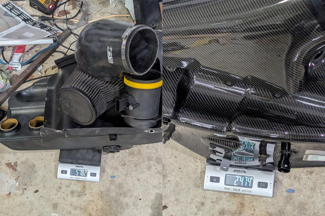

                          I started the install for my karbonius box. I'm waiting on a replacement for the vacuum line that comes off the back of the air rail because I found mine was pretty deteriorated. Also I weighed the OEM box + filter setup I had before vs the karbonius box with the filter installed. 5.782kg for the old setup and 2.474 for karbonius box. I had already transferred all 6 of the couplers would I would guess are around .25kg. Still, not bad for bonus weight loss on the front end.
                          I decided to wire mine off of the maf wiring and move x60003 pin 1 to pin 18. The wiring notes I made look like this:

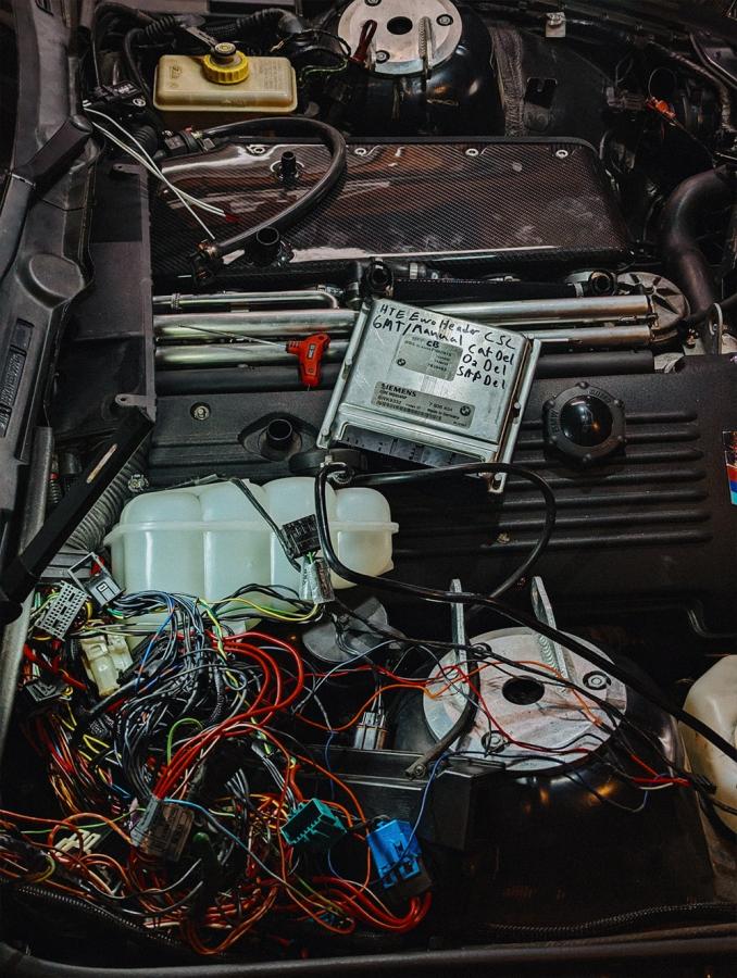

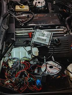

                          Lastly I really need to de-tangle and deal with the extra fuse holders, relays, and excess e46 m3 harness wiring that is being crammed into my ECU cubby:

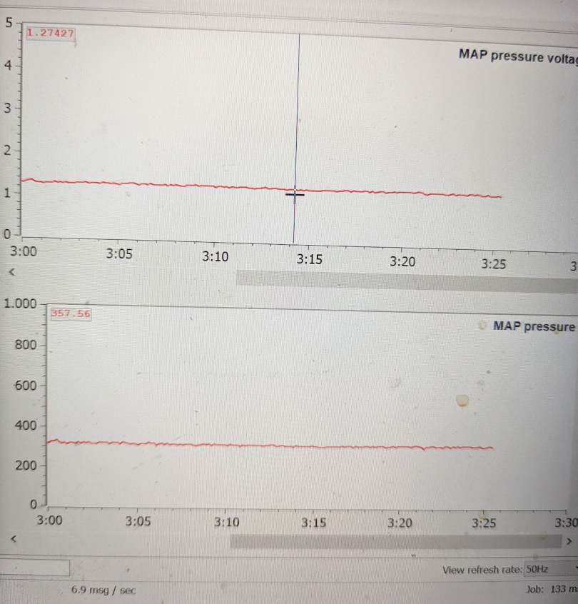

                            I have had the karbonius box on the car for about a week- the sound is great but I'm having some issues I think are related to my map sensor install. I also updated the bootloader with MpowerE36's tool and am currently running Bry5on mullet tune. The car is down on power, especially on the low end, and throttle response is lazy. When I first did the airbox install everything felt great except for some hiccups with the HTE tune that happened to be on the DME before I got it- not faulting the tune, its not for my car and I know nothing about it other than it says its an HTE tune for someones CSL car.The lazy low end power and throttle response happens with both tunes and if I reset adaptations it gets better temporarily. Long term trims are picking up bad data and throwing the car fueling off. Also with both tunes I get some on throttle hiccups and hesitation at medium to high loads and 4000ish RPM. I think this is just a fueling issue in line with whatever is throwing long term trims off.
                            I wired my MAP sensor by splitting the IAT ground off of the MAF harness (its all properly crimped open barrel splices, not worried about wiring and crimp quality). Martyn has a very helpful MAP sensor testing guide here:
                            I'm getting slightly different voltages when the car is off and when the car is idling, I think my ground location is causing a signal offset and I'm curious if other people have also grounded both MAP and IAT off of the same wire, its pin 25 on X60003.
                            Key in position 2 I get 4.02 volts and idling at about 900rpm I get close to 1.3v for and a 360 mbar reading. I live at about 400 feet of elevation so that doesn't really account for the difference in voltage when the car is off at position 2. Atmospheric pressure where I am should be 998.6 mbar which is a much smaller voltage difference.

                                What are your long term fuel trims? A MAP sensor issue is unlikely to cause meaningful LTFT drift on its own - you may have another hardware issue.
                                Also as a test with the mullet - it should drive pretty well with the MAP unplugged, automatically defaulting to alpha-n. If it gets better after unplugging the MAP sensor, then it’s highly likely you’ve got an issue with MAP. Remind us which MAP sensor you’re running? The Kassel one in the air rail is known to cause issues as it’s pulling just from one cylinder and not the average of all cylinders.
