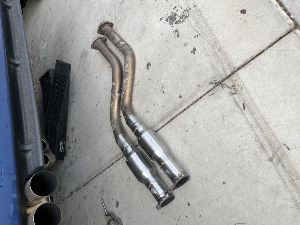

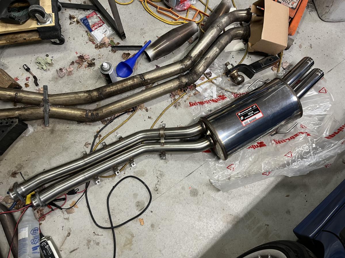

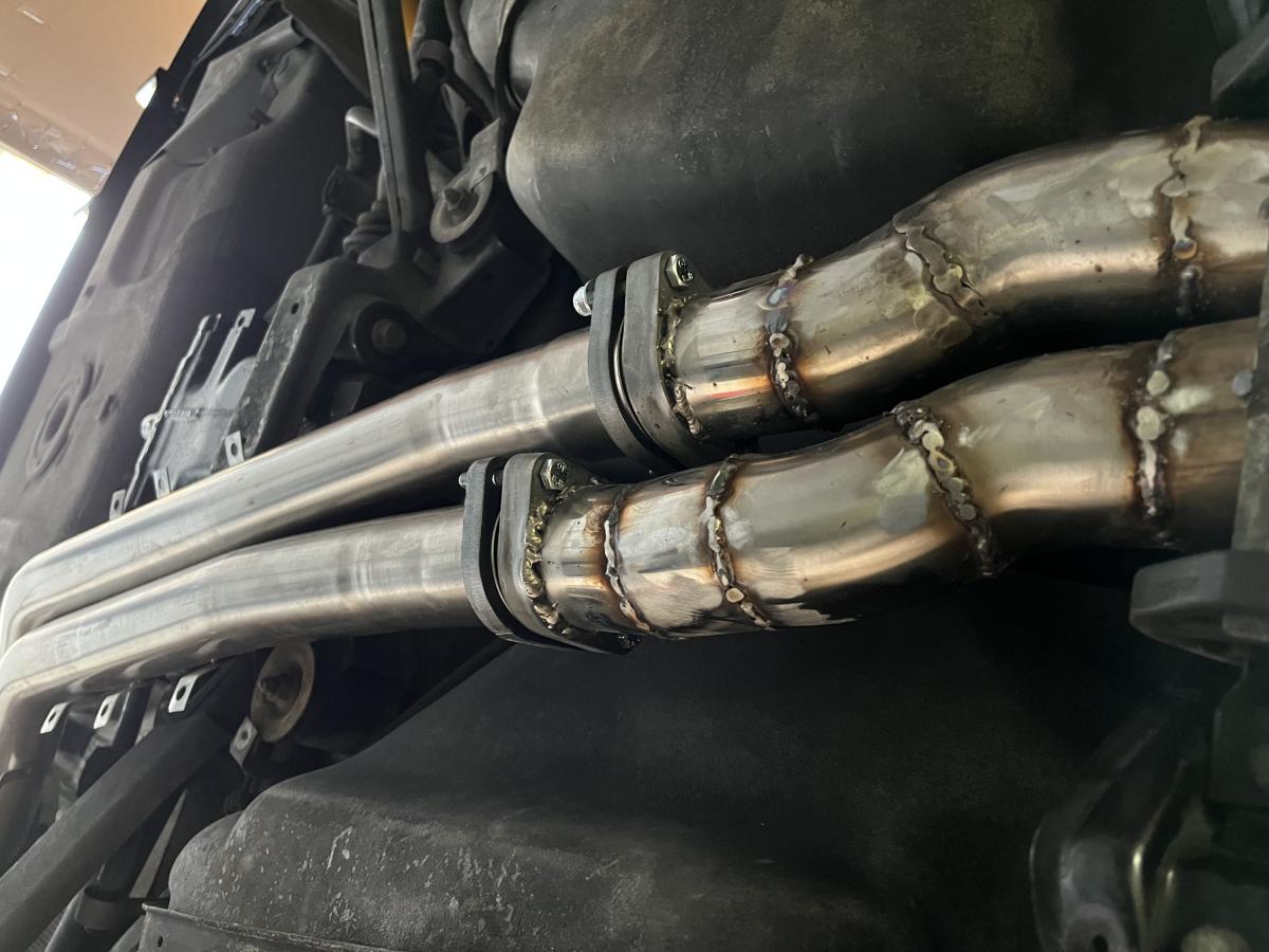

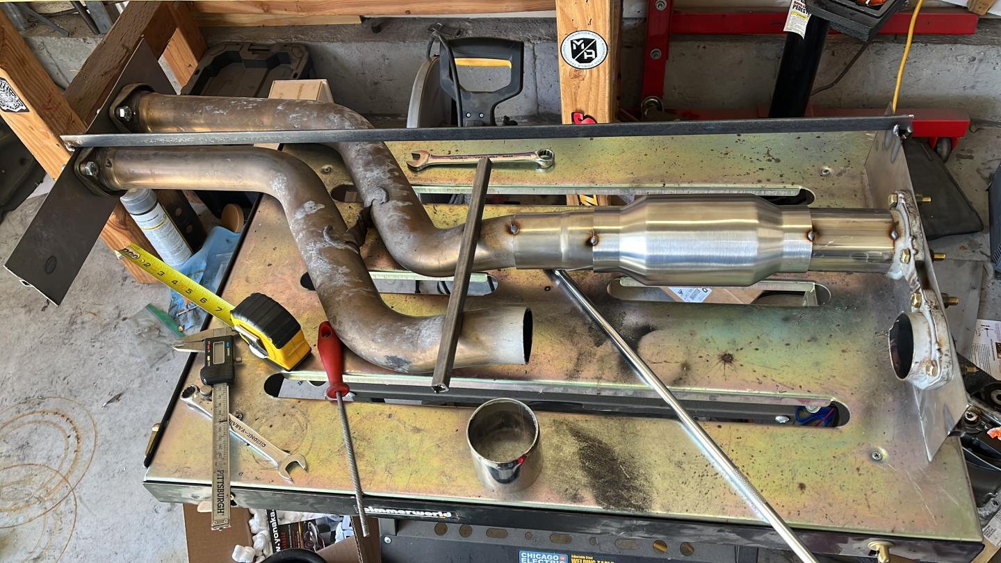

              Im s54 swapped, using Status Grüppe headers, e46 m3 section 1 with 2.25” 200cell cats in place of the resonator and tube. Matted to e46 m3 section 2 flanges with custom X pipe, and a SuperSprint Euro Race (60mm) section 3 muffler
