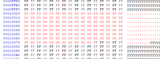

    I think I have hit my limit on my MSS50.1. Do you have any guidance to get me back on the dyno?
      Remaining flashes depend on your flash tool but no worry you still have lots of flashes

                So in order to reset the flash count would I have to change the 00’s back to FF’s ??

                    When i need to reset, flash the edited full bin read through mss5x flasher through 20pin.
                    My car is OBD1 1997 so OBD2 does not work because no CAN pins or pin 17 in my 20 pin connector
                      Even if you modify your full binary, tool like mss5x flasher doesn't re-write this sector of the memory. You need a special tool like mine to do it.
                      https://www.youtube.com/channel/UCwN...zf45mXp6PDOCzA
                        I see but if i had your tool is that what the tool does?
