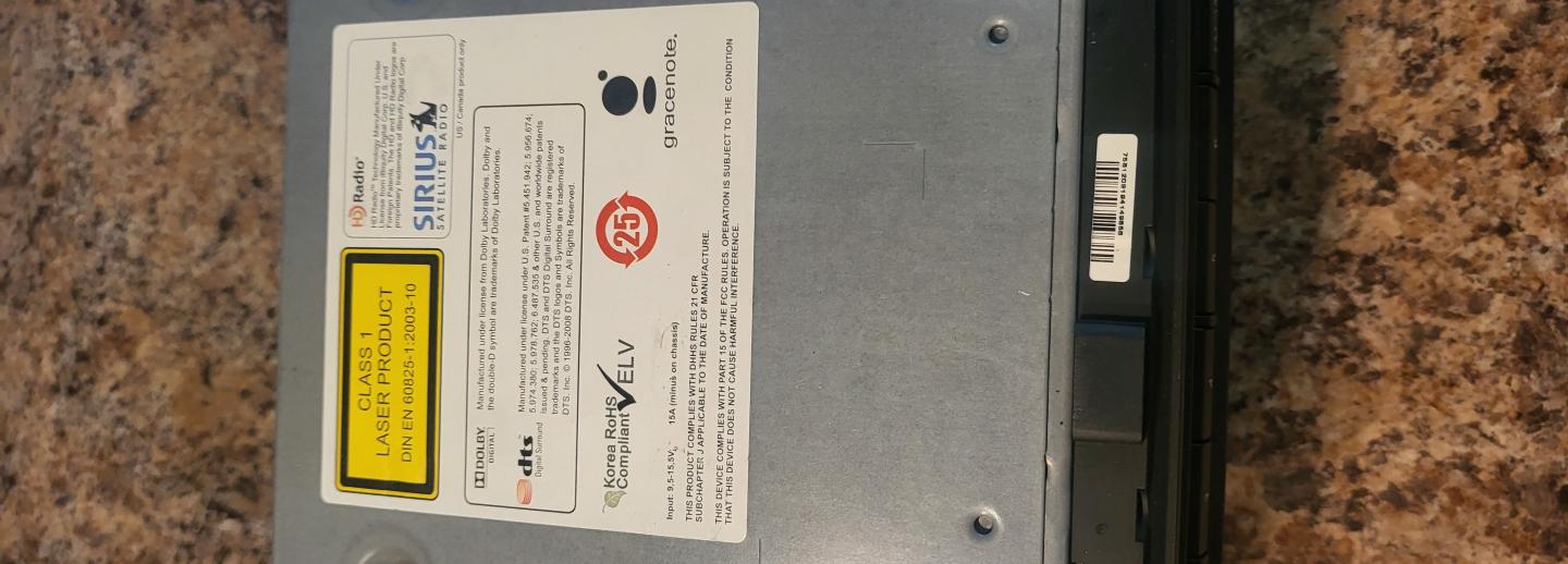

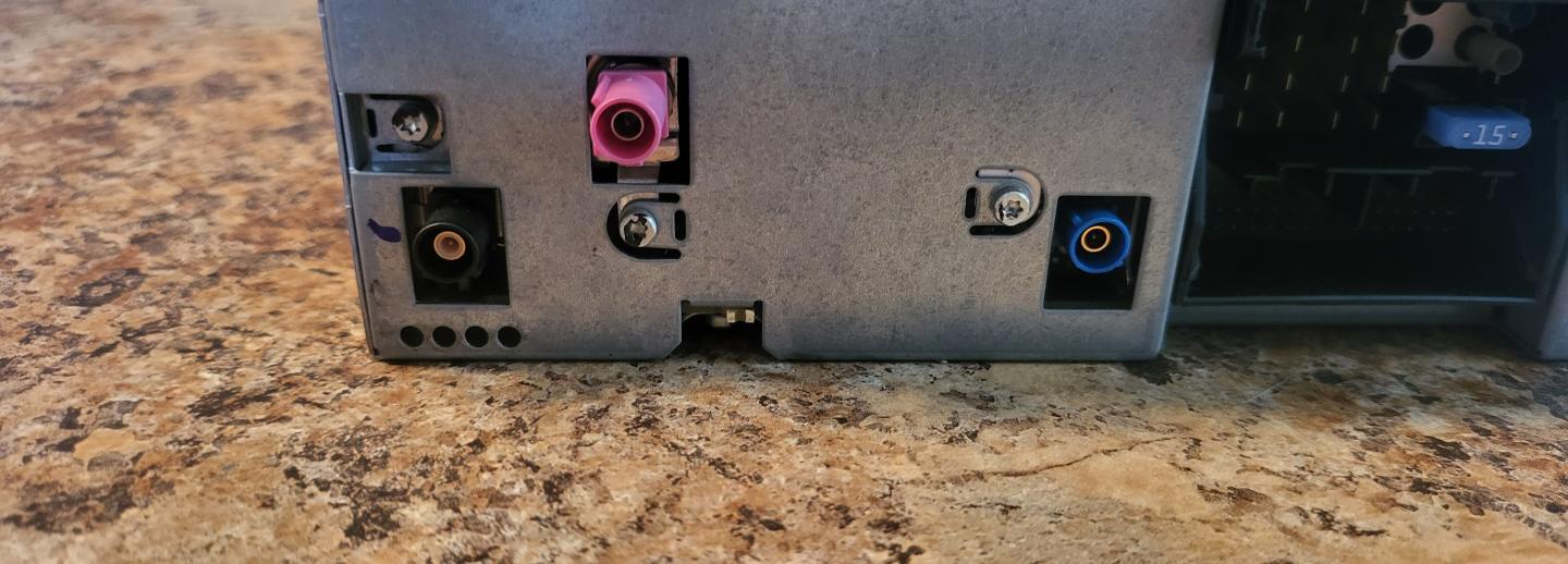

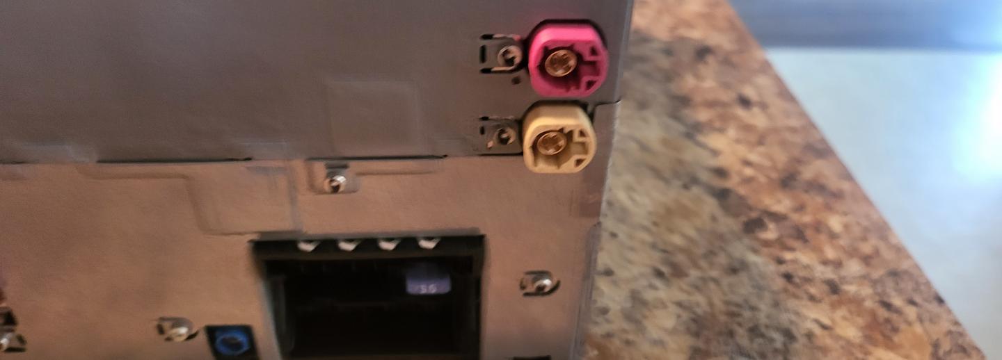

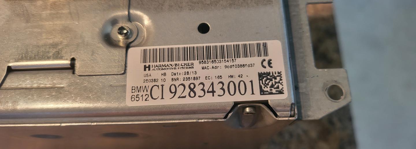

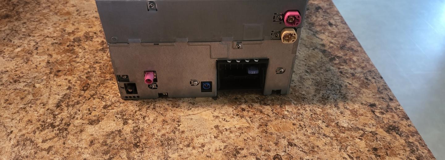

            I did look at the old amplifier and it had the part # 65127850091 on it which shows that it is an old part number for the individual audio system (and everything worked before on it). Herre is the old radio that was removed...... To compare to the new one with the part number I sent. I don't know a lot about these cars yet.....
