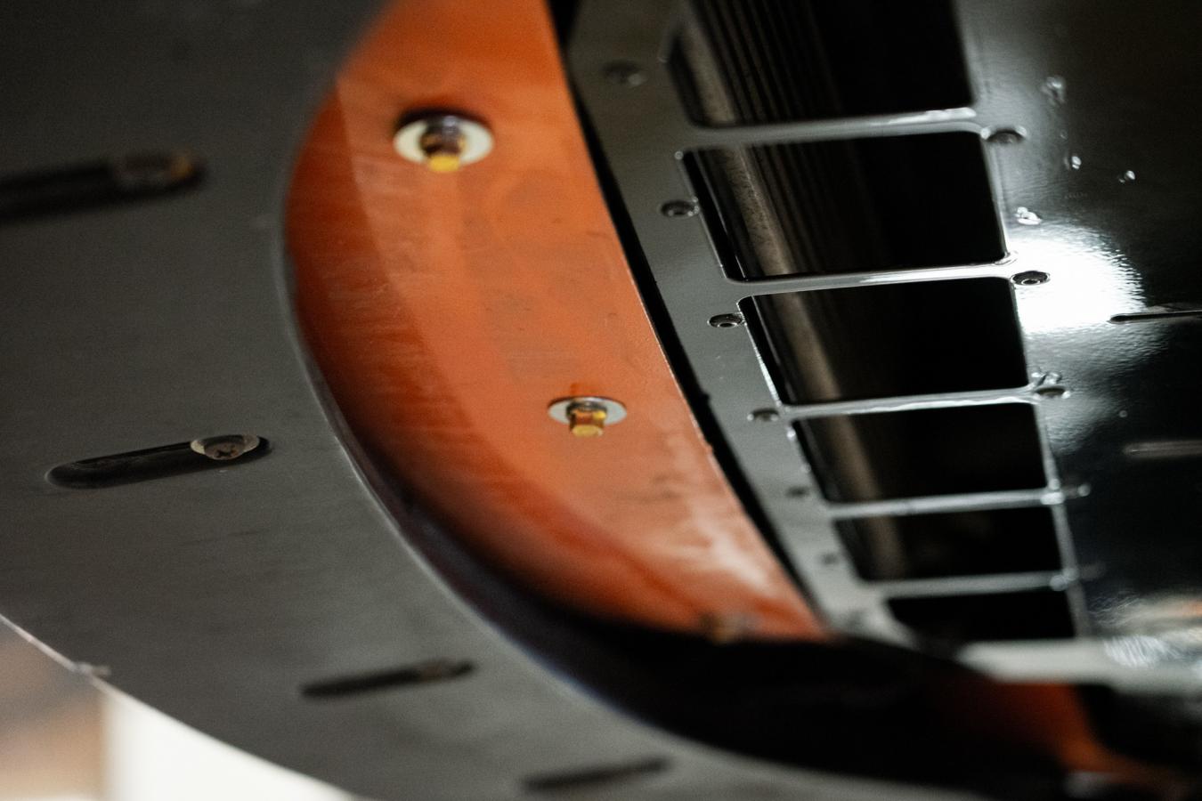

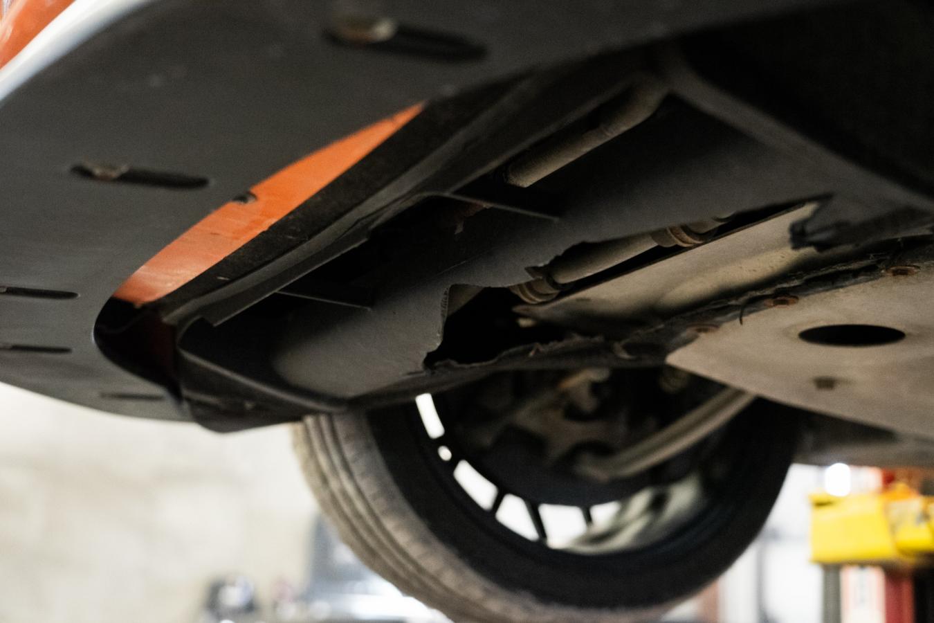

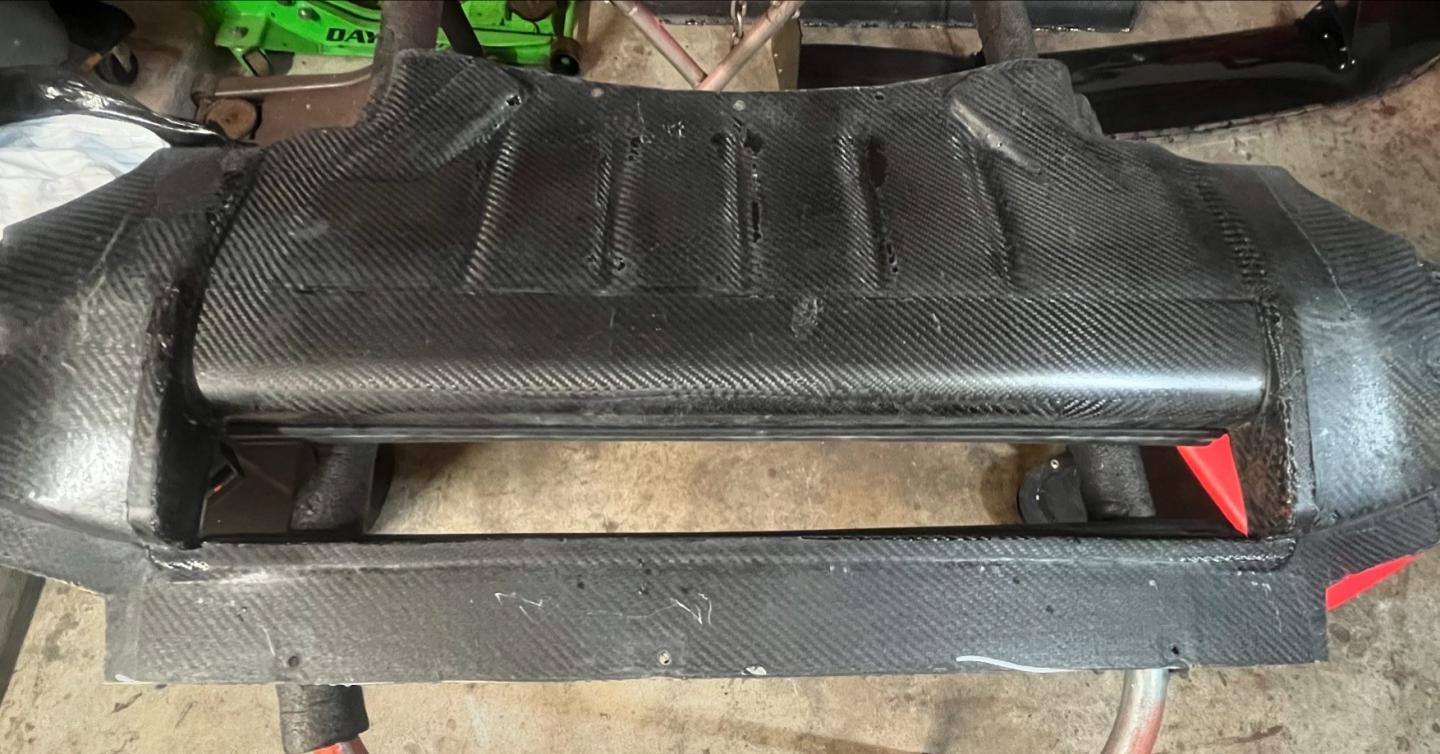

                Things come up and got working on other things. I tore up my first carbon version over the summer on a road gator. No bumper damage. The carbon ends have held up WAY better than the OE part. The part resists abrasion really well.
                Finally figured out the center cover...mostly. Making the V2 mold was such a pain in the arse! I've incorporated the gurney flap which is bonded onto the part. I need to get bigger clamps. I managed on the one in the picture. I've been doing some aero testing on my E46...the gurney is going to be important for oil cooling.
                As you can see the first part of V2 is far from perfect. The area around the duct is quite tricky to layup. Since cosmetics aren't important, I am just going to stuff some carbon strands into the tighter areas. I could use a prepreg but that adds a lot of cost without much benefit. Yeah, it will save maybe a .1oz since I can use less fabric and it will look better...but it adds about $100 to the cost to make one.
                I'm going to make the end caps with an outer layer of Kevlar on the bottom and then I think the experiment will be complete.
                The OE speed clips don't work really well. I installed rivet nuts and used M5 hardware. I think this will be a massive improvement - M5 hardware will be much easier to find and replace.
                Overall, I think this is a win-win-win. My carbon parts are lighter, significantly more abrasion resistant, and will thus last a lot longer and cost less.

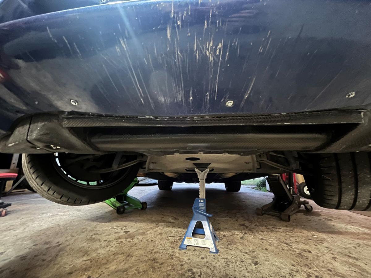

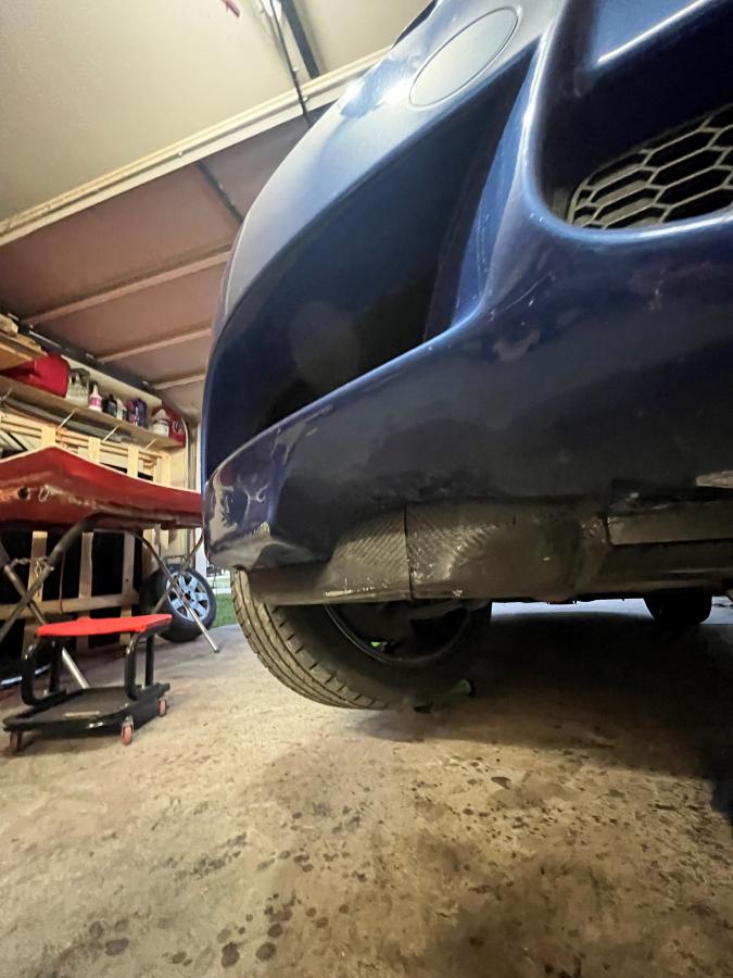

Name:	E9X Plate.jpg
                The end cap has seen over 10k miles
                Installed with the gurney and autozone hardware. I haven't had a chance to think about the best approach for hardware. Corrosion resistance is important to prevent seizing and rusty bolt heads. I can use stainless rivet nuts. Not sure black stainless fasteners exist. I can get black oxide steel hardware - torx button heads to drive everyone nuts! lol
