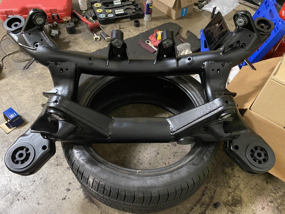

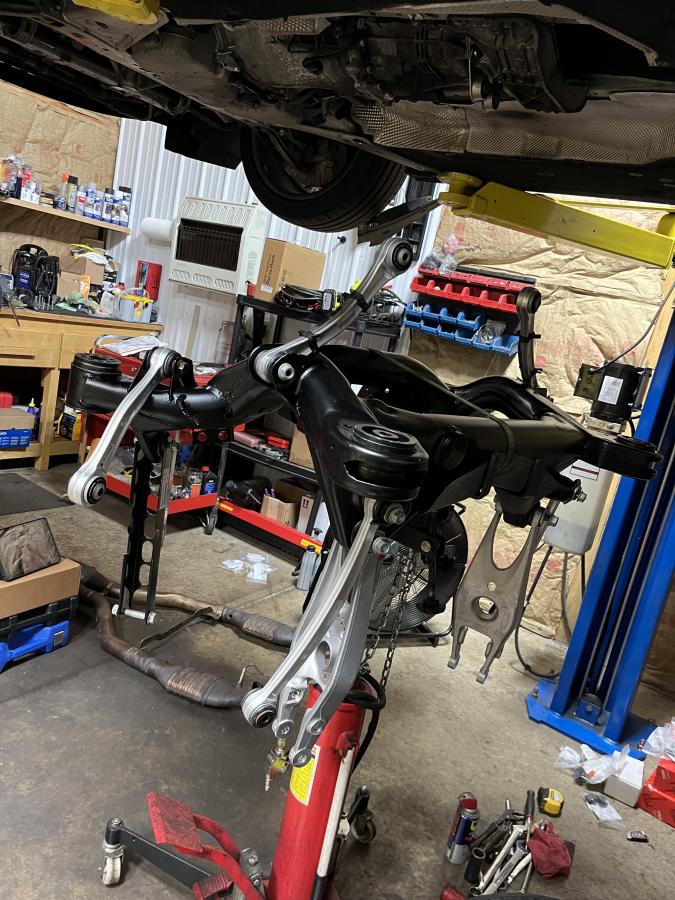

    Everything that goes in the rear subframe is in. Subframe mounts are Bimmerworld solid aluminum; all others are OE.
    The subframe mounts were apparently a huge PITA. To be expected I guess.​

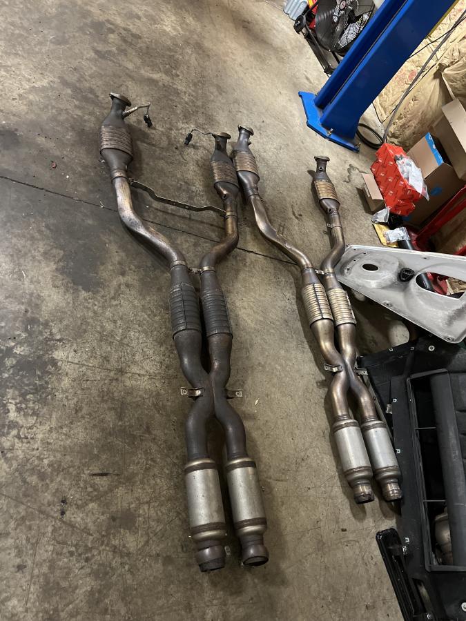

    In other news, when I went to pull the secondary O2 sensors out of my ragged factory X-pipe, the threads were... not happy about it. In theory we could have repaired the threads and gone on with life. But that X-pipe has almost 155k miles on it and has already had to be repaired once (rust crack). Plus, I've had cat efficiency codes here and there. And at this point, the last thing I want to do is add more labor time as we're already way behind schedule. So, after some hand-wringing, I made the call to swap in a much lower-mileage used factory X-pipe. Not happy about the expense but it should get the job done.

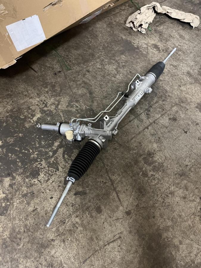

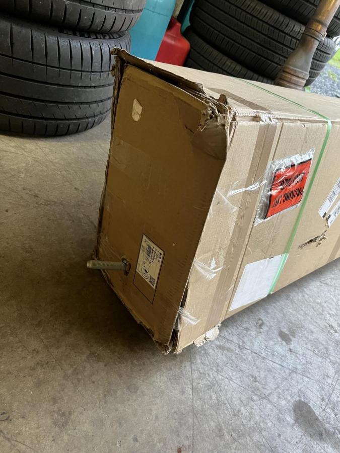

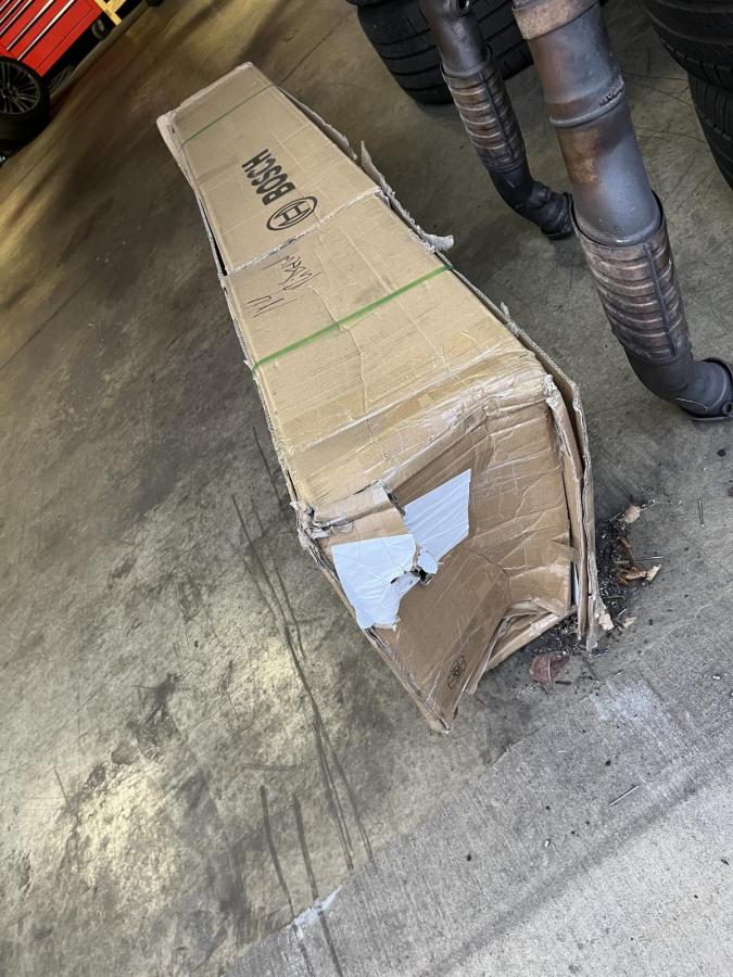

      Steering rack ended up coming in just in time to allow the front end work to get done. And when I say coming in, I mean barely. Looks like it was amateur hour wherever it was packed, because... damn.
      Couldn't get a pic of the inside of the box but the rack was just floating in there with nothing but packing paper around it (and not even enough of that). No foam or plastic to hold it in place. Horrible.
      If I hadn't been on a deadline, and if the supply of these things didn't seem so short, I 100% would have complained and made them ship me a new one.
      Fortunately the rack seems fine. So nice to see it after all this time.

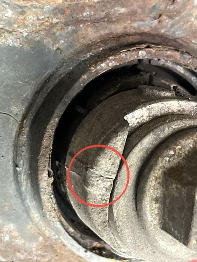

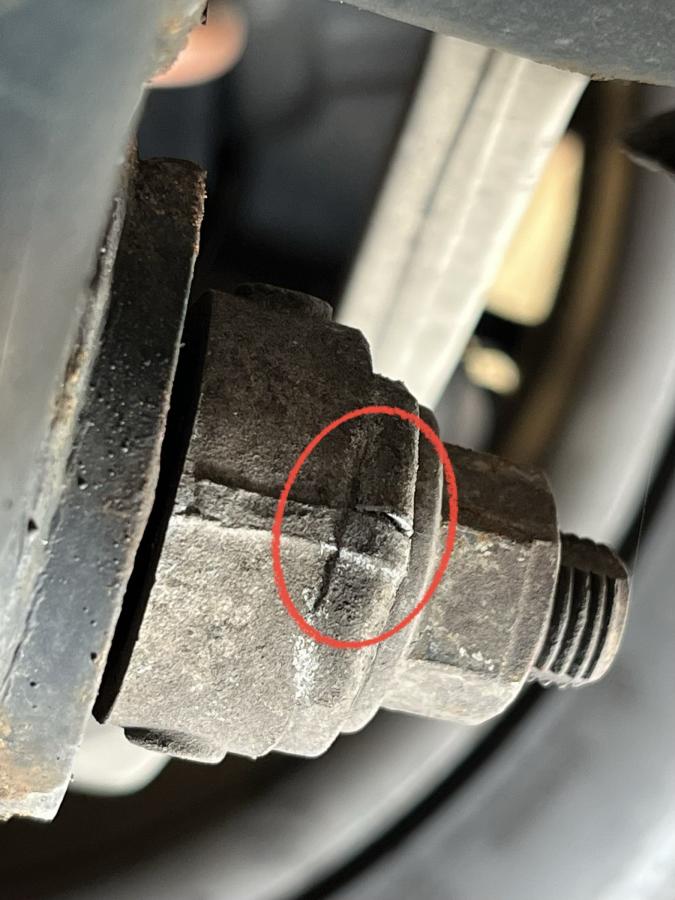

        One thing I had forgotten to post earlier: at least one of my original >154k mile camber arms (the ones the springs sit on) was starting to crack around the eccentric. I had almost regretted committing to replace these; they don't have bushings or ball joints in them, so the spend-on-parts-save-on-labor argument didn't apply. Guess it was good I did in the end.

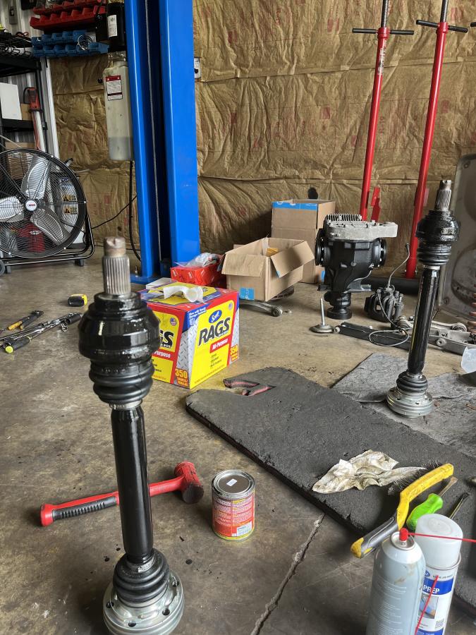

        CVs being refreshed with new grease and boots. Apparently the clamps on the outer boots were just a tad too small, so we had to find new ones. Not an expected problem for a refresh kit from GKN (the original manufacturer).

        Factory X-pipes: my old one (154k miles) on the left, new-to-me (~50k miles) on the right:

          Rear subframe with all new bushings and arms, ready to go in:
Name:	Subframe ready to go in.jpg

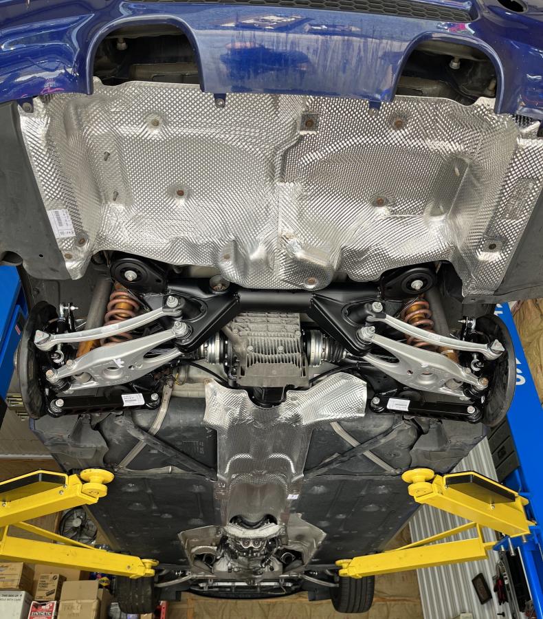

          All bolted in with the heat shields, diff, etc.:

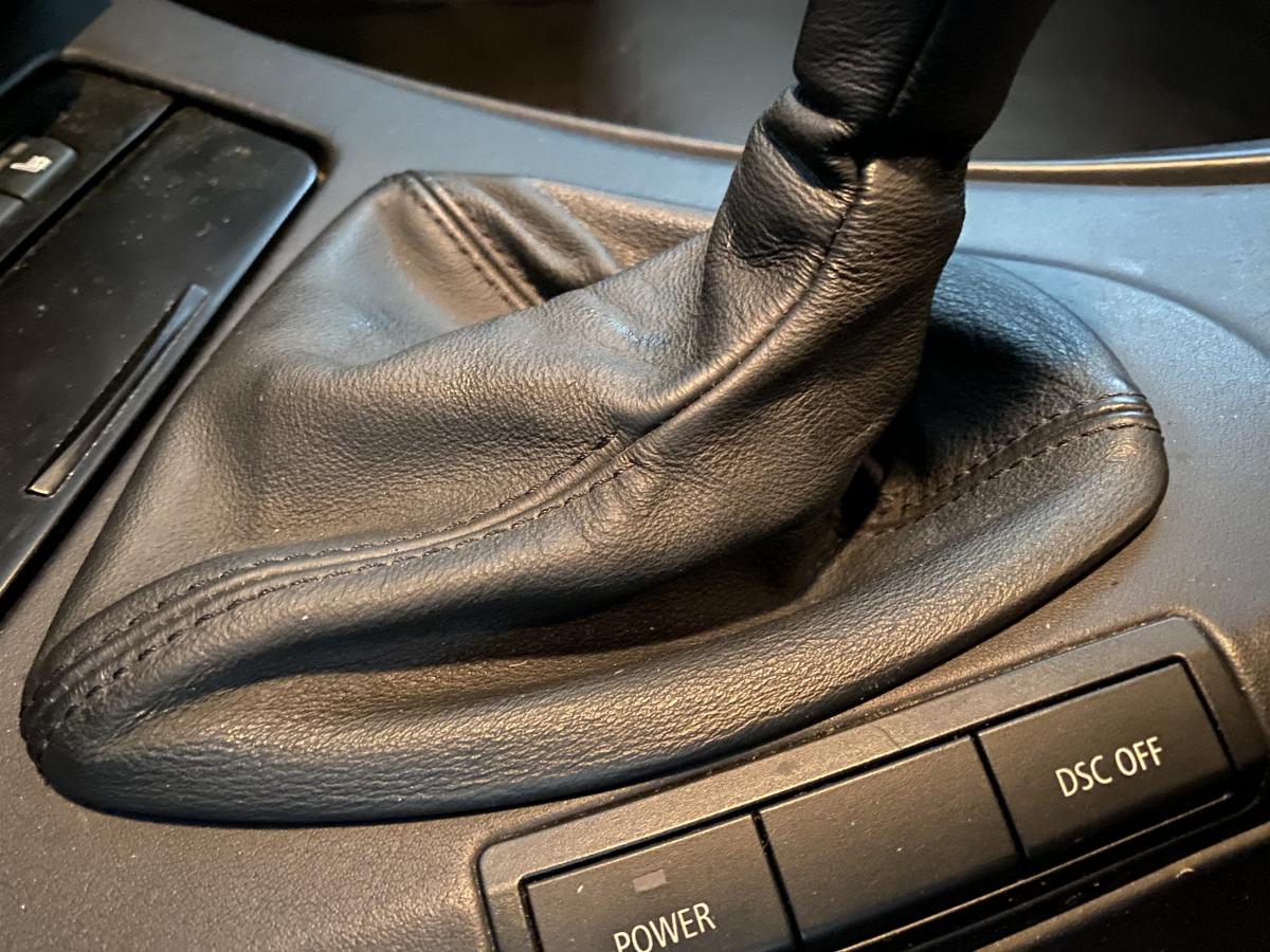

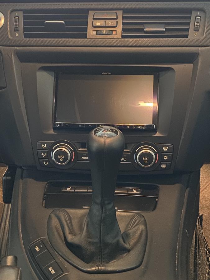

            Shifter height pics:
            Again, this is with a 40mm height extension and a 15% throw length reduction at the new height.
            Looks like the stock boot still had some slack, though not much. The 6th gear position leaves the least slack:
            So, probably could have gone with a 50mm extension as I had suspected, but probably not much more than that.
            I have a new stock knob/boot ready to go on at some point.

              The one outstanding issue is that ride heights are no longer quite what they should be; without having touched any height adjusters, the right front is 3mm higher and right rear is 6mm higher vs. before. Not gonna touch any adjustments now though in case things need to settle. Planning to revisit in early spring next year.

                ride height change is strange. I assumed he torqued all bushings fully preloaded?
                  Congrats! 🎉
                  Thanks!
                  As do I. 😬
                  I wasn't there to see, but from what I've seen he's not the type to screw up something like that (which is why I had him do the work).
                  Is it really that strange, though, with all the arms being changed? Gotta figure some of them were at least a little out of shape, right?
                        Nice work! I'm about to do the same. I have a valve cover leak which has made a mess. Going to get the front end done this Dec. Rod bearings, valve cover coating, OFH, new AC compressor, and a bunch of other things. Then the rear end March or April before it gets hot here in TX.
                        I had the same issue with the GKN kit for my E46. I wonder if GKN assumed the M axles are the same size as the non-M's. It was super maddening because it was off by about 1mm or less. I just bought slightly bigger ones on McMaster Carr.
