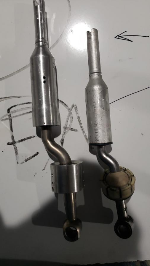

    My shift lever on the left, a stock one on the right:

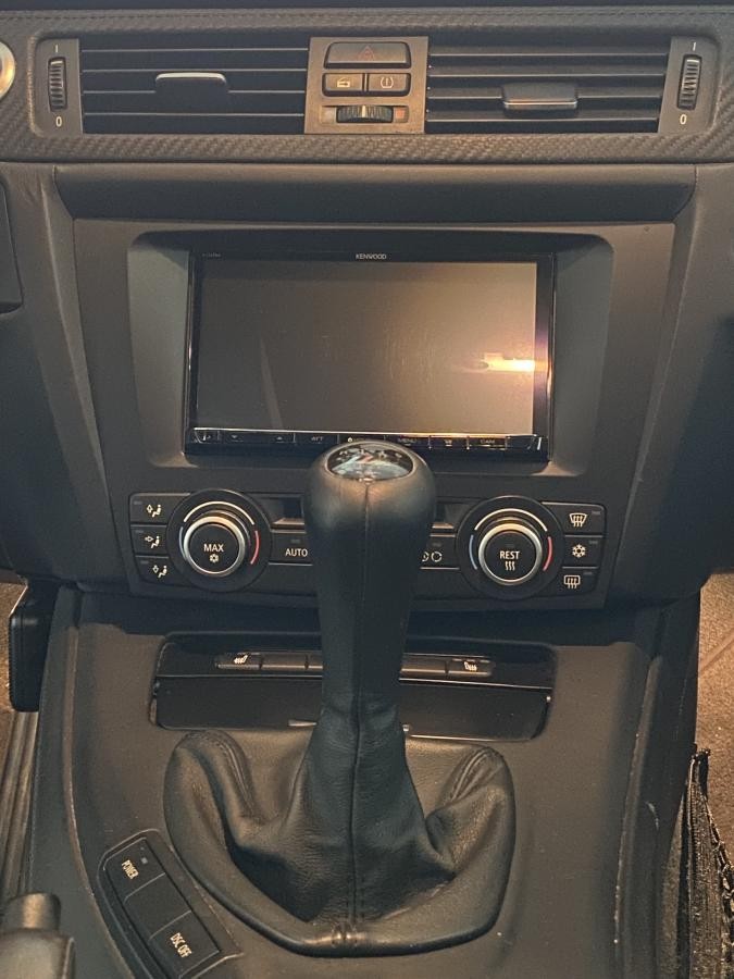

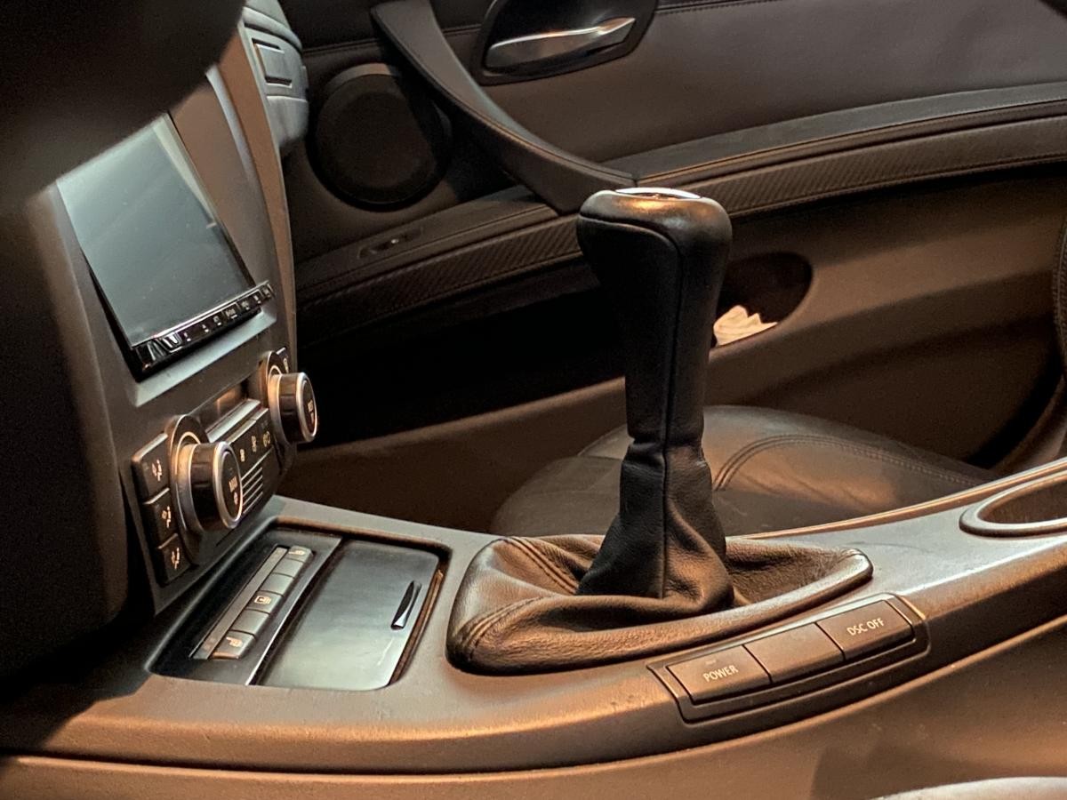

    Installed Pics
    ​Click image for larger version  Name:	fetch?id=232746.jpg Views:	3 Size:	184.8 KB ID:	232883
    Click image for larger version  Name:	fetch?id=232747.jpg Views:	4 Size:	104.9 KB ID:	232884​

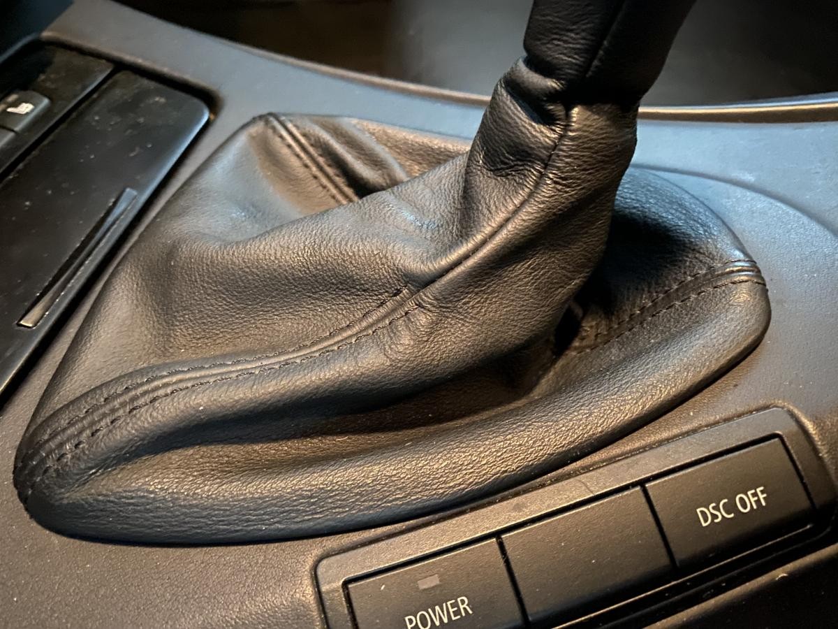

    The boot has the least amount of slack when the shifter is in 6th gear position. Looks like there's enough for an even longer lever, though not by much:
    ​Click image for larger version  Name:	fetch?id=232748.jpg Views:	3 Size:	264.9 KB ID:	232885

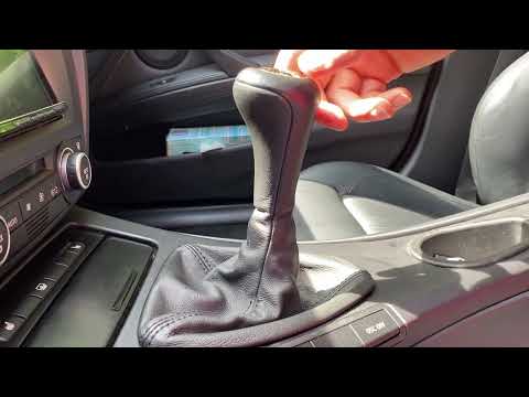

          You should make a video showing the distance between the gates.

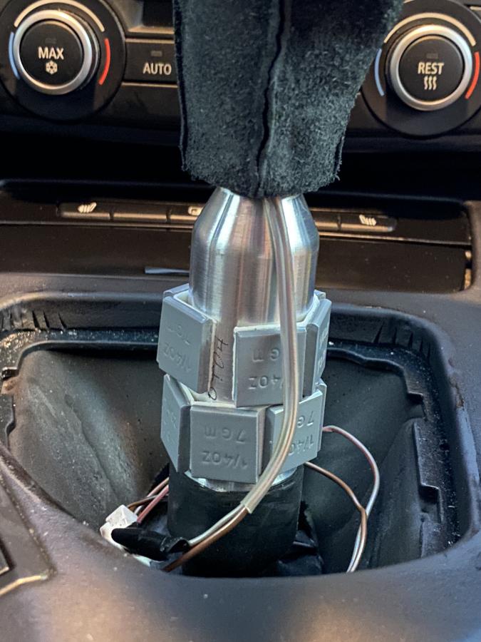

                  Tried the wheel weight trick to mitigate noise:
                  This didn't eliminate but did reduce the extra noise. Pretty cool.
                            Is this what you wanted to see?
                              Yes!
                              I wanted to see the travel between the gates and the ease of use.
                              Ofc while it's breaking in, it will get easier to use.
                              Looks good!
