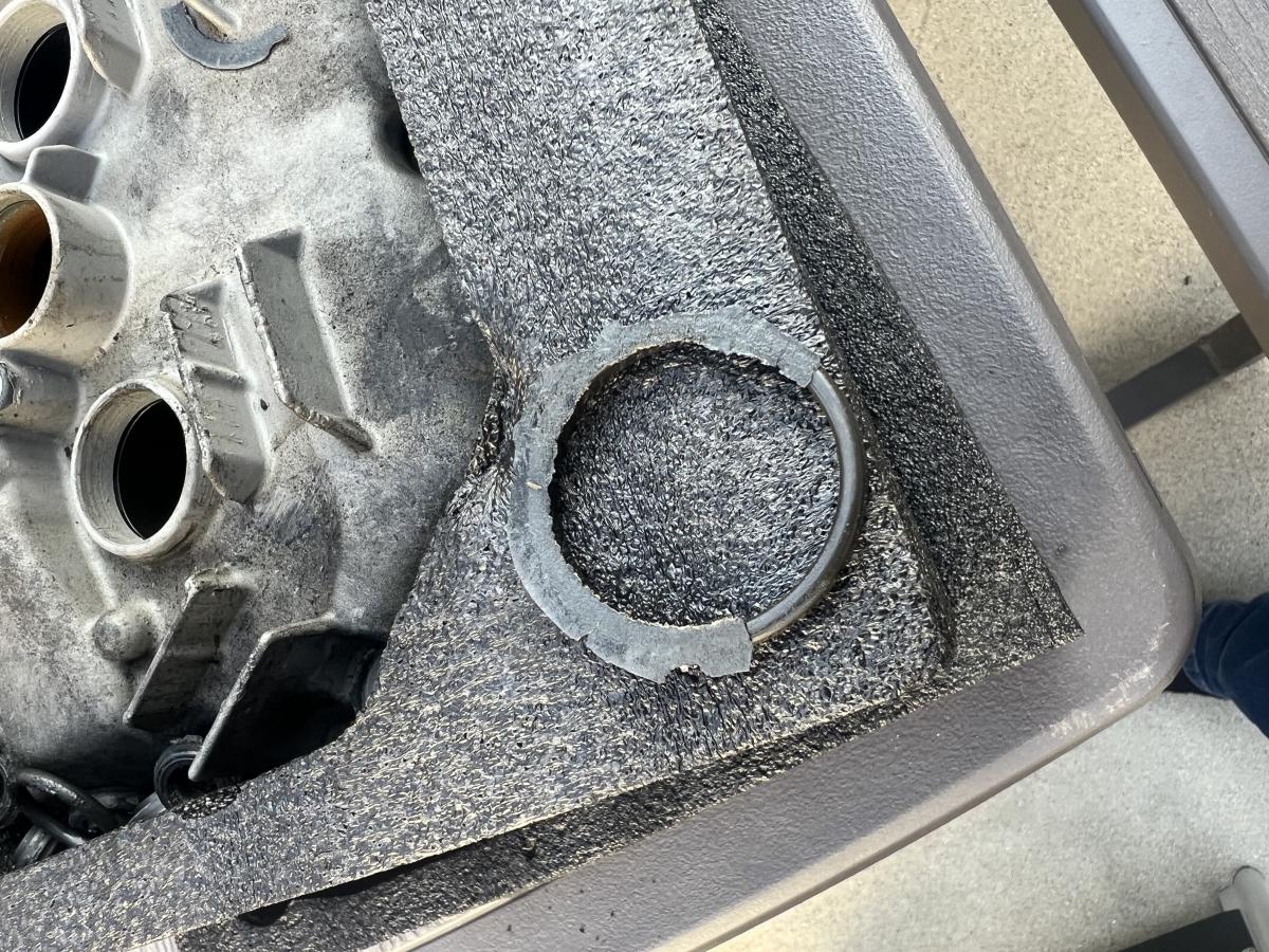

    attached, a photo of the “pcv” valve oring to the oem valve cover - as you can see this was most definitely not sealing properly as the epoxy paint used by bmw is trash.

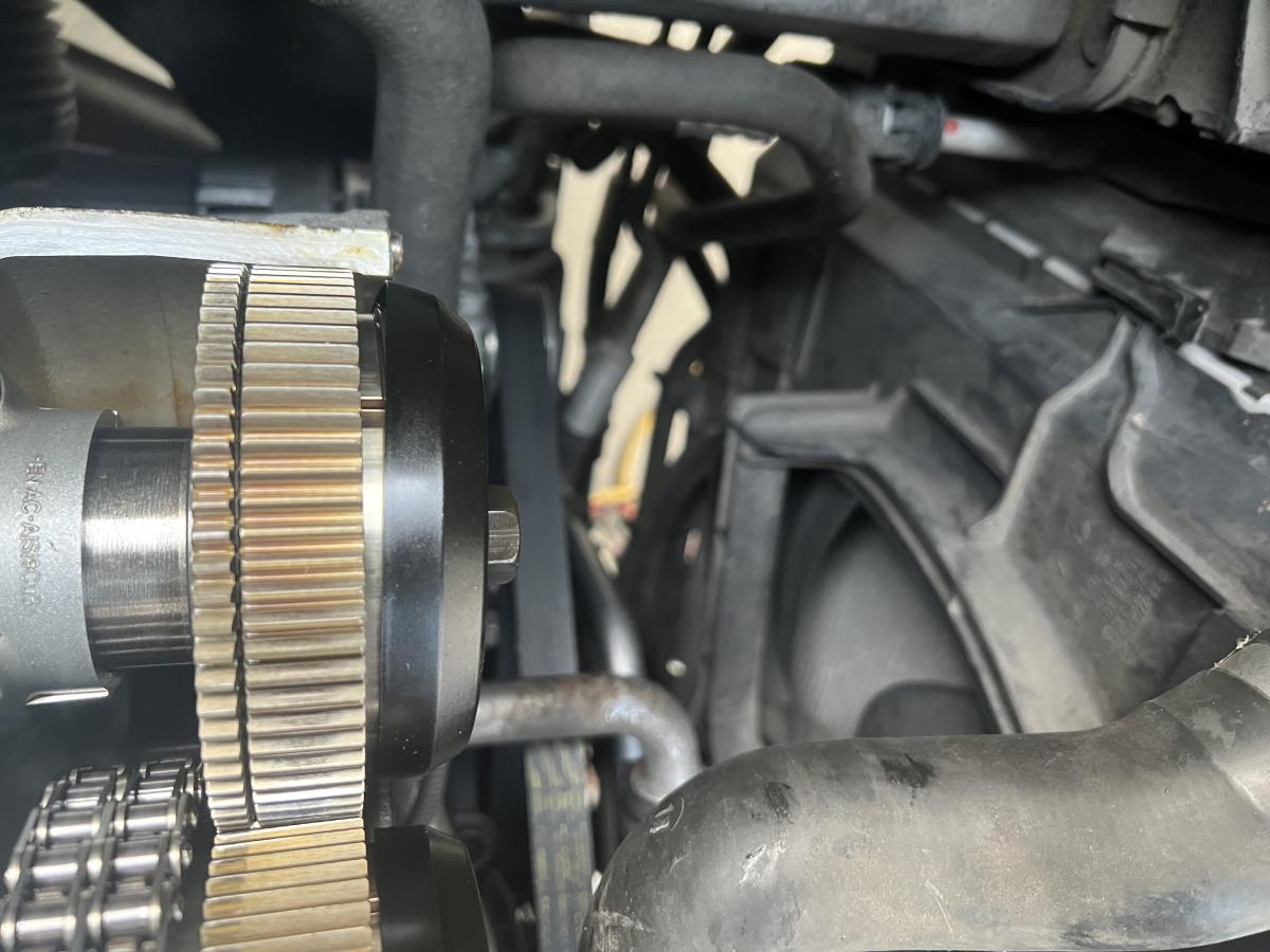

    Also, here is a photo of the oem plastic vanos covers at 66k miles
      Where is this o-ring located?

        From the oil separator that sits in between the valve cover and the intake plenum - there is two of them, one in each bank - i really dont suggest reusing the covers, if you must, find a way to repaint them, which technically solves the issue temporarily but it will happen again
