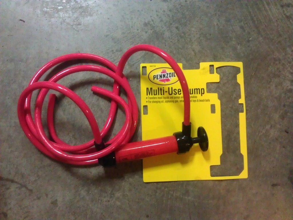

    Fluid pump
    [ATTACH]752242[/ATTACH]

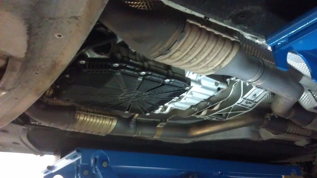

    1. Remove the protective cover under the transmission.
    [ATTACH]752244[/ATTACH]

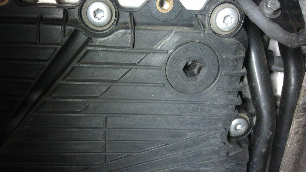

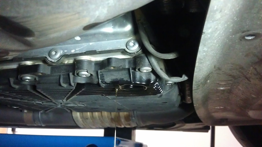

    2. Drain fluid by removing the plastic plug near the front passenger side of the transmission. Fluid can be extremely HOT! If your car was just driven, I would suggest waiting a few hours before draining the oil.
    [ATTACH]752245[/ATTACH]
    [ATTACH]752246[/ATTACH]
    3. Once the fluid drain stops, reinstall the plug. Torque to the suggested value listed on the plug.

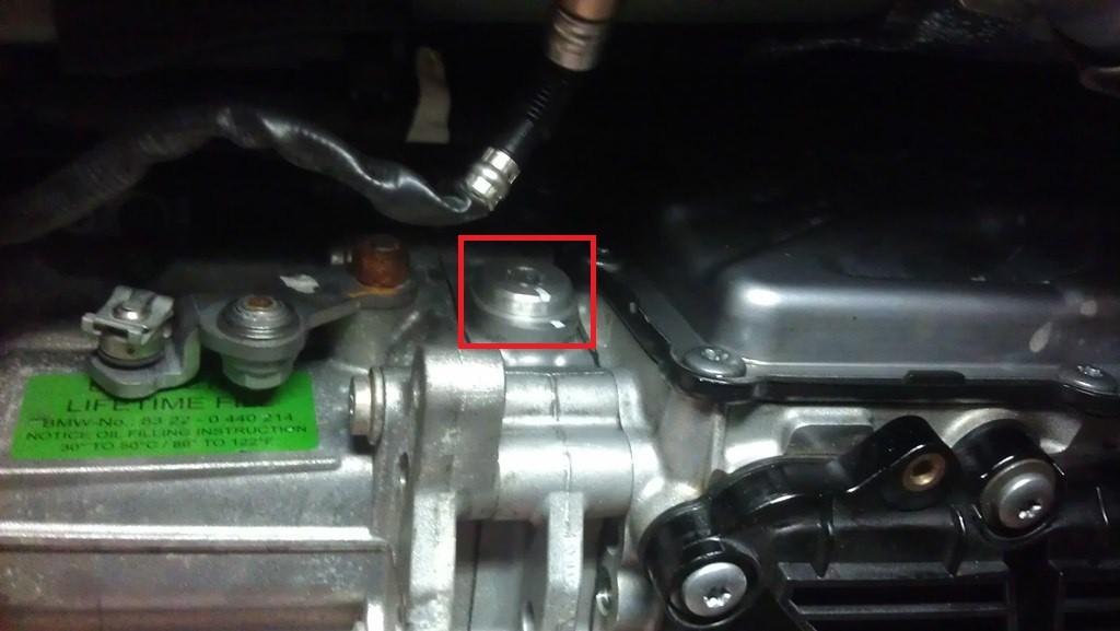

    4. Open the filling hole (red box). Using a fluid pump, add M-DCT oil into the transmission. I added about 3 quarts before fluid started to emerge from the filling hole.
    [ATTACH]752247[/ATTACH]
    5. Ensure that M-DCT fluid inside the transmission is below 90 deg. F. Then, close the filling hole.
    6. Turn on your engine. In position P, maintain 2000 rpm for about 1 minute.
    7. Reopen the filling hole and add additional fluid (about 2 quarts) until fluid starts to leak out from the hole again. This process must be completed while the transmission fluid temperature is below 104 deg. F.
