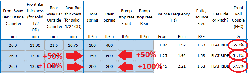

    Let’s say you stiffen your front and rear springs by the same percentage without touching the sway bars. The bars are contributing just as much roll stiffness as before, but stiffening the springs has raised total roll stiffness. This means the bars (and thus their forward-biased stiffness ratio) account for a smaller slice of that total, while the ride frequencies (and thus their rearward-biased stiffness ratio) account for a bigger slice. The net effect is a lower FRC %.
    You can see this if you tinker with a decent suspension spreadsheet. It doesn’t have to be E9x M3 specific. I like Fat Cat Motorsports’s Ride Harmony spreadsheets (E46 M3 version here). Make up some easy spring rate numbers as a baseline, and then increase the front and rear spring rates by the same percentage while keeping everything else constant. As you do, you’ll see FRC % decreasing.

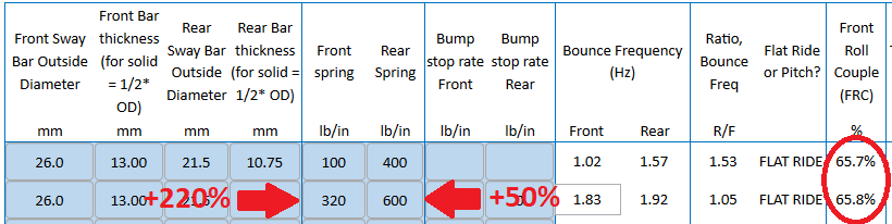

    However, if you increase spring rates much more in front than in rear, you can keep FRC % from dipping too low without touching sway bars:
    Click image for larger version  Name:	2.png Views:	3 Size:	11.6 KB ID:	49048
    Kind of looks like an E9x M3 coilover kit now, doesn’t it? (much bigger increase at the front than at the back)

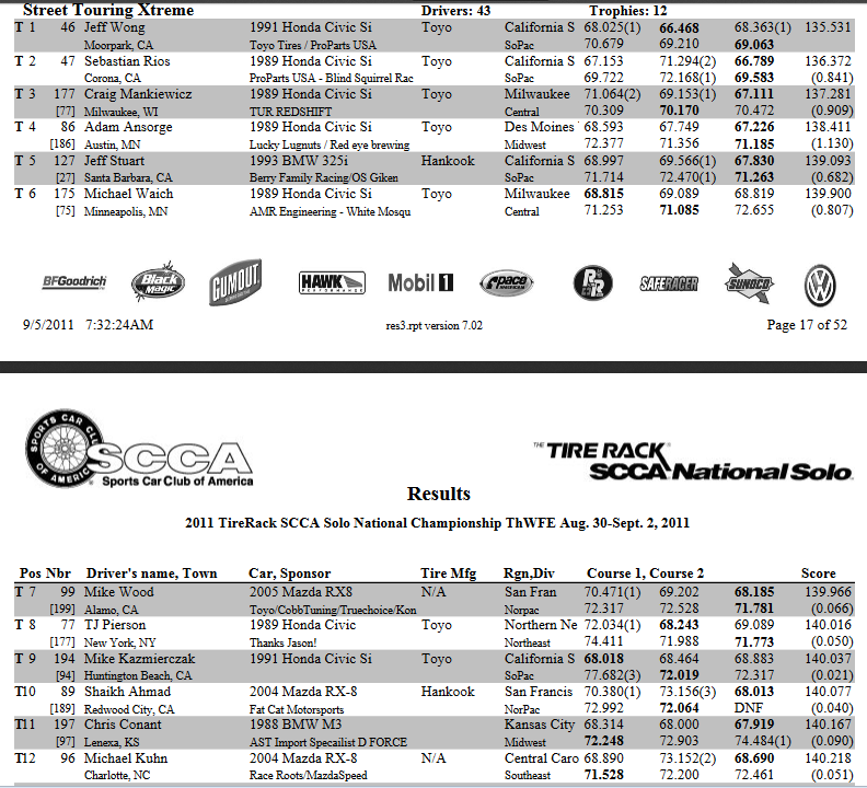

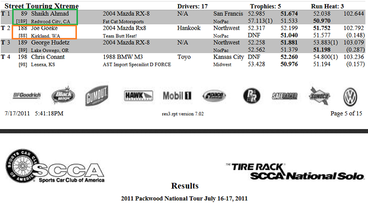

                          I won the 2011 Packwood National Tour in STX, finishing ahead of National Champion Joe Goeke.
                          Click image for larger version  Name:	Packwood_NT_2011_STX_results_Shaikh_Ahmad_win1.png Views:	0 Size:	165.9 KB ID:	51876
                          I then ran SCCA Solo Nationals and got my first Nationals trophy, finishing ahead of my customer in his FCM-designed Bilstein-based double-adjustable suspension.
                          Click image for larger version  Name:	FCM_ELITE_3240_NC_RX8_Front_DA.jpg Views:	0 Size:	74.5 KB ID:	51875
                          I was poised to do even better (backed up by the data acquisition) but a too-stiff left front bump stop made me push wide outside the timing lights on my last run the second day. That was the last time I neglected to fully account for bump stop stiffness variation front vs. rear!
                          Click image for larger version  Name:	SCCA_National_Championships_STX_2011_10th_place_trophy_Shaikh_Ahmad.png Views:	0 Size:	162.8 KB ID:	51877
                          The outcome of all that testing and evaluation and design was a deeper understanding of what kinds of actual DAMPER VELOCITIES exist even on a 'smooth autocross surface' (hint - over 40 in/sec is quite high!). Of how important having corner weights is, of matching ride frequencies left-to-right, of using Flat Ride tuning, of minimizing gas pressure, of having sufficient bump travel, of how to TUNE WITH BUMP STOPS effectively instead of omitting them (as many setups unfortunately do), of how important REDUCING HIGH SPEED damper force was to maintaining grip and compliance over broken surfaces.
                          I had learned a lot from the 2008-2011 period when I was actively involved in SCCA National-Level autocross. I took the successes and lessons to go back to the drawing board and ask 'how do you REALLY make a car faster, grip better, win races?' The answer wasn't MORE KNOBS, but more sophistication of how the damper and the suspension AS A WHOLE responded to the road, to surface imperfections, etc.
                          Essentially, through my own adventure of building my own multi-adjustable setups, I found the KEY was understanding exactly HOW to build tire grip without worsening compliance and upsetting the chassis. The actual science of building grip and control, without going overboard on the latter.
                          This involves taking a much more detailed, methodical approach to the ENTIRE suspension instead of throwing a couple adjusters on a set of shocks and saying 'go have fun!'
                          In 2013, I got very curious about Penske's regressive valve for Formula 1. I studied that and decided it made GREAT SENSE! So I designed my own blow-off valve for Bilsteins. That's the KBO (Kerb Blow-Off) and I've been refining it through 9 iterations now (stabilized for about 3 years).
                          In 2014 I got more into off-road vehicle, and that's when Ripple Reducer was born - something off-road racers have done for years. Other companies don't use this technology on road-going cars, but they could if they wanted to or understood it.
                          Through all of this testing, racing, experimentation, working with customers, I discovered you MUST get the BASELINE valving correct. When you do that, the knobs are beyond unnecessary - they DETRIMENTAL to the goal of maximum grip!
                          Having a knobs FORCES the damper to build MORE high speed compression slope - and then needing ANOTHER knob to try and compensate to 'blow-off' the high speed force.
                          Watch 3-5 minutes of this video (time stamped to the most relevant portion):
                          The use of an adjustable shock shaft FORCES the damper to build MORE force which you DO NOT WANT to get the best bump compliance.
                          I really hope you guys can deprogram yourself from the marketing-promoted idea that knobs are somehow actually really important. If someone wants to do a phone interview with me that I can record and post, I'm happy to do that. Bring your questions, even as a two-person conference call, and let's put some actual data and information together to illustrate how a suspension really work vs. what marketing departments want to tell you.
                          Or, just call Anthony Zwain at Edge Motorworks Fremont and ask him why they NO LONGER recommend MCS or anything else for their race cars - they only use FCM Elite Stage 3 setups - and ALL the setups we build for them have NO KNOBS! They work at ALL tracks, wet or dry. That's called intelligent design, my friends! Truth over Marketing!
