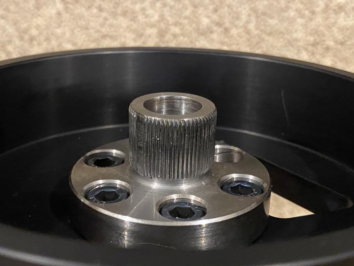

    Anyone ever use this, or something like it? Strongly considering buying one.https://nam3forum.com/forums/forum/e...0956#post90956
    https://www.spacershop.com/prodotto/...w-serie-3-e90/
    EDIT: Installed! https://nam3forum.com/forums/forum/e...1152#post91152

      I could use one, like yesterday. Just concerned because the steering column is safety critical, so I'm hesitant to use parts without a known rep. Also wondering if there might be implications for airbag deployment; isn't it timed according to seat position?

          Turns out the guy who makes these is an E46 guy. Also found out a friend of mine has one of these for his truck and likes it.
          Looks like a good piece. Will post my review whenever it gets here (no ETA yet).

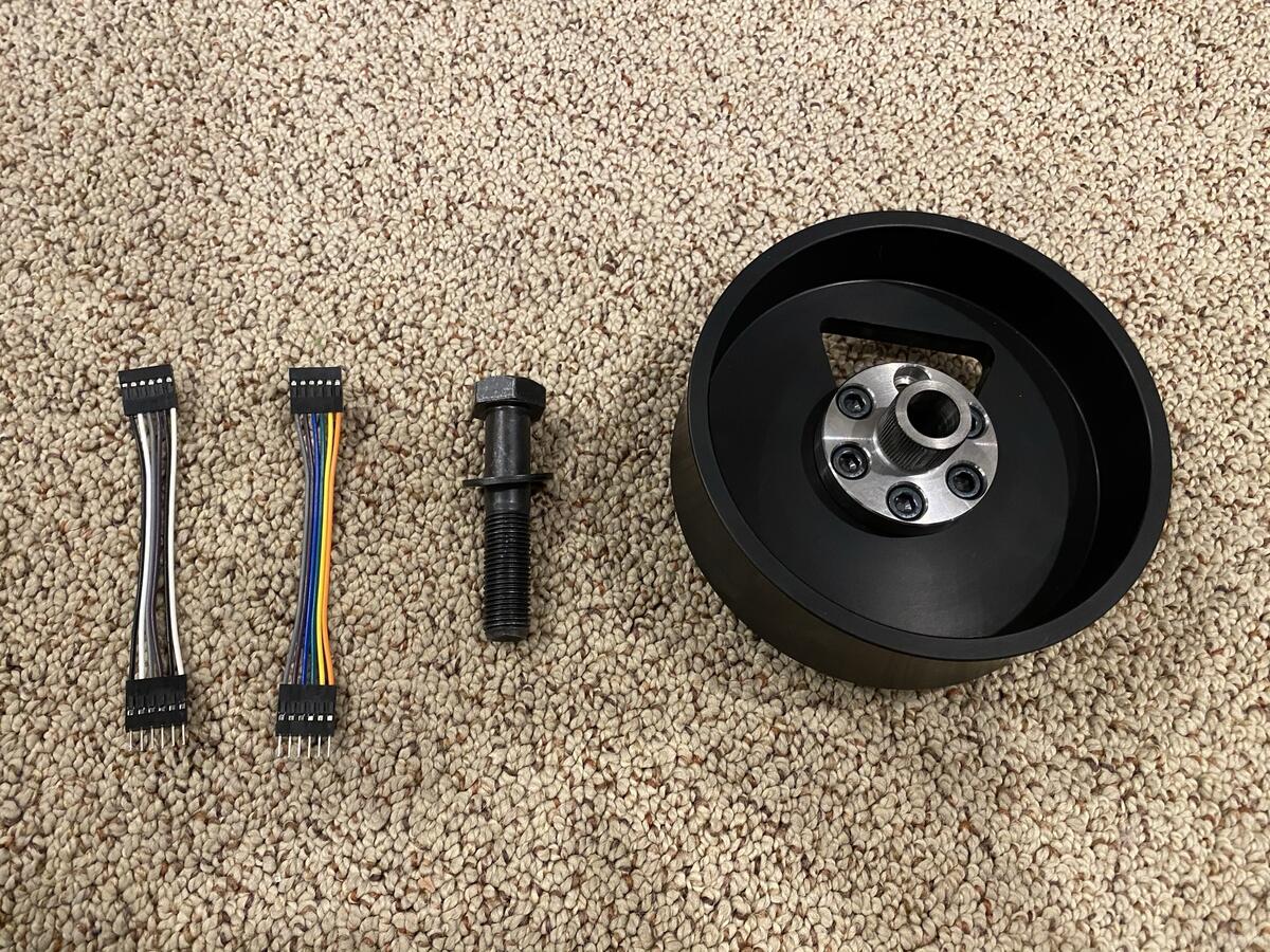

            Looks like a decent piece. Wiring extensions for everything but the airbag, which supposedly has enough slack stock. That last part sounds like famous last words, but I've heard good things about this guy. Hoping to install soon.

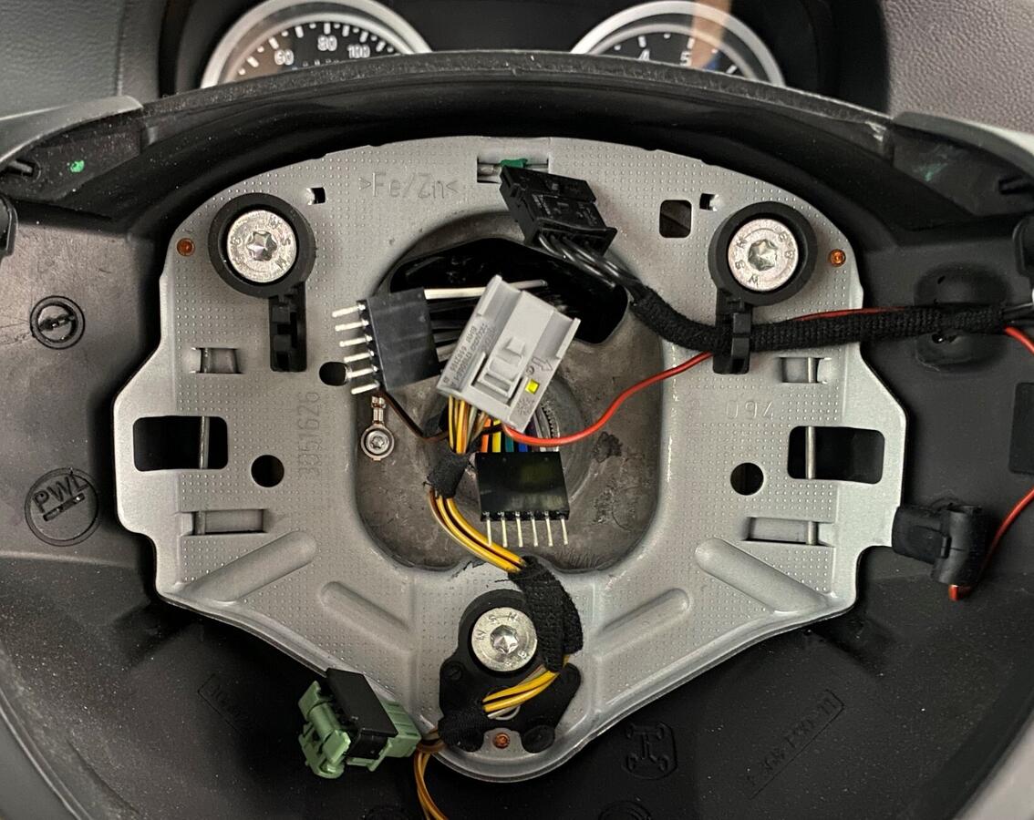

                Well, it's in. BLUF: 9/10 mod. Minor gripes but well worth it. Wish I had had this a long time ago.

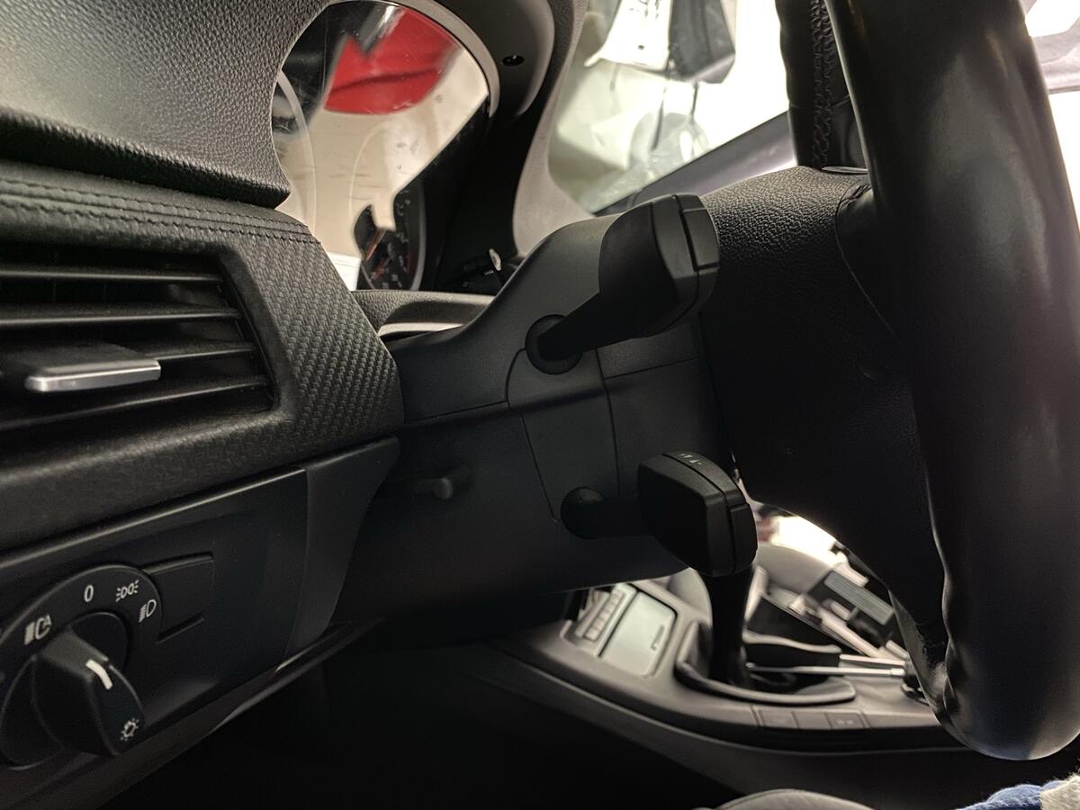

                Before:
                Click image for larger version  Name:	IMG_7151.JPEG Views:	0 Size:	106.6 KB ID:	91159

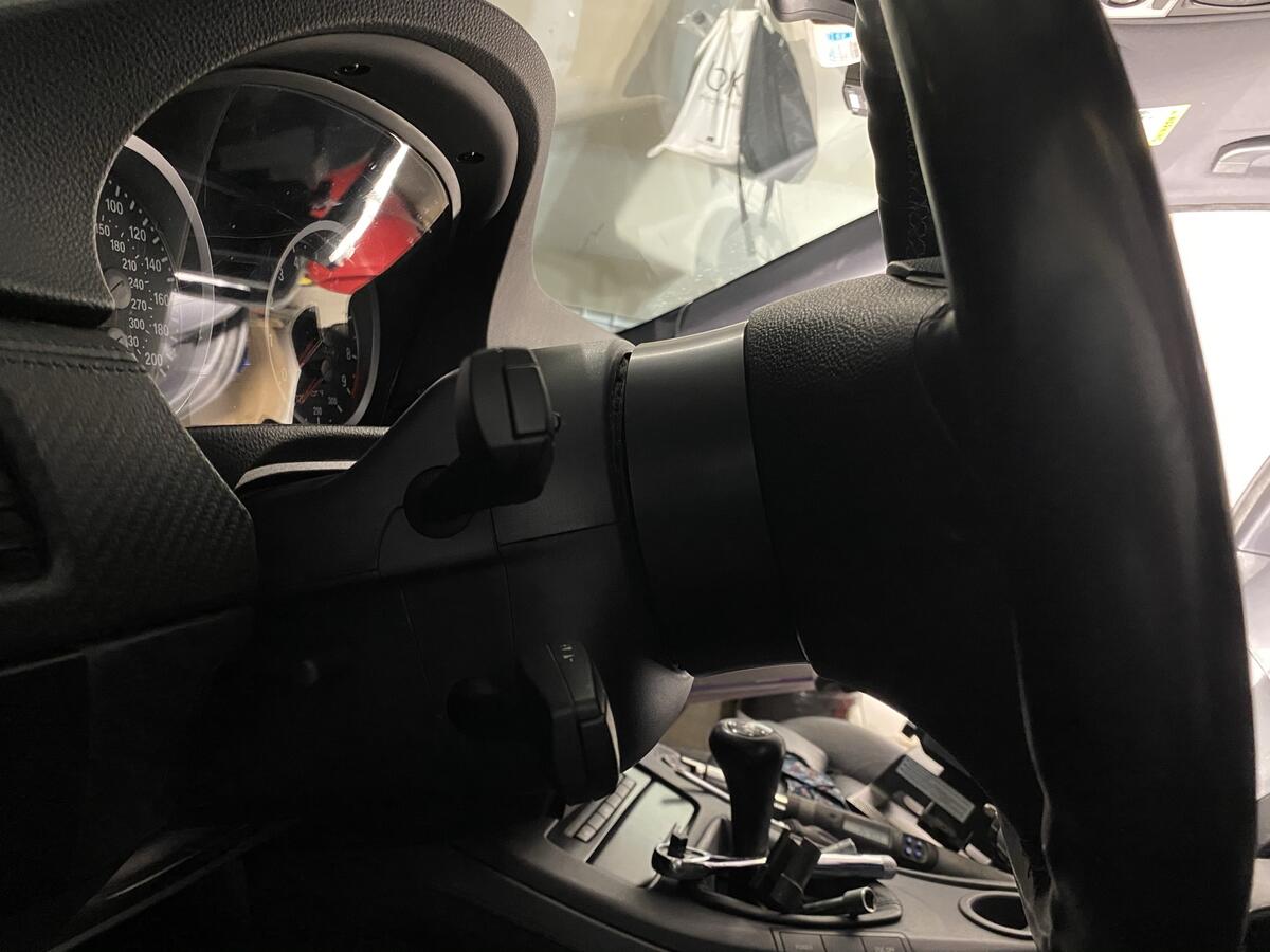

                After:
                Click image for larger version  Name:	IMG_7158.JPEG Views:	0 Size:	92.6 KB ID:	91158
                The spacer itself is 42mm deep; I think it might add a mm or two more than that because the gap behind it looks slightly bigger than before.
                I'm sure the distance between the wheel and the stalks will annoy some. It's a big asset for me because I've wanted to break my habit of using them without taking my hands off the wheel.

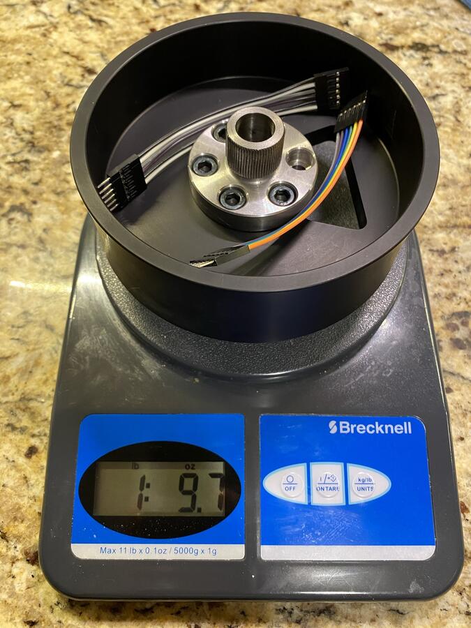

                Obligatory weighing:
                Click image for larger version  Name:	IMG_7149.JPEG Views:	0 Size:	94.7 KB ID:	91154
                Not gonna do a full DIY as there are plenty of steering wheel DIYs out there. However, I do want to highlight a couple of tips/issues.
                For the install, I found it easier to connect the wire extensions to the clockspring first, then install the spacer onto the steering wheel, and then mount the wheel while threading the extensions into it. Result should look something like this:

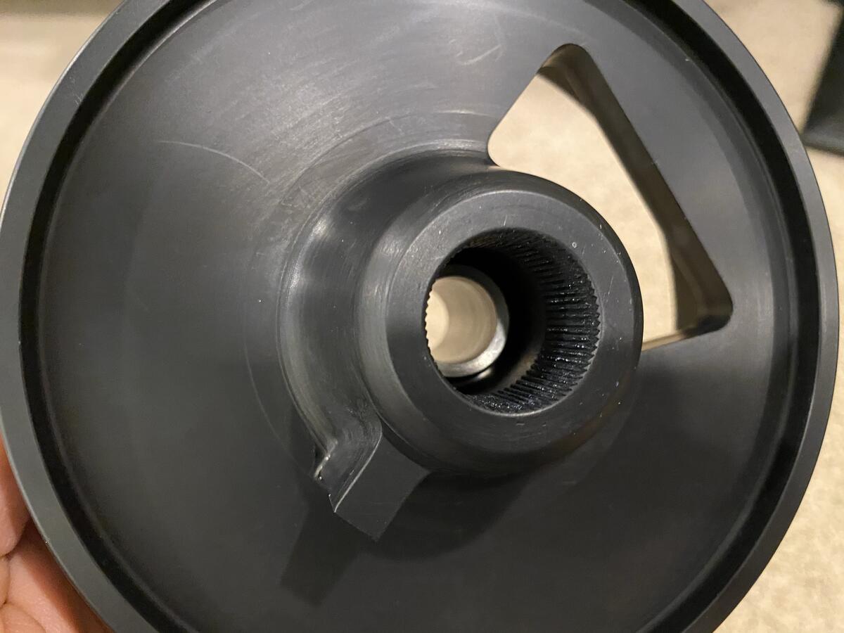

                Without the main bolt in place, the amount of play in the assembly is far more than without the spacer. Not sure what that means, if anything. Fortunately, the bolt takes all that play out.
                The included bolt has a 22 mm head, which is bigger than what comes off the car.

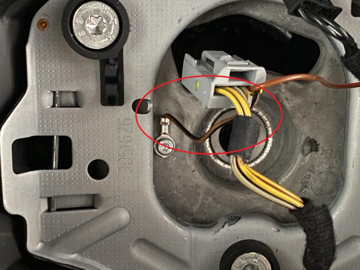

                Turns out my "famous last words" worry was correct. This wire (circled below)...
                Click image for larger version  Name:	IMG_7154 - Copy.JPEG Views:	0 Size:	141.6 KB ID:	91157
                ...was not long enough to allow the airbag connector to reach the clockspring through the spacer. I've emailed the manufacturer about this. In the meantime, I (reversibly) extended the wire for now. Will be seeking a better solution, or at least a better implementation of my extension.
                Result: I finally have my steering wheel position more-or-less where I want it. It's so much nicer to use now, and that niceness is multiplied by how important steering is to the experience of a car. For anyone driving with more arm reach than they'd prefer, I strongly recommend this mod.
