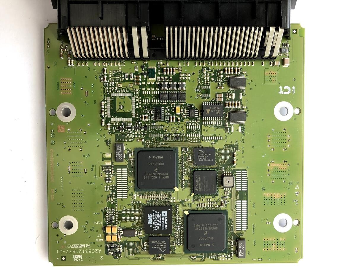

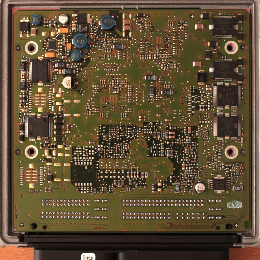

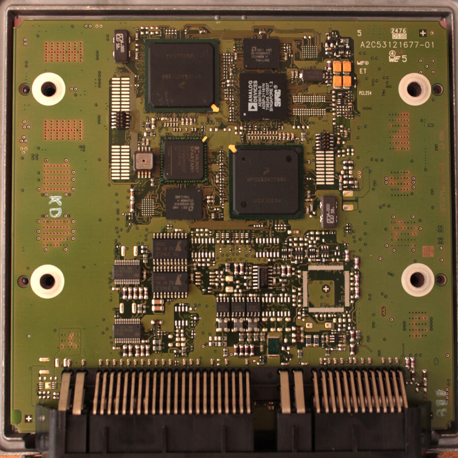

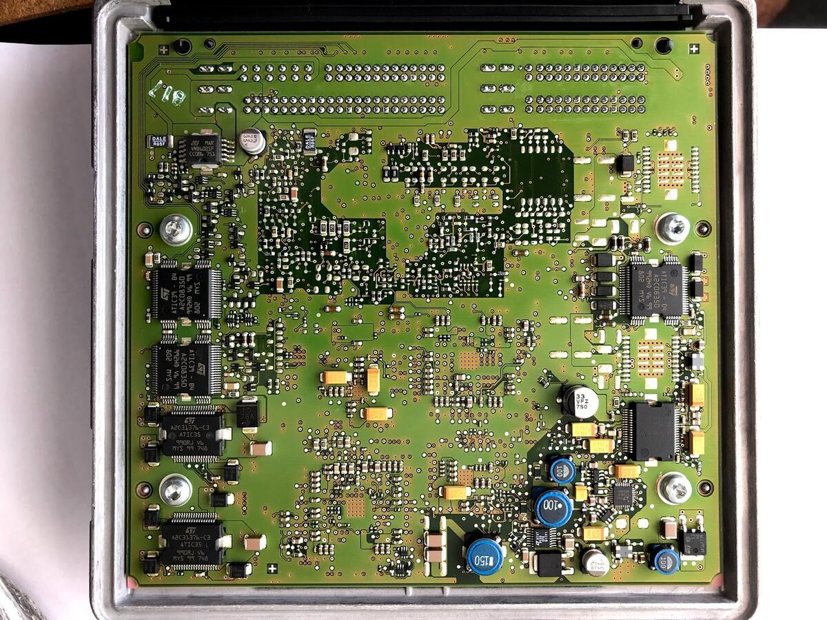

Edit: In the interest of open information sharing, added some highish resolution images of both sides of the MSS65 board. Can zoom in on any relevant bits once when I see some MSS60 bits to compare
Edit2: Of course the forum resized the pictures.

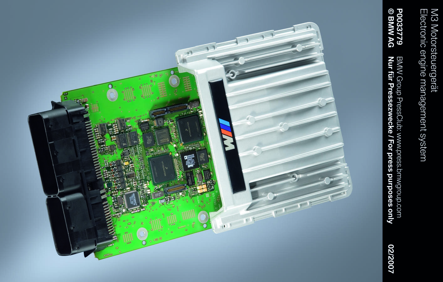

Edit 3: Here's a BMW press photo of the MSS60. Clearly has more components, but it's also clearly a dev board based on the populated BDM/JTAG headers. So it's hard to say how much is necessary without seeing a production board.
Edit 4: Attached the differences I could spot with the chips identified. I think it's safe to say the ethernet is not needed on a production board. Hopefully all that extra RAM was primarily for debugging as well. The other stuff could go either way. Extra CAN tranceivers could be for debugging or could be for some E9x specific equipment. For the LIN tranceivers, at least one of them should be for EWS4 comms. Not sure about the other. Oddly they used 2 different brands on the same board. Don't know about the OP AMP.

On a quick glance it looks very similar. Only major difference I see is that the MSS60 has the LIN/K-bus tranceiver installed (for EWS4 comms) and is missing the comparator IC that the MSS65 has for receiving the EWS3 message. Might well be feasible to use the MSS65 as an MSS60 in that case.
I suppose it's possible that Xilinks FPGA is programmed differently and such - I don't really know what its function is. Based on positioning, my guess would be coordinating communications between the two CPUs.
Edit: Okay on the back there's a bunch of tiny components missing on the 65 near the bigger connector. Then on the front there's a component and some caps near the same connector - not sure what the function of any of that stuff is. Doesn't look terribly difficult to solder (nothing BGA), but identifying all those components will be a pain.
