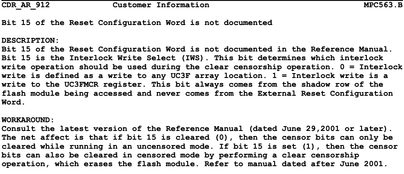

                    You'd probably know this. Am I correct in assuming that setting the censorship mode while IWS = 0 means the MCU is forever stuck in censored mode?
                    If so... oops
                      As far as I can remember, there’s nothing irreversible about this MCU but I haven't worked on this MCU for a long time.

                        Basically I was messing with the censorship states on my MSS65 which by default has its UC3FCFIG as 00000000 instead of 20410000. The clear censor operation requires being able to do an interlock write, which with IWS 0 means writing to the main UC3F array. And if that's in a censored state, the DME is stuck. And interestingly this seems to have also made it that I can't even trigger an erase or write while the DME is operating. So this thing is basically stuck in stasis.
                        The reference manual glosses over it, but freescale's extra documentation does support this.

                        But on that note, I can confirm I have been able to clear censorship mode using the USBJtag NT device. Just need that IWS bit to be set to 15 if erasing the censor registers while in censored mode. I'll write that up and some scripts soon​
                          So this whole fiasco made me look into the DME's censor routines a little closer. If I'm reading this correclty, the MSS60 won't censor itself if IWS is set to 0 -- presumably to avoid the issue I ran into above. Could explain why early MSS60s weren't censored despite the code being present as far back as 060E. If the shadow block on the early ones was set to 00000000 like the M5, that would skip the censor routine. Risky to test though since if wrong, then the DME is theoretically permanently stuck in censored mode.

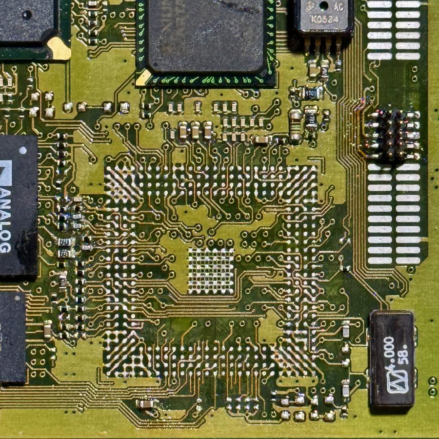

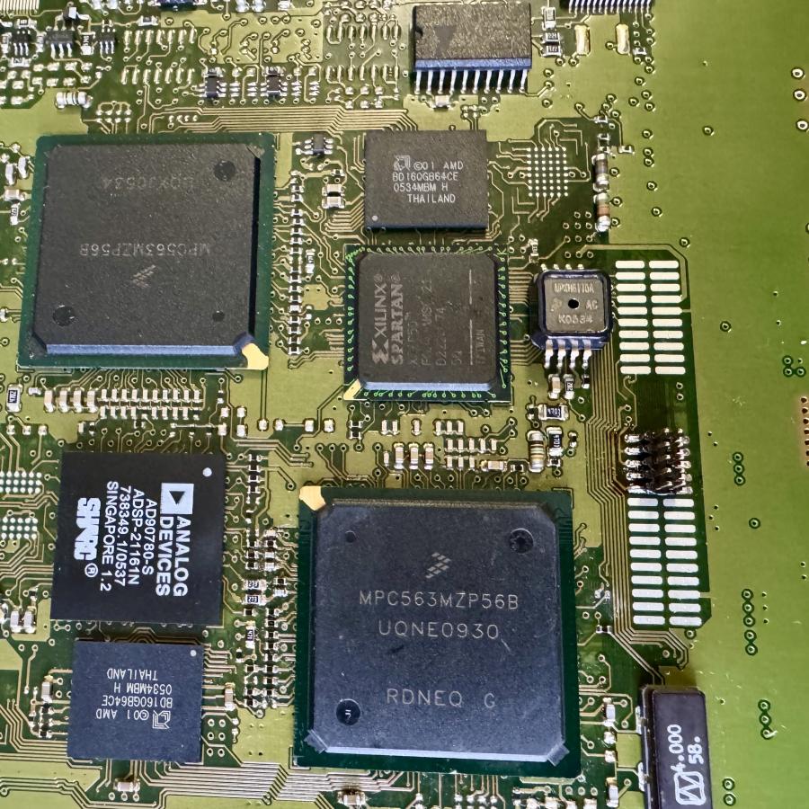

                            I don't know 100% if I trust it in a car between doing this by hand and using a gray market Chinese and probably secondhand MCU, but I did manage to replace the MCU. Seems to be functional. Sadly can't really get MPC563s from reliable sources anymore. MPC564 is likely compatible and does appear to still be sourceable, but minimum order quantity I could find is 200 units. Brand new would also likely be the C revision instead of the B revision, and I'm not sure if that would cause issues. I also did see some code that seemed to imply an MPC565/6 might work appropriately too. Those actually can be sourced, but are expensive enough that you're probably better off getting a new DME anyway
                            Click image for larger version  Name:	B418102C-8488-4CC5-8890-E5F11721A391_1_201_a.jpg Views:	0 Size:	215.1 KB ID:	350598
                            Click image for larger version  Name:	CE197D51-67AA-4B6D-BA4E-BA89C9111597_1_201_a.jpg Views:	0 Size:	187.4 KB ID:	350599​​
                              What tools did you use to do that? You are a badass
                                I used a cheap PCB heater similar to this one https://www.amazon.com/Preheating-El...dp/B0CFTZKYTB/ and a heatgun. Basically preheated the PCB for a good while, then blasted the MCU with hot air until the solder loosened up enough to lift the CPU. Cleaned up the pads with a few passes of solder braid (and I made a few passes beyond the above picture). Cleaned up the area well with alcohol. Applied a thin layer of flux to all the pads. Lined up the 'new' CPU as close as I reasonably can, and then heated it up with hot air. BGA is more or less self aligning as long as you're close, and you can kinda see it drop into place as the solder melts.
                                All in all seems like the solder lined up and melted pretty well. Bench stuff seems to work fine. TBD if everything would work as expected on a real car

                                I didn't harvest an old CPU myself because said CPU would need to be reballed, and that adds a layer of complexity to the project. If I were doing this professionally / more often, I'd probably get a better board heater, use a real hot air station (I do have one, but not quite upto the task for larger devices), buy / build a proper reflow oven, and setup to reball old CPUs.
