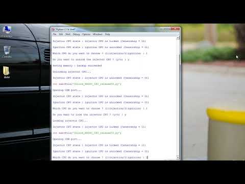

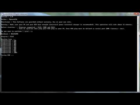

I develop a new MSS60 program and a Python script to unlock via OBD the BDM access to the injector CPU memory. They also allow to know if the injector CPU is BDM locked or not. The program can be written with MSS6x Flasher.
Don’t know yet what I will do with them. The program is finished and released but the script is just a prototype.
