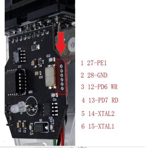

                          anyone have the pin order for this board? its sold on amazon by OHP tools

                            Got a response from the manufacturer, but it looks like these pins are mapped to completely unrelated pins than the instructions.

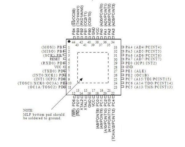

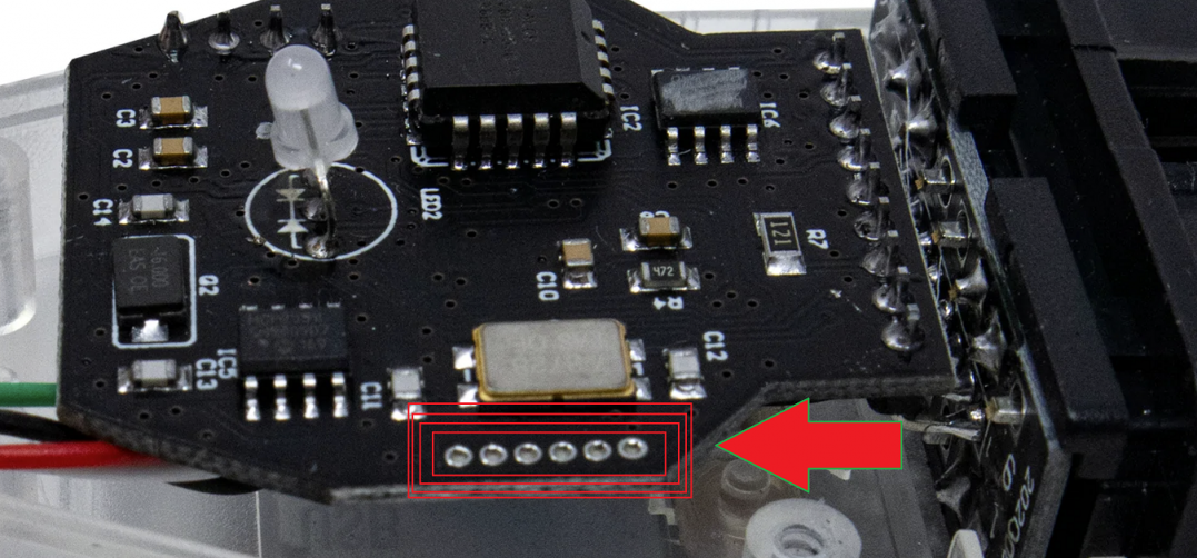

                            If I were to connect directly to the miso, mosi, sck etc pins directly on the pins on the chip itself, would that work?
                            Click image for larger version  Name:	C5641EB3-B054-48FB-A9D2-290CF81DDFCF.jpg Views:	0 Size:	49.3 KB ID:	194466 Click image for larger version  Name:	92A2F45B-7B4E-4311-A10A-B22417EF9E1F.jpg Views:	0 Size:	57.6 KB ID:	194465
                              Too much work, all those pins are relocated to the 6pin header. Just use a multimeter and trace it. Forget what the manufacture supplied you, the pin count it's easy enough to determined it using the atmega datasheet.
