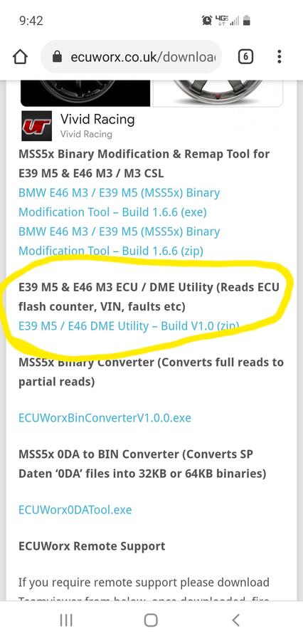

If you don't want to figure out how to load INPA as suggested above Martyn's (free) "DME Ultility Tool" will read codes/read&reset adaptations, you just need a laptop and a KDCAN USB cable and basically zero computer experience.

Get this one.
The ONLY thing you must do besides getting the free program and cable is to set your USB cable to "COM1" and the lowest "Latency" available, its easy and I can help you.
You do this through device manager on windows, if you need help either watch a YouTube video or list what version of windows you have and I will tell you how to set up your USB cable.
Edit: If you want INPA, download "standard tools" from here and follow instructions. It isn't very difficult, you will also then have other programs like NCS etc, but forget that, INPA is your diagnostics.
Also, if buying a laptop make sure its running Windows XP, 7 or 10, I personally run Windows 7 32Bit for INPA/ISTA/DIS but these will work on other versions. Basically just don't run windows 8.
If you don't want the chance of frustration just get the free software at ECUWORX, USB cable (recommend bimmergeeks pro, yes more $, any KDCAN will work) then "set up" the USB cable for COM1 and lowest latency.
