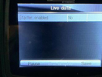

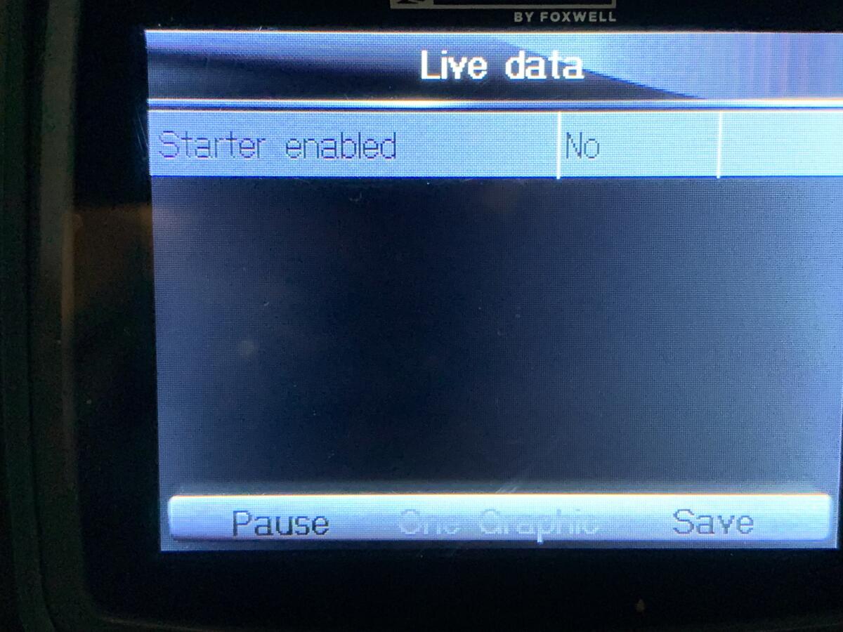

    I have a No crank no start issue.
    All the usual suspects were looked at.'
    The ews module showed a voltage supply problem.
    Live data showed that the starter was "not enabled" and "starter disabled due to P/N....(park neutral)
    For some reason the car started and was driven to the dealer for the ews replacement and synching.
    24 hours later we have a no crank no start with the same error messages except the ews is fault free.
    looking into the P/N reveals a gear identification switch on the driver side of the gear box.

          Code reader says the starter is not enabled. It says the starter is disabled due to P/N.

                  I had the ews module replaced by the dealer, and had the keys synched to the new module..
                  on the reader;
                  keys are good on all fronts
                  ews throws no codes but is being directed to immobilse.
                  dme has no codes.
                  new starter
                  new ignition switch.
                  All fuses are good for the four locations.
                  relays tested good.
                  The only other faults are a dodgy rear trunk motor and the telematics...phone antenna.
                  the two immobiliser faults.
