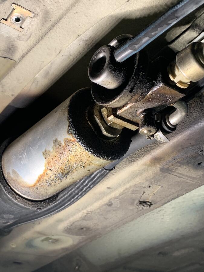

              Quick update:
              fuel filter definitely had a role in the fueling issue, lol
              20 years and 150k miles later

                Prolly weighed 10lbs
                    Lol probably did. If only I had the same attention to cleanliness as you do 😂

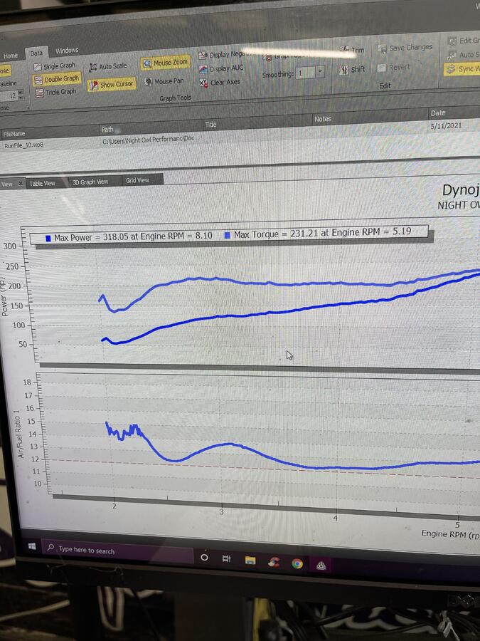

                        Figured I’d give a quick update here.
                        Car has great compression, and have since replaced my fuel filter, converted my EKP to a traditional fuel pump relay, and had my injectors cleaned/rebuilt as needed.
                        Retuned by HTE, car is now putting down 318 whp and 231 wtq.
                        Definitely an improvement, and glad Hassan was able to make his magic happen.
                        Currently trying to find a way into a SS V1 set up, and will retune the car again with that new setup.
                        As for now, car is running like a dream, completely linear power band, and is a blast to drive. Thanks for all those who gave their input and experiences!

                          Just curious, are you hoping for substantial change going to SS v1 headers?

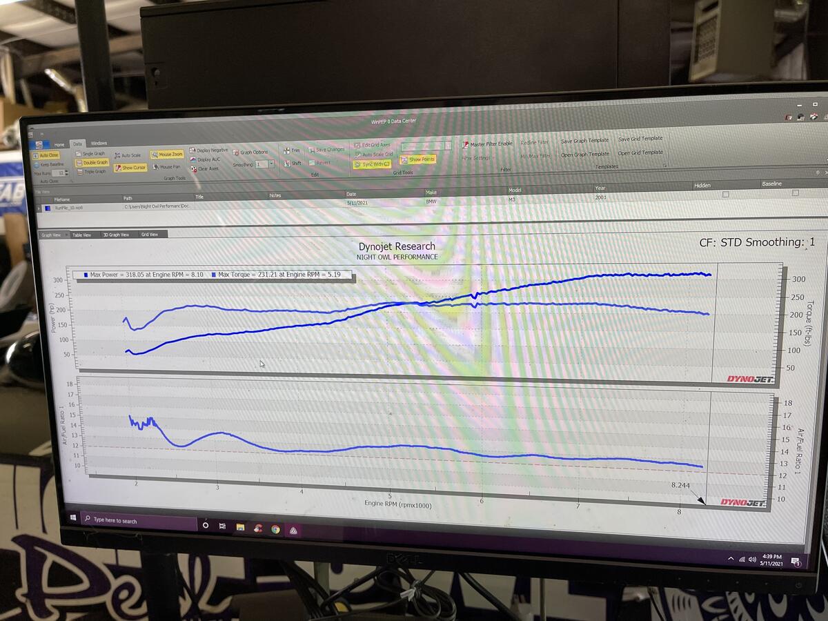

                            what's with half a dyno graph? lol. i thought we were beyond look at a peak numbers alone.....
                            to me it still looks like AFR is still trending north of 13:1 but without the graph cant see how lean it gets. Nevertheless the SSV1 should make a big difference as the torque is fairly weak (likely due to the ARH) and we will get a another data point of SSV1 vs ARH so we can bash some more products
                              Yeah, ARH have absolutely no low end torque. On top of that, I have a bunch of mismatched exhaust parts so the diameter throughout the system is so inconsistent, I imagine it also plays a big role in that.
                              Here’s the whole graph. We got it much closer to an acceptable AFR, and we decided to call it there seeing as how many runs we ended up doing that day.
