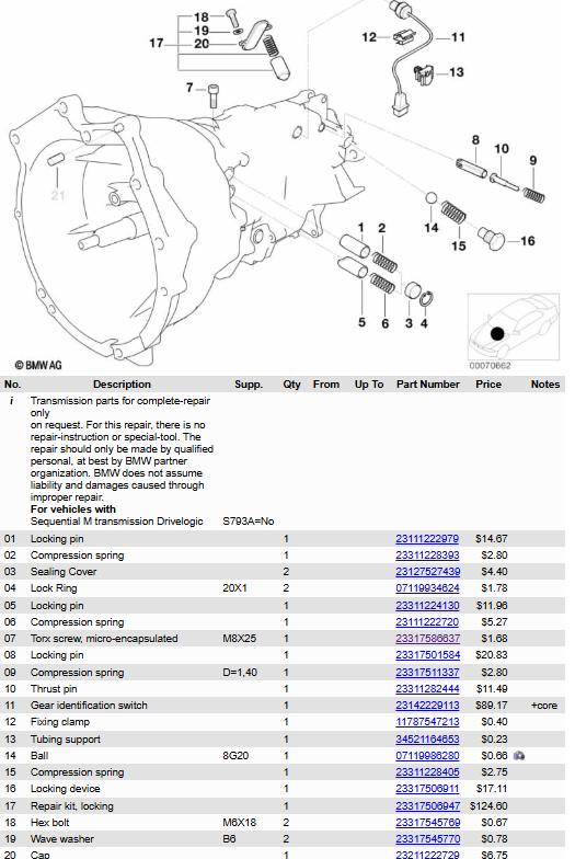

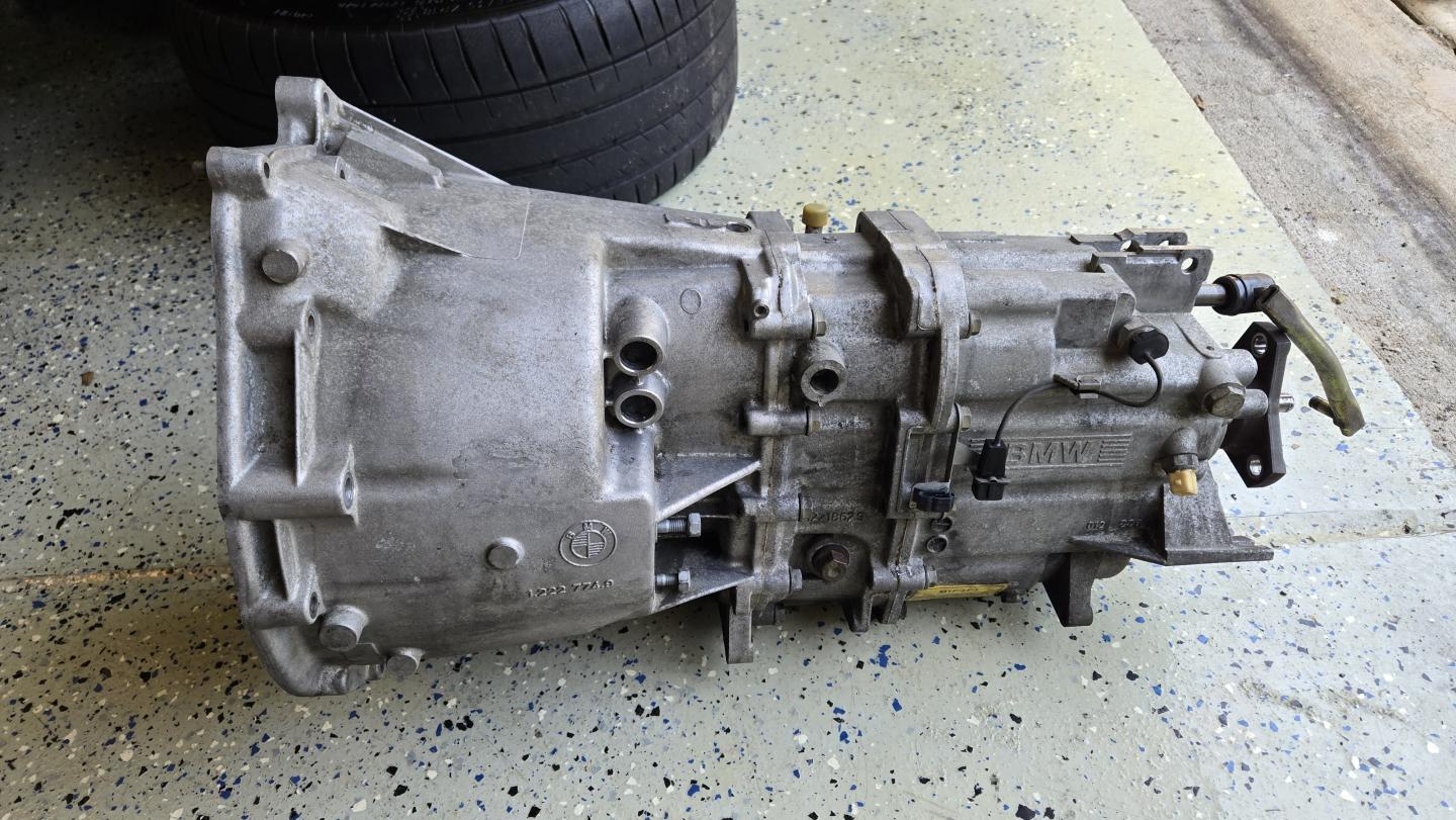

    Green is 9 (the pin pushes against the GPS sensor switch)
    Red is 15
    Click image for larger version  Name:	image.png Views:	0 Size:	333.2 KB ID:	315490​

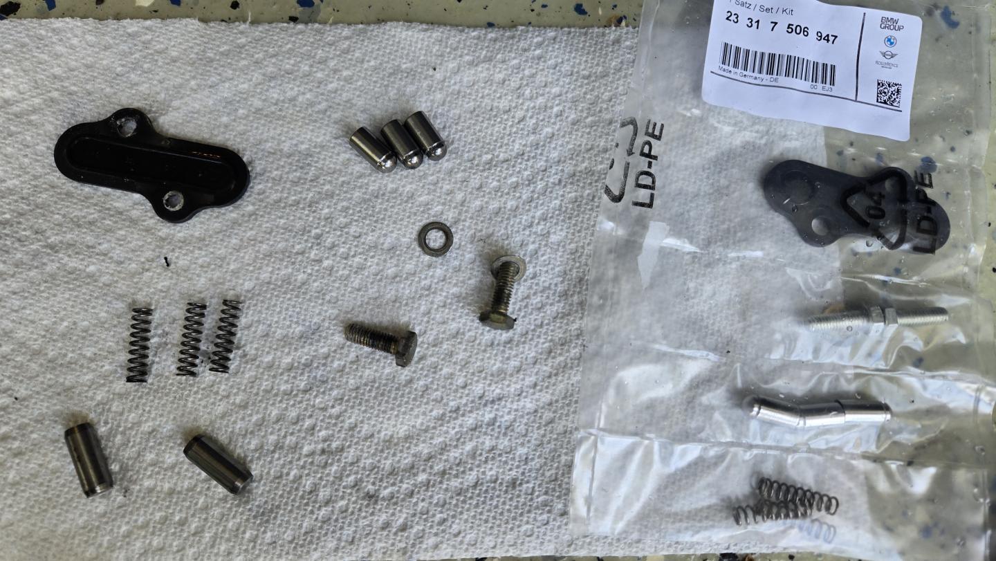

    1. What are the torque values for the fasteners? I.e, the bolts for the #20 cap, the #16 bolt, and the #11 sensor hex. As far as I know there aren't any torque specs.
      • The M6 bolts for number #20, 10nm should be fine.
      • Nut for #6, snug with thread sealant
      • GPS #11, snug with thread sealant
    2. Are any special tools needed to set the depths of the sleeves for #1 and #5? ZF transmissions require special tools, from videos I've watched. If its an original MT bell housing it should have a step that you'll drive the bushing against. Its thin so do not break it off. IMO, if the detent slides in the bore smoothly by hand, leave it.
    3. Any watchouts or things not to do while disassembling and removing the springs? Not that I can think of.
    Thanks for chiming in with insights and advice. Does the sensor switch (in green) pull out or twist out?​

    Originally posted by bimmerfan08 View Post
    George Hill, Casa de Mesa, or anyone else who has replaced detent sleeves and springs.
    I removed the cover for the rear springs and found all springs intact. The sleeves appear to be in great condition. The springs (anecdotally) still feel pretty firm (have good resistance) when compressed. Should these still be replaced for good measure?
    IMO if they are out, they don't go back in.
    I attached a picture of my transmission for reference. I understand two of the detent pins are behind the plastic covers above the slave cylinder location. Referencing the RealOEM diagram below, where are the two springs (9 & 15) that are towards the rear on this side of the transmission? Is it the large hex at the very back of the transmission?
    Edit: Figured out the location thanks to this post: https://nam3forum.com/forums/forum/m...261#post132261
    Red is 15
    A few additional questions:
