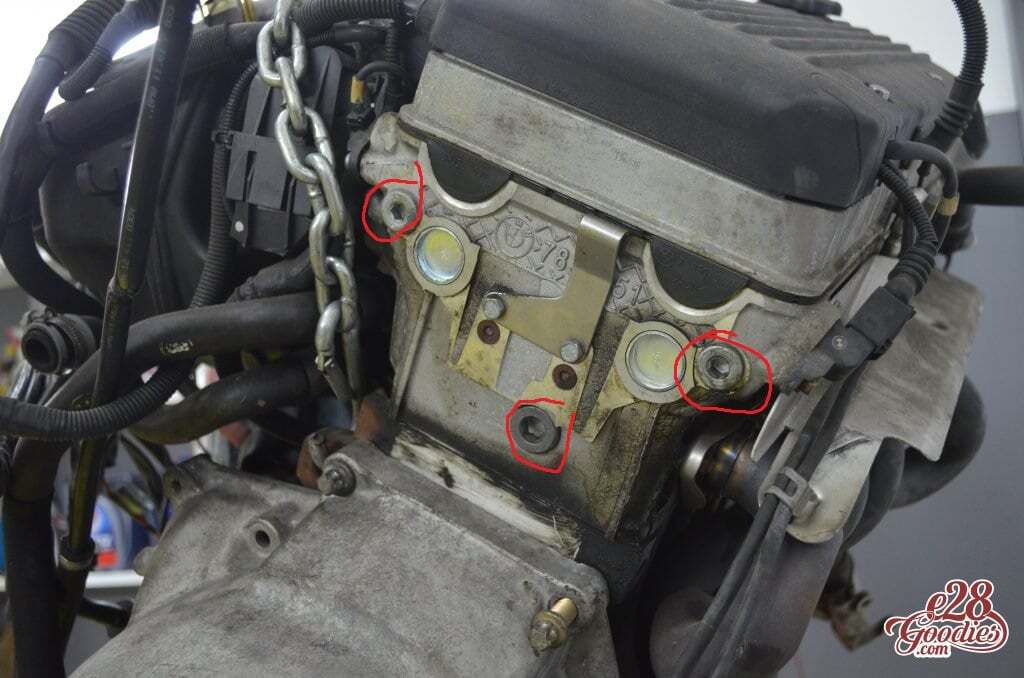

    I am chasing down a small oil leak that I narrowed to the back of the head where both cam sensors are and also a few allen and freeze plugs are located. Anyone familiar with this kind of leak?
    I've already changed out the valve cover gasket and confirmed it's sealing correctly. Also the CPV o-ring was replaced (though the leak is higher than that so I ruled it out anyway). Lastly I am changing the oil filter housing gasket as that's leaking also but on the other side of the motor. I did confirm some oil present using a mirror on the bottom of those allen plugs (red).
    Not my pic, pulled from a recent fb post.

    Thoes plugs highlighted all have orings or washers so it could be leaking from that. What's more likely tho is the valve cover is leaking at the half moon point. You're supposed to use some rtv along there according to bmw.

      From everything I've read about the VCG, it's RTV only at the front where the VANOS and the head meet. I guess I can take the VCG off again and reseat but am trying to figure it out first. Those allen plugs look like they have aluminum crush washers and if they have never been disturbed, I doubt they would just start leaking like if a rubber o-ring was perished.

                  I’m going to replace both cam sensor o-rings and put it back together without touching the VCG and check again. If there is still a leak, I’ll replace the VCG at that time. Not much else to do and I really doubt it’s those Allen plugs or the head caps/freeze plugs (there was an m-coupe thread where one fell out but that’s not my problem after inspecting with a mirror).

                        I replaced the o-ring on the exhaust cam sensor and that seems to have stopped the leak. I’ve only put about 25mi on it but I’m going to an auto-x tomorrow. I replaced the oil housing gasket too...and that was definitely blown. ECS sells a bit on one that I went with for longer life.

                              Does anyone know the hex size for these circled bolts? I have a leak coming from the passenger side one and am having a hard time getting anything back there without dropping it down into the engine. Going at it from underneath doesn't seem any better. Any tips are much appreciated.
