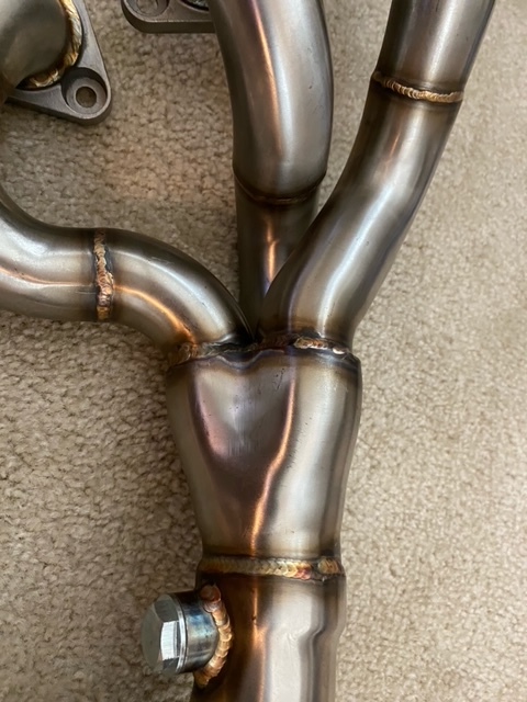

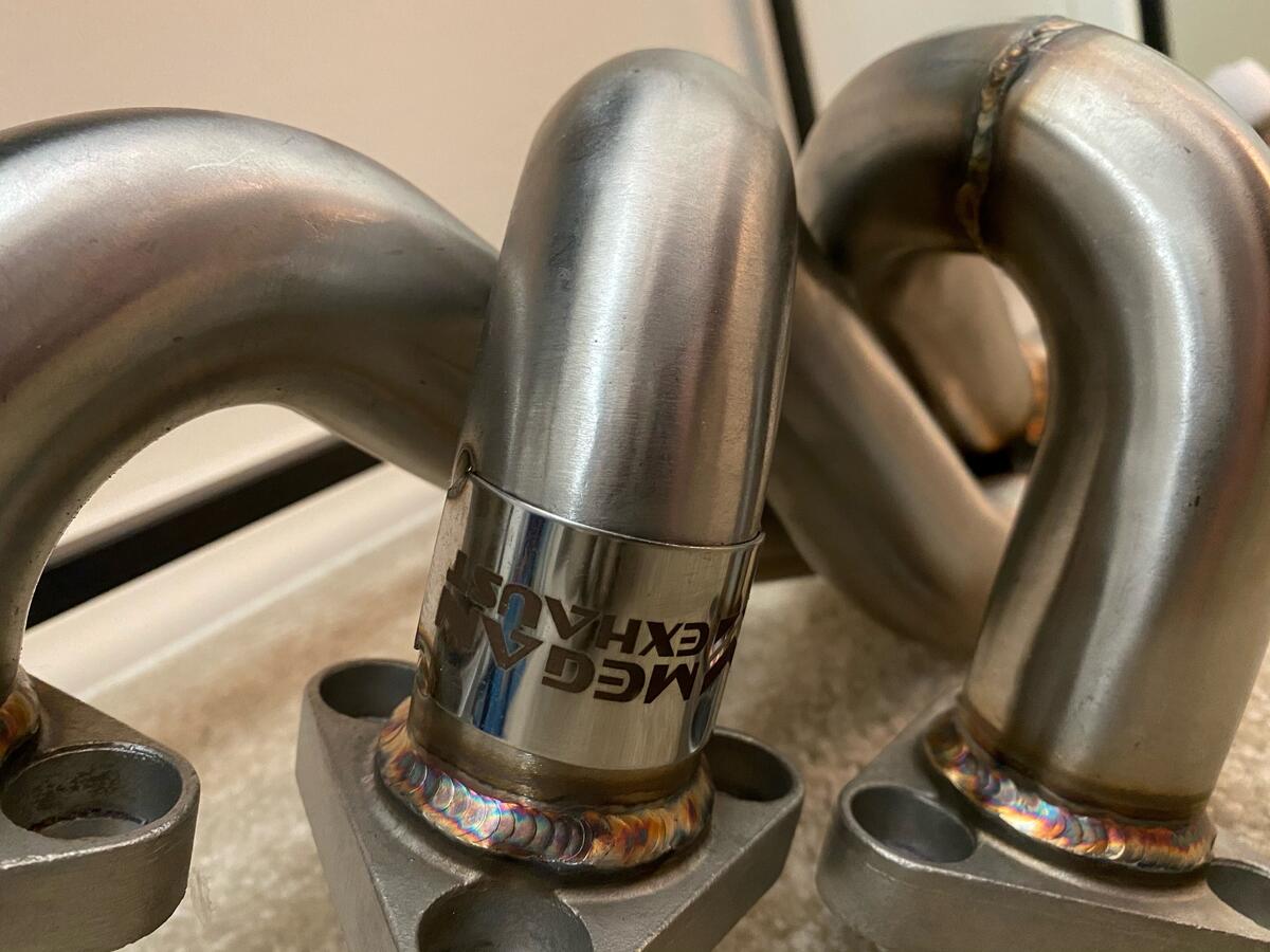

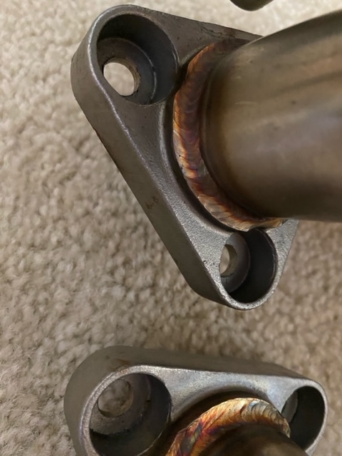

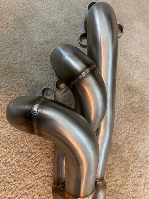

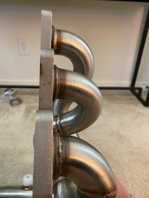

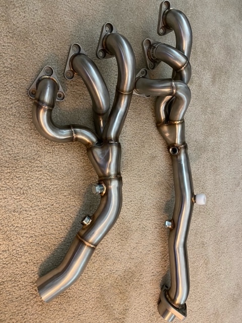

              They're good headers comparable to Euro headers. I'd say whatever you can find cheaper out of the three, Euro, AA, or Megan headers. Ignore the "give me OE or give me death!" comments. My Megan headers are truly 304 stainless with proper bends and perfect fitment. The Megan headers are AA headers if you're wondering. They are literally the same exact thing. Megan and AA tend to have good customer service on simple things. This is the only Megan product I'd vouch for because it isn't really their product. AA did the R&D. There was a thread well over 70 pages on the Megan headers from M3forum. They get a thumbs up on quality control and fitment.

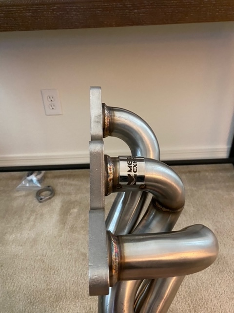

                  Mine will be going on soon. I'm don't know welding or metallurgy but the Megan headers looked good coming out of the box. I went with them knowing full well that SS was the best option but not in my budget as I just did Vanos and rod bearings.
                  Now I'm ready to have some fun
