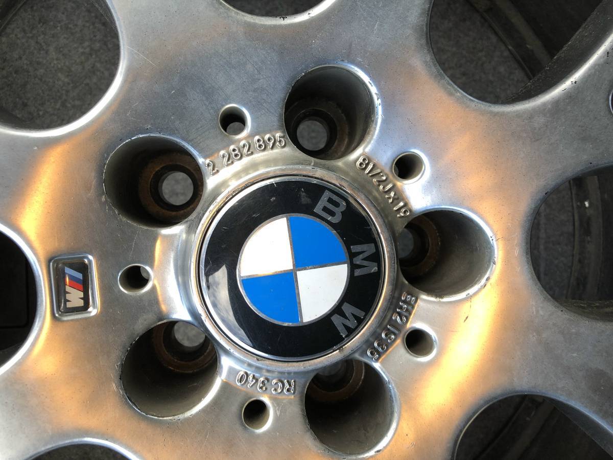

Any idea what wheels these are? 8 1/2J, 2 282 895
    Just a weird mislabeled replica? From what I can tell 2 282 895 is the ZCP part number, but that should only be 8J, not 8 1/2J. Also missing BMW label Click image for larger version

    Looks pretty real, let me check mine real quick.
      Ok, those are probably the first version of Sportlines - very close replica. CS16 I think was the part # / model #.
      There is "BMW" stamped above the M logo, and in your pic, nothing is there. Also, the text on my genuine wheels, is not so pronounced.
      I think the other giveaway would be offset. Genuine is et44 and sportlines are et32, though they might have been et35 for the earlier version of the 19"
