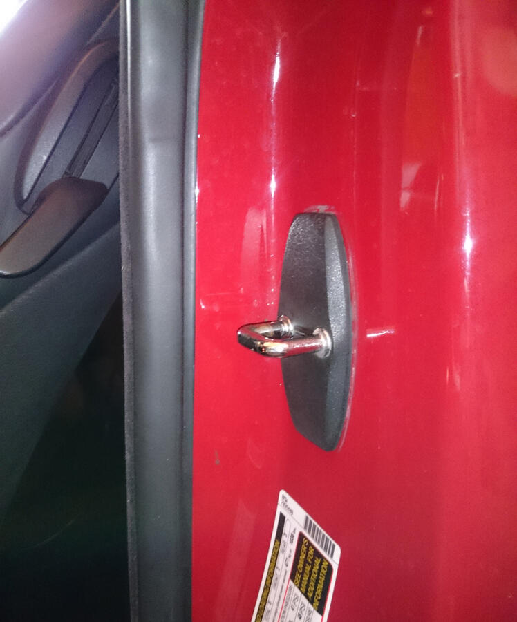

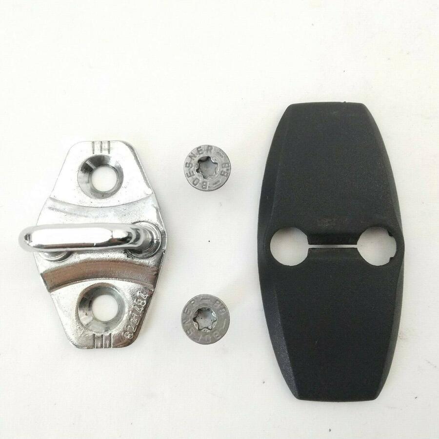

Decided to check the door catch bracket, and sure enough it was pretty worn down where the latch bites down onto it. I popped the black cover off of it to find two T40 torx bolts holding it on. It quickly appeared to me that the piece is reversible...same dimensions top and bottom. I flipped it around so the latch now bites onto the opposite/fresh side of the catch bracket.
Long story short, no more door rattle or wind noise to speak of. A mm or two of play was enough for it to drive me bonkers, and this seems to have cured my issues.
So if you have a rattling/squeaking door or wind noise issue at the front windows...this may be your easy fix.
