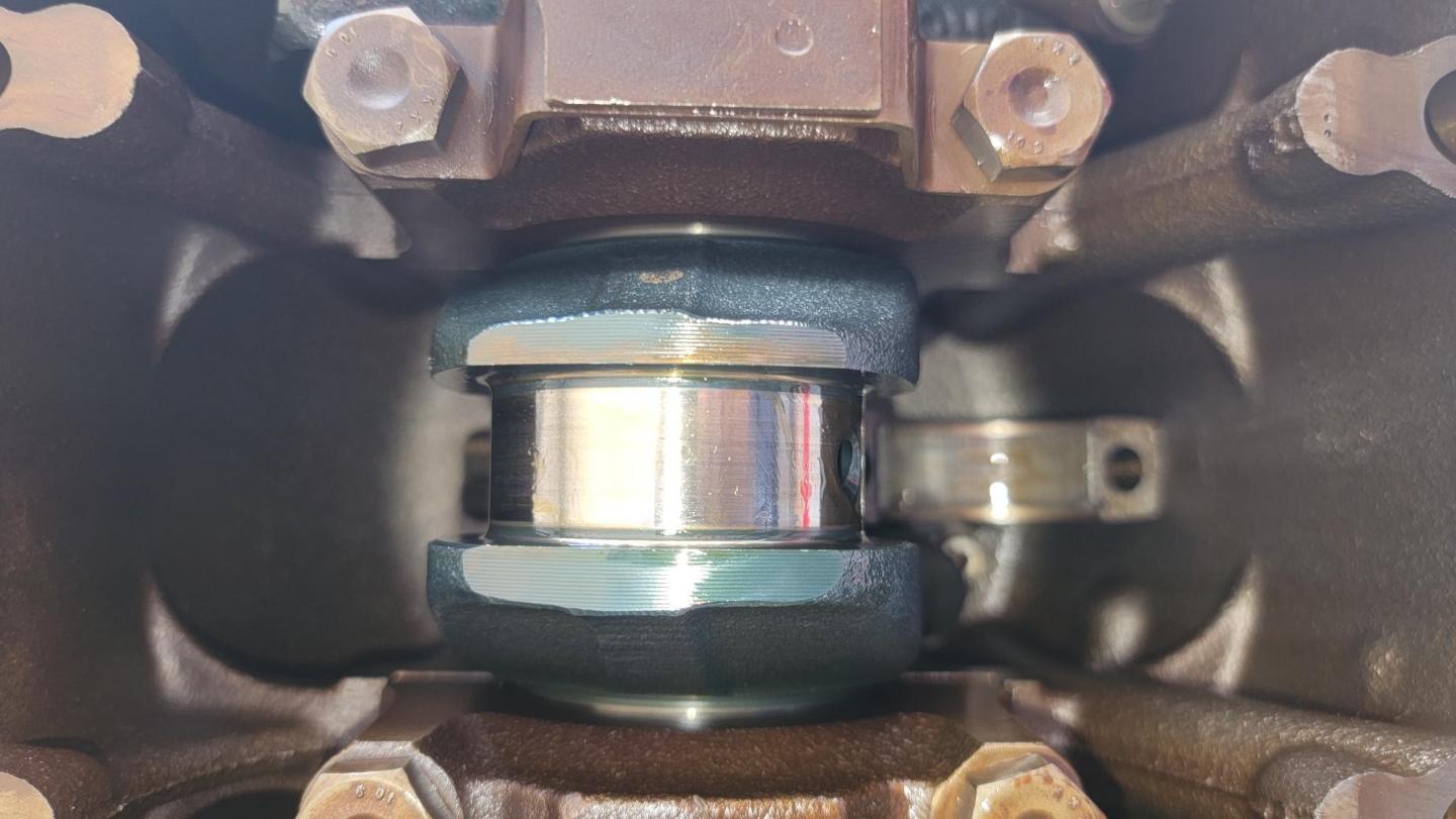

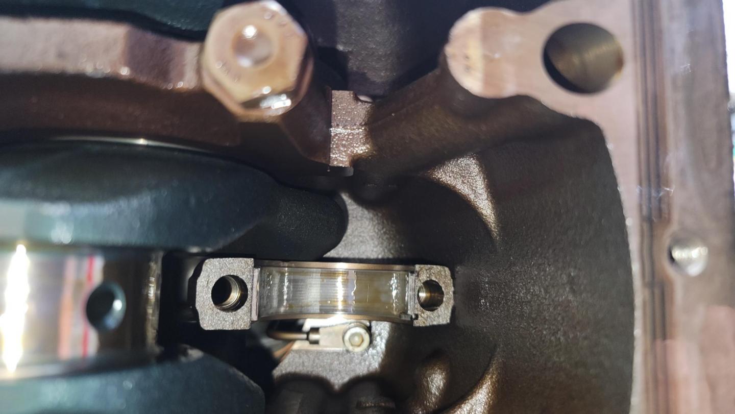

                              Well hello errbody. Finally got to opening this thing up. Pulled motor and started dissasembly (not before sending the bellhouse for machine work, yay ) but look at my photos below. All the bearings look like this and have the same lines going longitudinally around but not worn and no copper showing.
                              Nothing spun, crank not scored. Everything was tight. Thinking Mains.

                                Now more weirdness that I can't put my finger on. Engine was knocking, pulled apart, nothing spun, no copper showing and no direct indication of oil starvation. However, there appeared to be one particle streak in a bearing, did not look critical, no copper. I am suspecting I was sold a bad motor. Mains all looked excellent. So the bad motor theory is sounding more plausible, just my luck.
                                Not planning to hone if everything looks healthy when I pull the pistons. With good luck I'll have it buttoned up in a couple weeks and can finish the 6spd swap and we will be in business.
                                Edited: Marks on crank were from the factory nitriding, shop looked at it and said it was fine. polished, magnafluxed.
