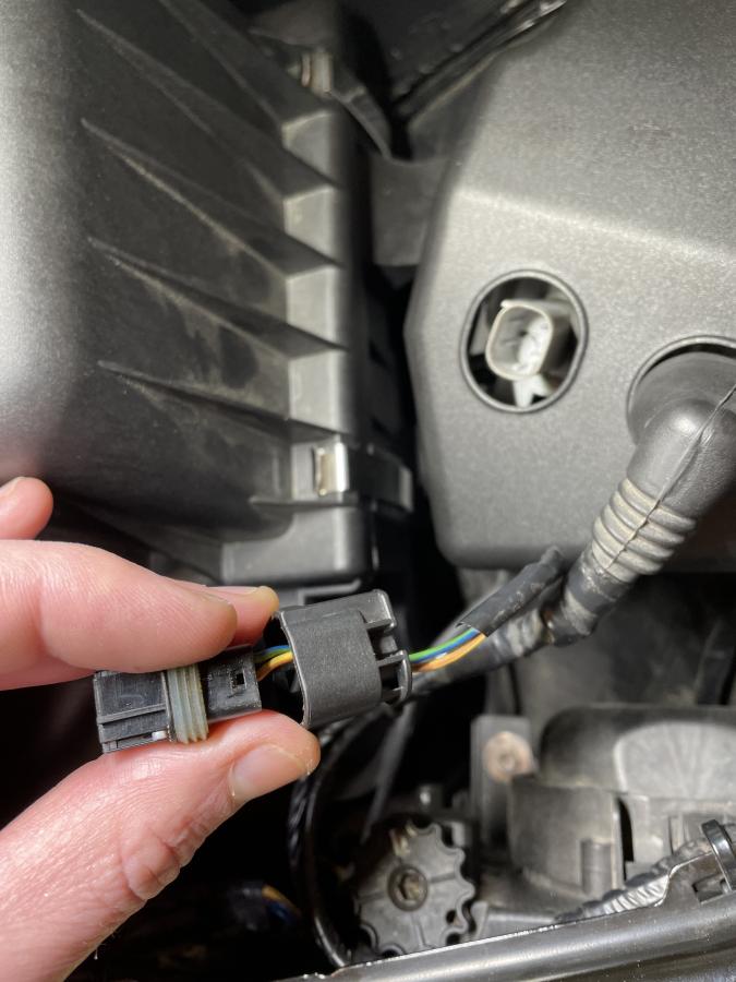

              So, hold up.
              Should PRE LCI cars only come with one boot like my picture above?
              Just some old shitty cars.
                Mine's that way and the car is very original/untouched, so that seems likely. I've seen it before.

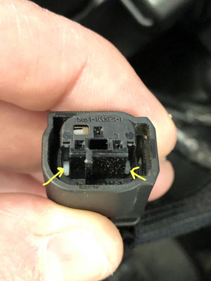

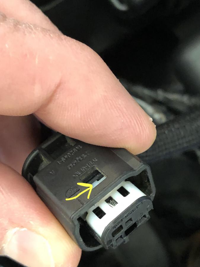

                      Bumping this thread to hopefully see if anyone can provide insight how to properly disassemble the plug in order to remove the wires, to allow for installing 12521711262. I had posted in the "dumb question forum" but maybe best to keep the info here if someone knows. Looks to me there are a few options for where to pry/pick/probe the white piece for removal, unlocking the terminals from the housing for removal. But, I'm not sure, and would like to avoid any damaging mistakes here. Below photos of what I'm thinking:

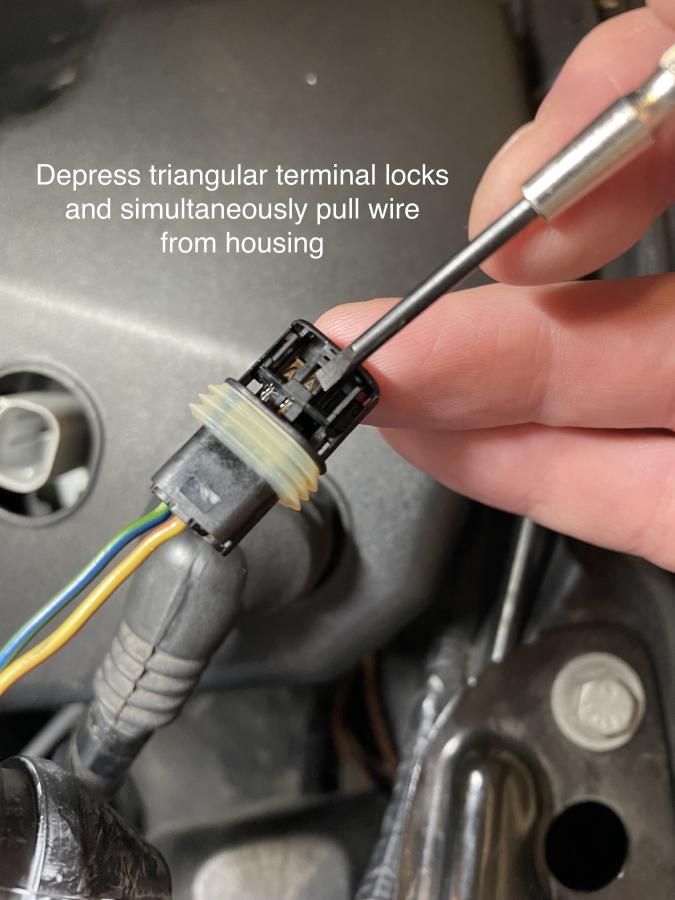

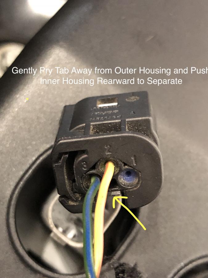

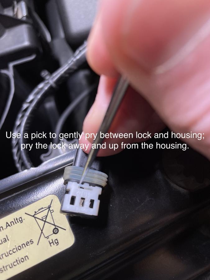

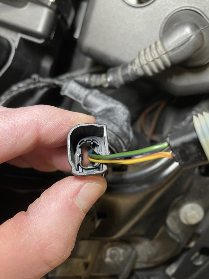

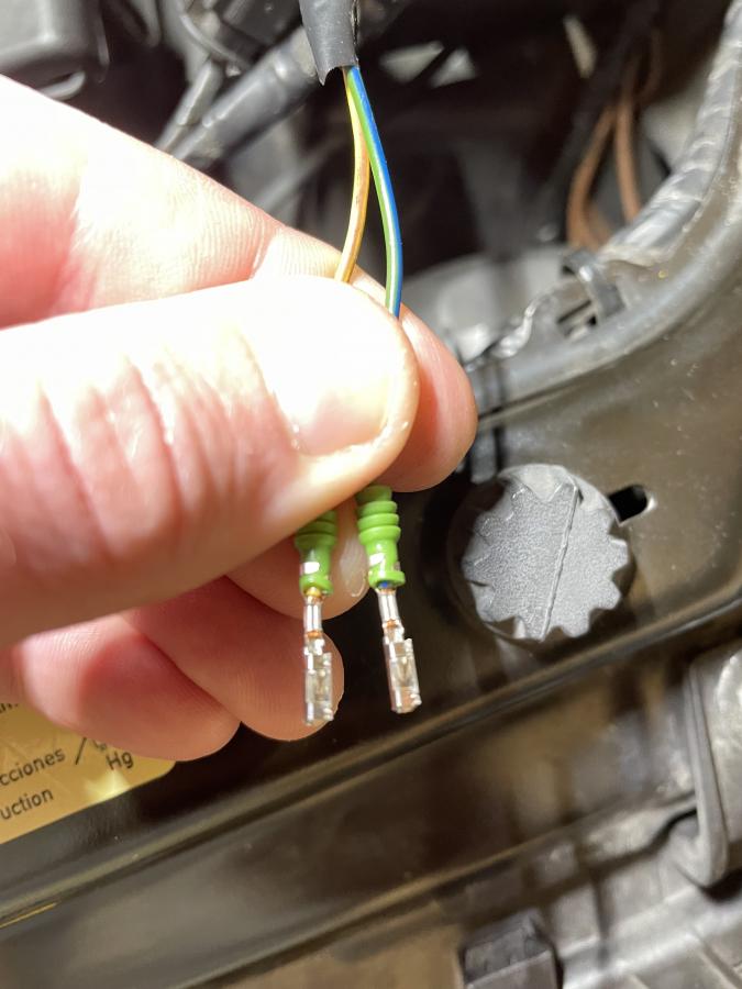

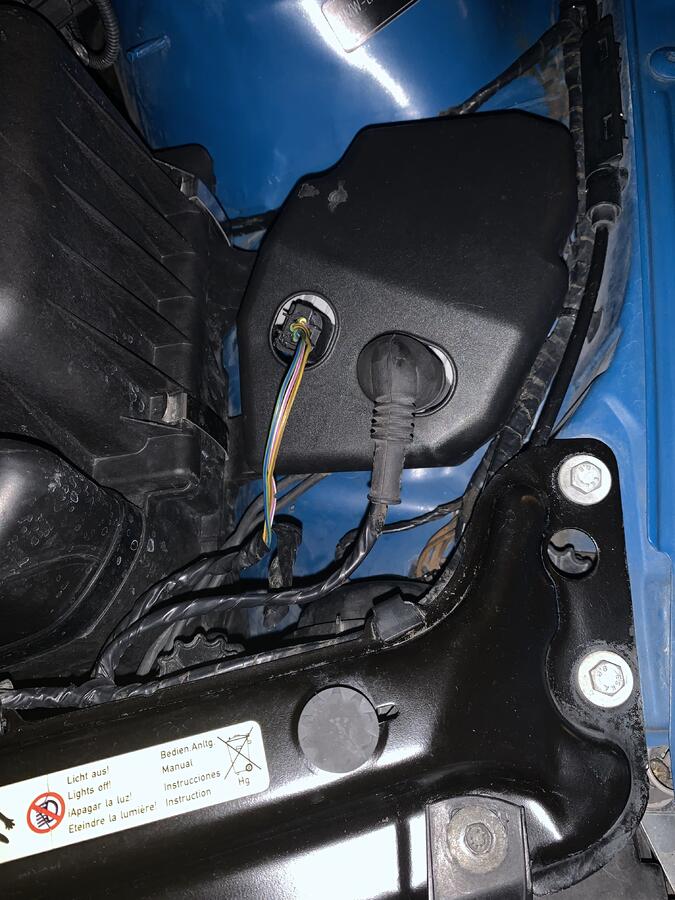

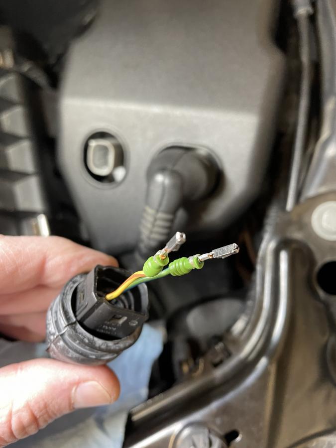

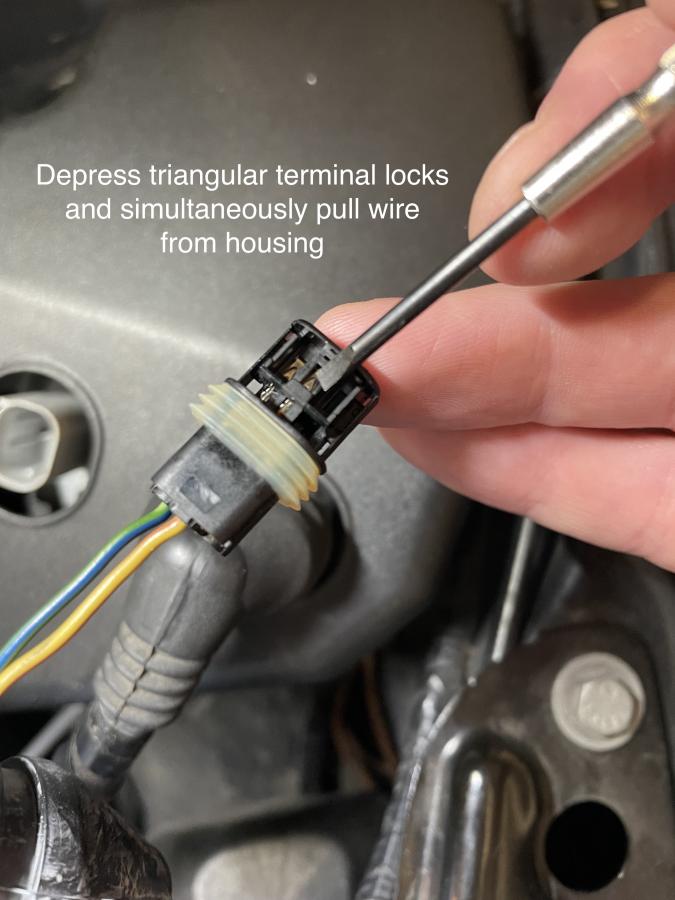

                            Ok, here's what I did:
                            First thing to note is that you are really dealing with 3 primary components of the connector:
                            1: External keyed housing
                            2: White internal housing retaining clip
                            3: Internal housing where the wire terminals lock into
                            You first need to:
                            1: Separate the external housing from the internal housing (lift small tab away from housing and push internal housing to separate)
                            2: Remove white clip with a pick as I show in the photo; be gentle and it will separate.
                            3: Depress terminal locking tabs and pull wire from the internal housing.
                            4: I hit everything, including the control unit receptacle with QD contact cleaner to clean everything up before reassembly.
                            5: Used some detailing APC to clean off the white residue from the new boot, and applied a small piece of electrical tape after installation.
                            As they say, reassembly is reverse of removal. Note correct wire position, and also note that the inner/outer housings can only go together the correct way. And of course, you're dealing with 20yr old wiring and plastic.
