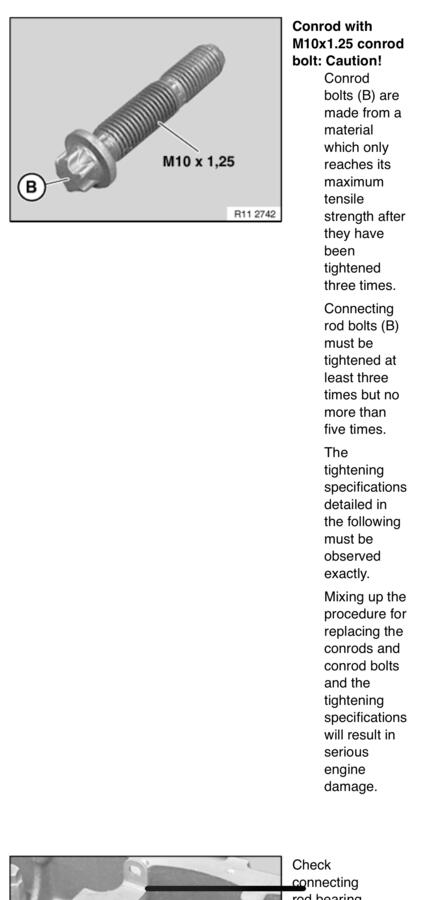

        BMW state the M10 rod bolts must not be reused?
        I've never read anywhere they can be reused albeit not more than 5 times?
        Mine was never opened (to my knowledge), yet I didn't reuse the stock m10 rod bolts. I went with arp rod bolts.
        My post stated that the whole thing regarding arp rod bolts not providing sufficient clamping force may be true, however the clamping force differential would be miniscule, otherwise by now, we would have seen many s54's with arp rod bolts having failed where the failure could be directly and solely attributed to the arp rod bolts and their insufficient clamping force. Many people I know have built s54's with arp rod bolts (installed by torqueing to spec, and not by stretching), and they haven't failed after many thousand km's of hard street and track driving.

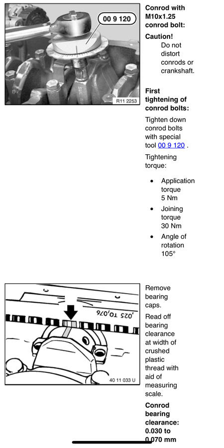

        Sure, don’t reuse the bolts. But during the procedure you can loosen and retight the new bolts.
        Here are 2 screenshots from the official bmw procedure:

          #34
          Yeah I didn't do that. I torqued the arp bolts to spec for my plastigauge checks
