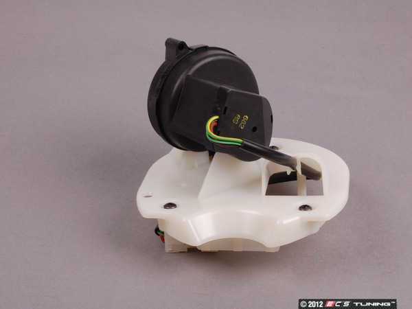

                      Definitely the DME fan.
                      Read the description in the ecs link. You have to get the correct one for your car. Ie: 6mt or smg. Same thing happened with me. I replaced pulleys and belts twice over the past 10 years and I still had the crickets sound.
                        He has the recording outside the car at the front foglight. Having replaced the ECU fan on a couple M3s I worked on this does not sound like it. He also states it’s a cold start issue. The ECU fan would not trigger that long at cold start imho.
