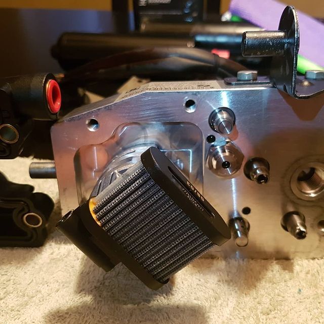

Thanks Ahmed for your reply. Unfortunately I need to remove the supply line for a new one. The red ring on mine is flush with the body of the pump. I can't push it down. I didn't want to pry UP because I saw your post and how the ring cracked. Is there some trick to get it to release the hose? Mine looks like the pic below. Completely flush.
