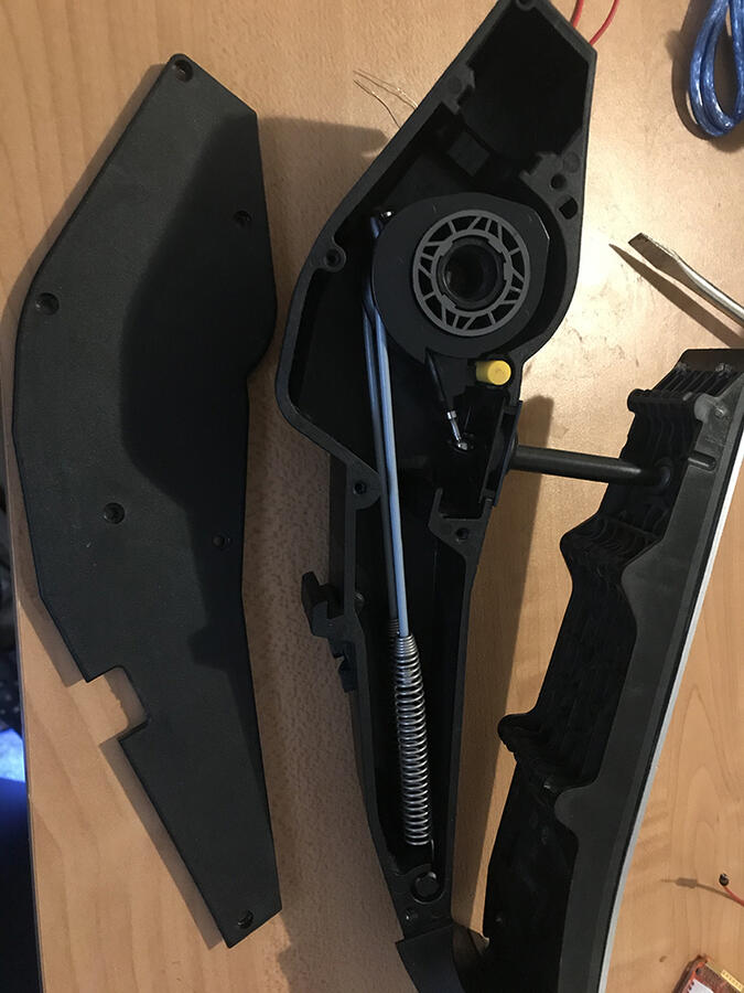

Step 2: Remove the 6 security screws from the side of your gas pedal. You should be greeted with the below
Step 3: Unclip the spring from the bottom, and then lift the spring/pulley assembly out of the housing

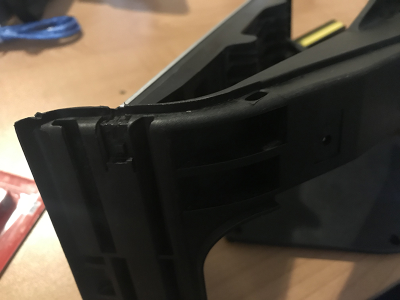

Step 4: At the base of the pedal, pull back on the tab here, and slide the pedal out (note: Be careful, as you can see I broke my tab)
If you do break the tab like I did, it's not the end of the world. There's enough friction holding the pedal in place that it'll never be a real issue.

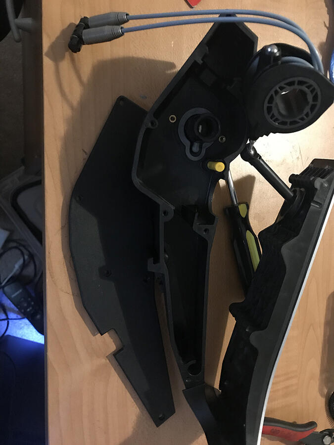

Optional Step 5 (not pictured): Remove the potentiometer from the side of the throttle housing using the same security torx bit
Grab your new pedal out of your kit, and disassemble it to the same state. I didn't take pictures because it's virtually identical to the E46 pedal.
Assembly is reverse of disassembly: Slide the base of the pedal into the housing, put the pulley/spring assembly back in the housing, close it up, install the sensor from the new pedal if you want.

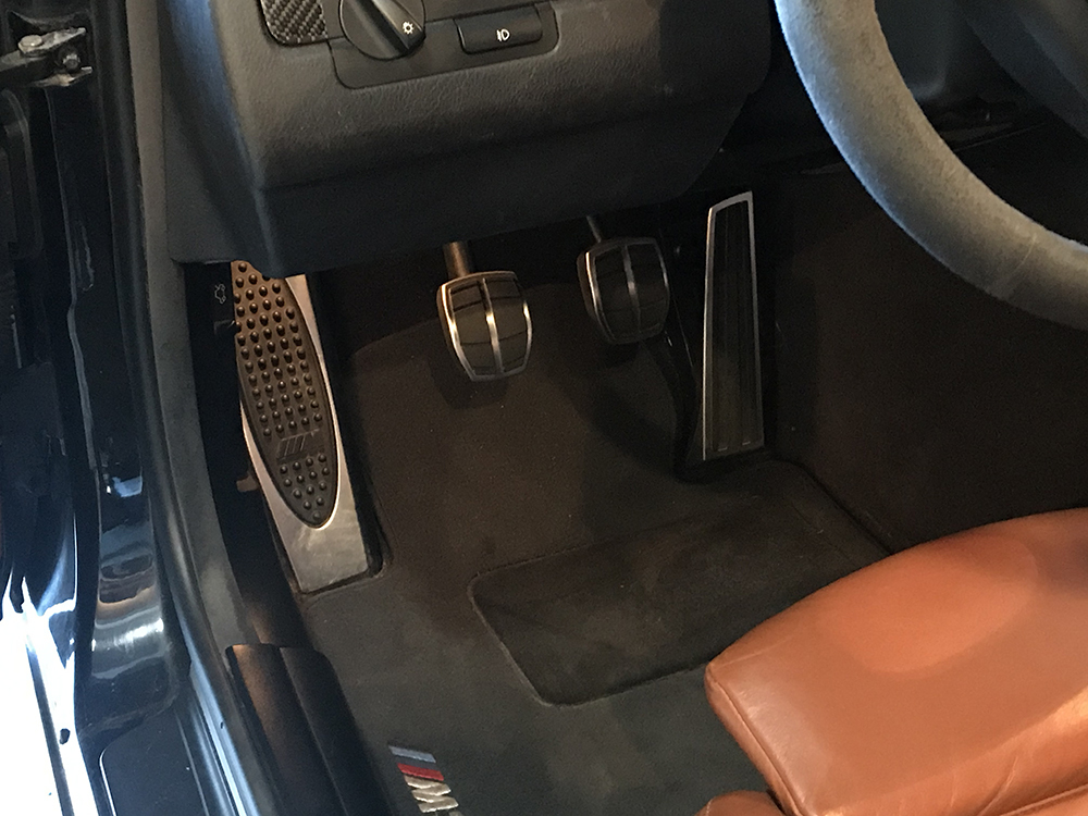

Final result:
I like the subtle look, and I think it goes well with the factory M dead pedal. All in all fairly reasonably priced kit (around $120) considering that you basically get a new gas pedal out of it.

Final result:
