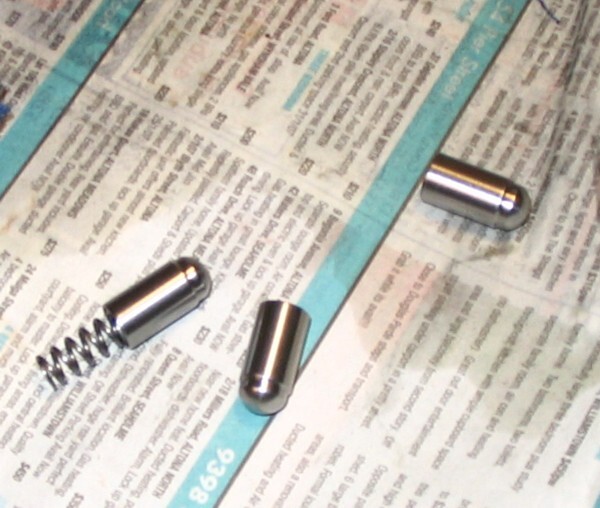

I have to disagree, there’s no visible sleeve. The sleeve design has a lip that would be easily visible from the top hole. The pin that I pulled out is also consistent in shape with the original kit. The kit with the updated sleeve and pin, has a different shape.Originally posted by sapote View PostPic shows it is the updated sleeve and no more ball. either keep them or replace with new sleeves.

I understand now. We're talking about a different kind of sleeves, not the thin cylinders (sleeves) that are pressed into the holes to work as the bearing surface.Originally posted by Chanman1029 View PostI have to disagree, there’s no visible sleeve. The sleeve design has a lip that would be easily visible from the top hole.

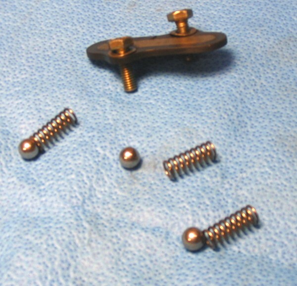

The original design used ball and spring:
The ball would beat up the hole as the shift rod moved fore/aft, to the point that the ball can jam in the hole and more difficult to shift. The updated long sleeve provides larger bearing surface when sliding up/down in the hole and causes less wear in the hole, a better design.
The new updated with sleeve with round end (or pin if you like, but everyone calls it a sleeve):

So then maybe I should just buy the kit that has the identical parts in it. My pins dont really look worn, but I guess it cant hurt to change them, along with the compression springsOriginally posted by sapote View Post
