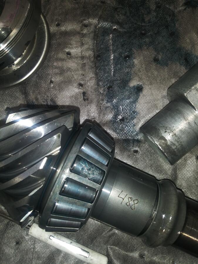

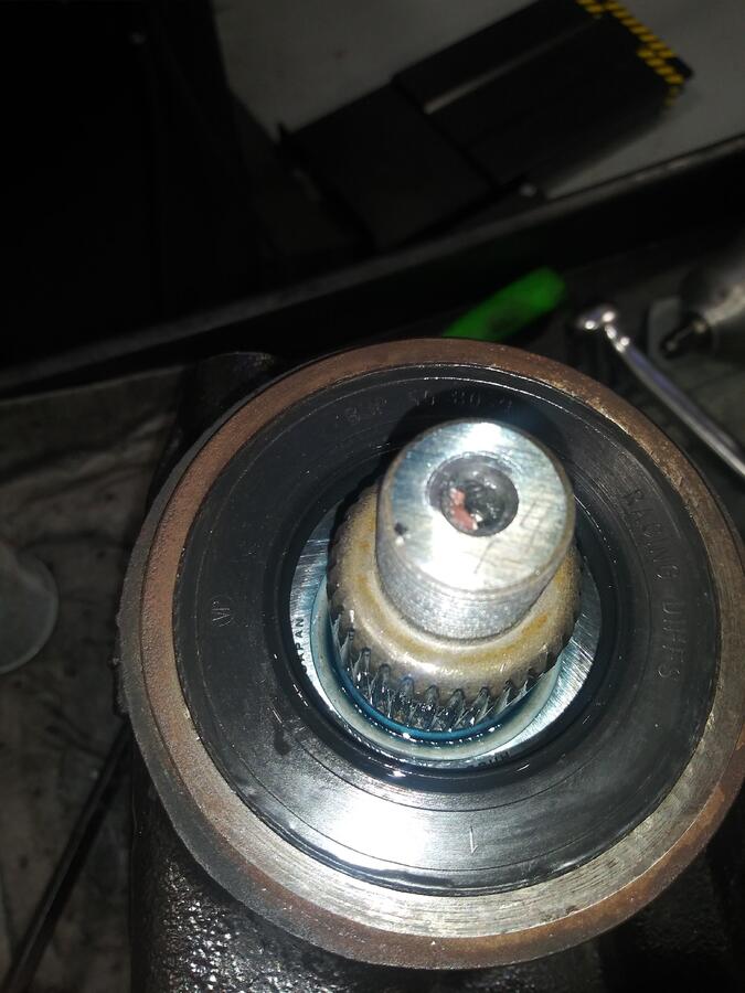

      I appreciate the help. I really didn't think it should have any. This is my second full rebuild and my other was some truck diff in school. Before I took it out, it was a hotdog in a hallway. It makes me think someone was pooping around in there prior to me buying the car. These aren't Timken so I think I'll stick to that spec. Now I can actually finish this turd. I'll share anymore grievances. I'll show how I has to cut the races off.
      I also found that this bearing requires a ridiculous amount of pressure to seat. I was at 10 tons before it dropped. All others were under 1000lbs. It looked seated however, it had .035" to go.
              Is this the inner bearing which locked the pinion depth shim? The first pic shows the bearing was badly pitted, and if a new bearing is used then the pinion depth needs to be checked: using gear marking compound to set the correct pattern and adjust the shim if needed. If the bearing was heated to 100C and install on a cold pinion shaft then it should be less force needed to press it in.

                If you are using the correct nut plate that prevents the pinion from loosening, I am fairly certain that one of the bearings or races wasn't pressed in all the way.
