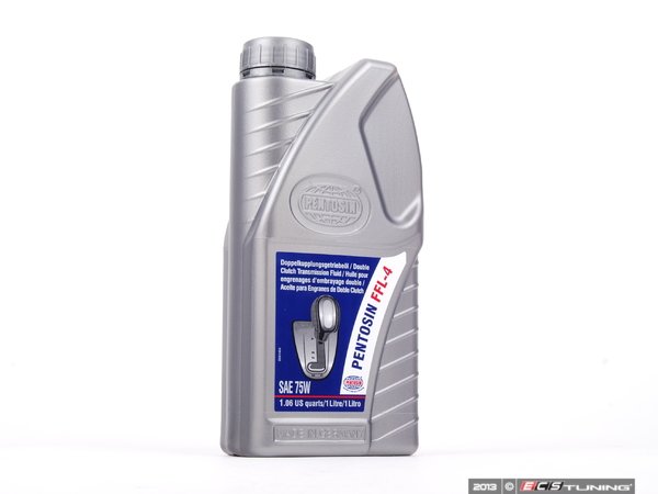

                            Yeah I'm not worried about the fitment guide, I've seen a few instances where FCP Euro and other vendors have it slightly off.
                            There are many other sources that cross-reference FFL-4 to the e46 m3 manual trans. FFL-4 was designed for newer trans but is backwards compatible and seems a near identical formulation to MTF-LT-2.
                            For peace of mind:
